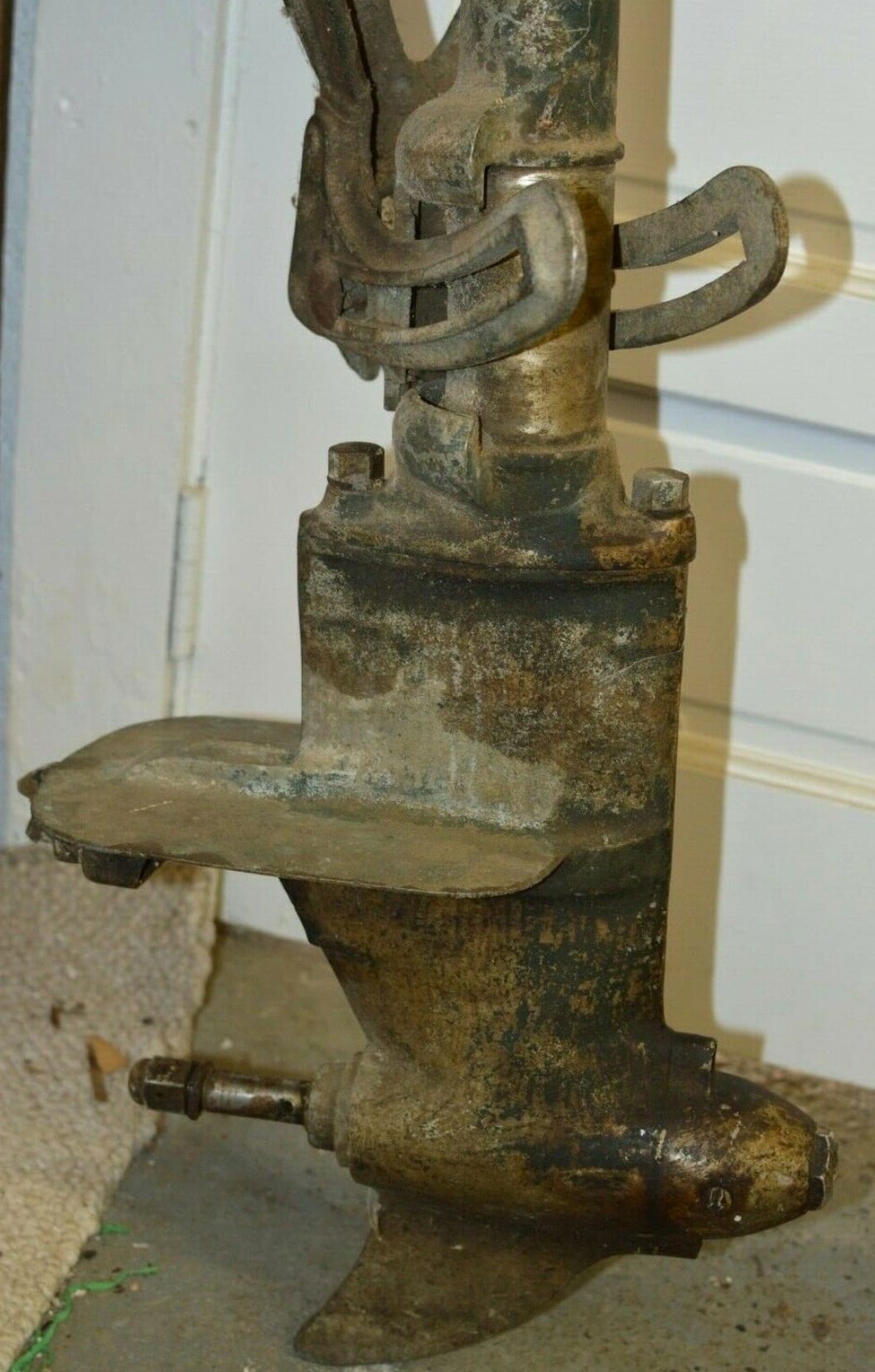

      I am sorting out my P 35 and wondered if anyone has any experience in replacing/reaming the bushings in the lower unit. Also the thrust bearing on mine was rusted, I cleaned it but it’s still very pitted… thanks. Marc H, Atlanta ga
      Oh a prop would help.

        I have a P35 that I finished last summer. It’s a great, strong runner.
        I made a tool to push the old bushings out and installed a decent set I had from a cosmetically challenged lower unit.
        I’ll take a look and see if I have a good thrust bearing for that LU. I don’t think I have a prop but I’ll look for that too.
