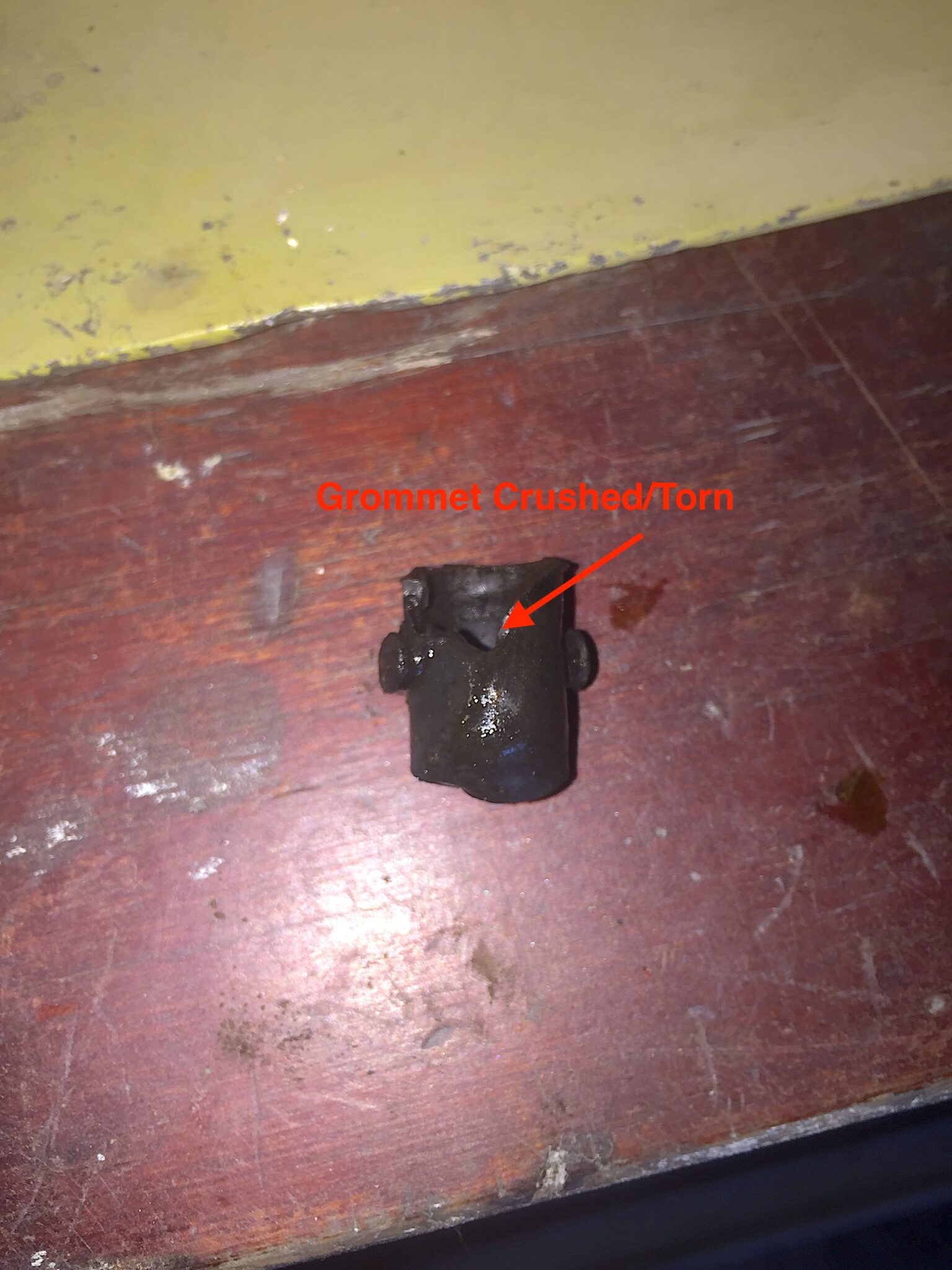

            One more thing I just found on my FD-12 restoration – when I pulled the lower unit I found the last person in there before me didn’t get the water pump grommet and water tube aligned correctly when they installed the lower unit.   The water tube grommet was mashed down on one side and that will prevent the proper flow of water.   See attached pics.

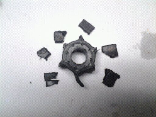

                  If the impeller was changed but no water is coming out of the thermostat location, that indicates a blockage somewhere between the pump and the upper powerhead.  Quite possibly the old impeller was broken and not all of the pieces were accounted for  when it was replaced.  A piece of impeller vane can be lodged in the copper tube leading to the powerhead or could be caught under the block or in the passages under the exhaust cover.  Either way, the powerhead should come off  to find the blockage.Broken-Impeller-Vanes
