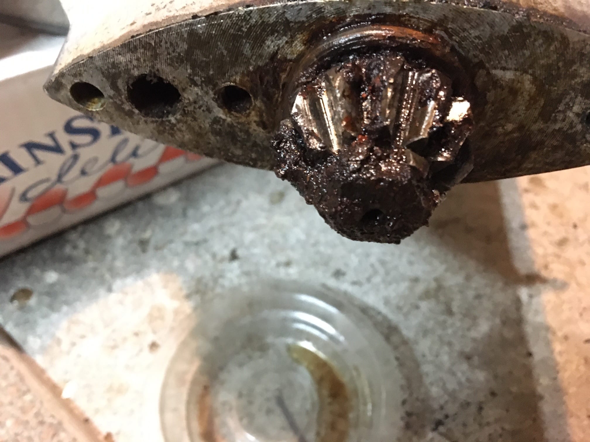

      Good call on the lower unit. It cam off really easy and the prop won’t turn. There is absolutely no grease, oil or any petroleum based residue inside the gear housing. I’ve sprayed some Deep Creep in there and wonder if filling it with brake fluid or ATF would help. Nice deep reservoir to work with there. Should I be tapping on the prop with a rubber mallet? Too cold up here in Ontario for 50:1. See Photo 8433.

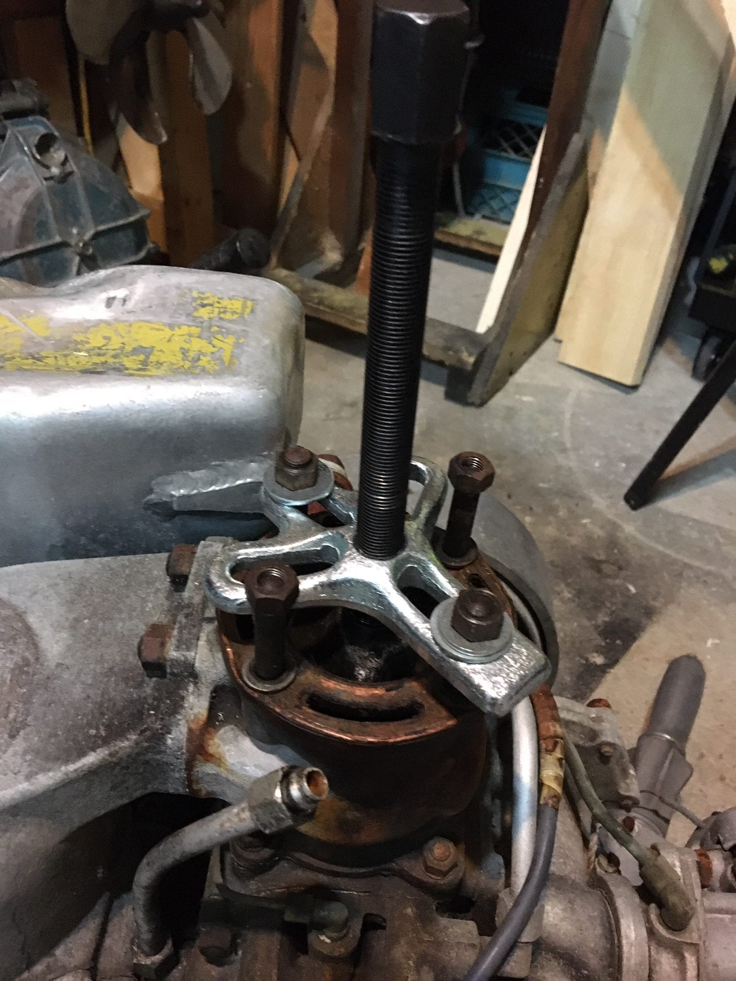

      Harmonic Balancer Idea for Unseizing a piston – got a harmonic balancer to fit on two of the S45 head bolts – wonder what you think about that as an alternative to tapping the cylinder head. See photo 8431

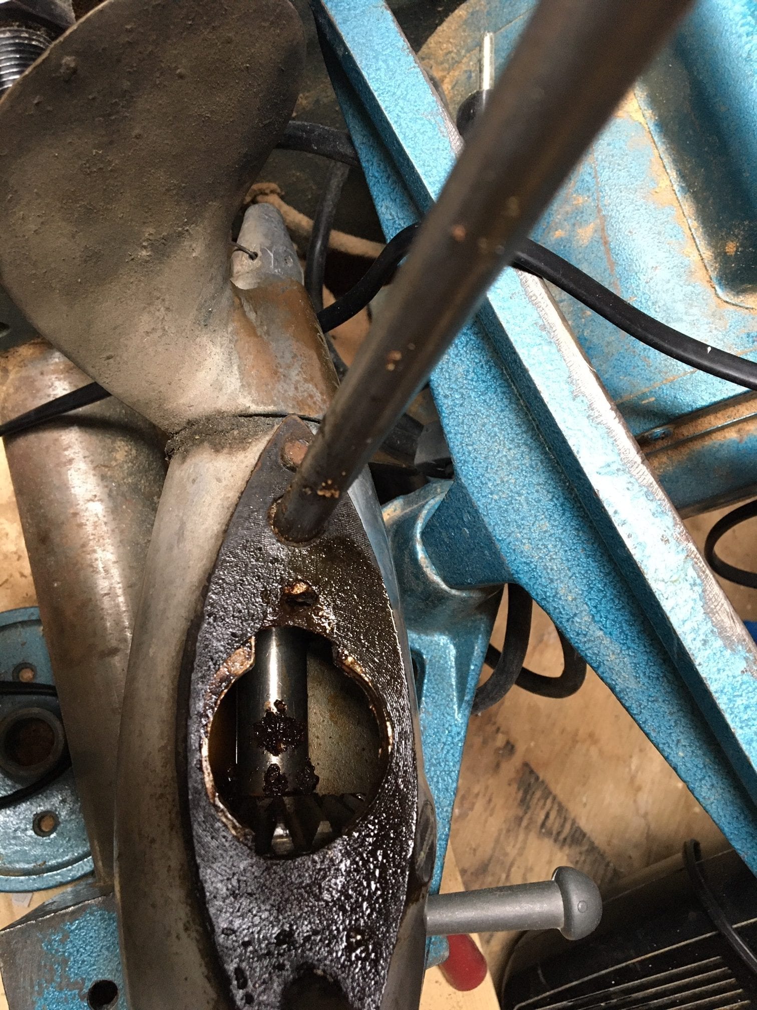

      Drive shaft looks seized to the midsection. Sprayed it with penetrating oil too. Just let it sit for a while or immerse in a bath of ….?

      S45 - Harmonic Balancer used to help unseize piston (maybe)
      S45 Gear - Rusty and likely seized too
      S45 Lower unit top view - nice and clean in there

              I thought about removing the flywheel and mag plate but can’t find a match for the flywheel puller bolts. Maybe 5/16 – 24 UNF threads? The 5/15-18 UNC threads almost work. Getting some penetrating oil onto the top of the upper crank bearing might help.

                If you have the original flywheel nut and domed ID plate held on by three large screws,you have the flywheel puller.Make sure the screws are tightened and loosen the nut until flywheel pops off.Just use strap wrench and box end wrench to avoid damage.How far down in the cylinder are the pistons?
