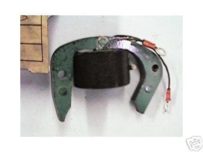

      Can anyone give me some direction on what replacement coils to use for a Johnson TD 20.. any hep would be appreciated
      #177632
        Are you sure you need to replace them? Those coils are almost bulletproof. 375189 Listed as NLA but there should be lots of used ones out there.
