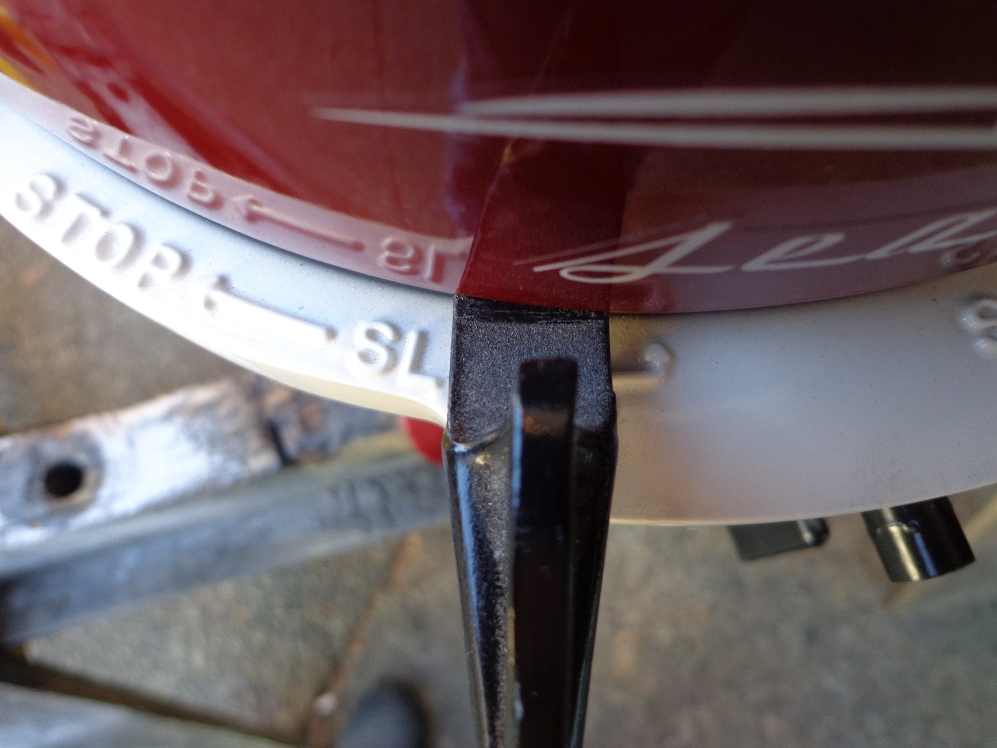

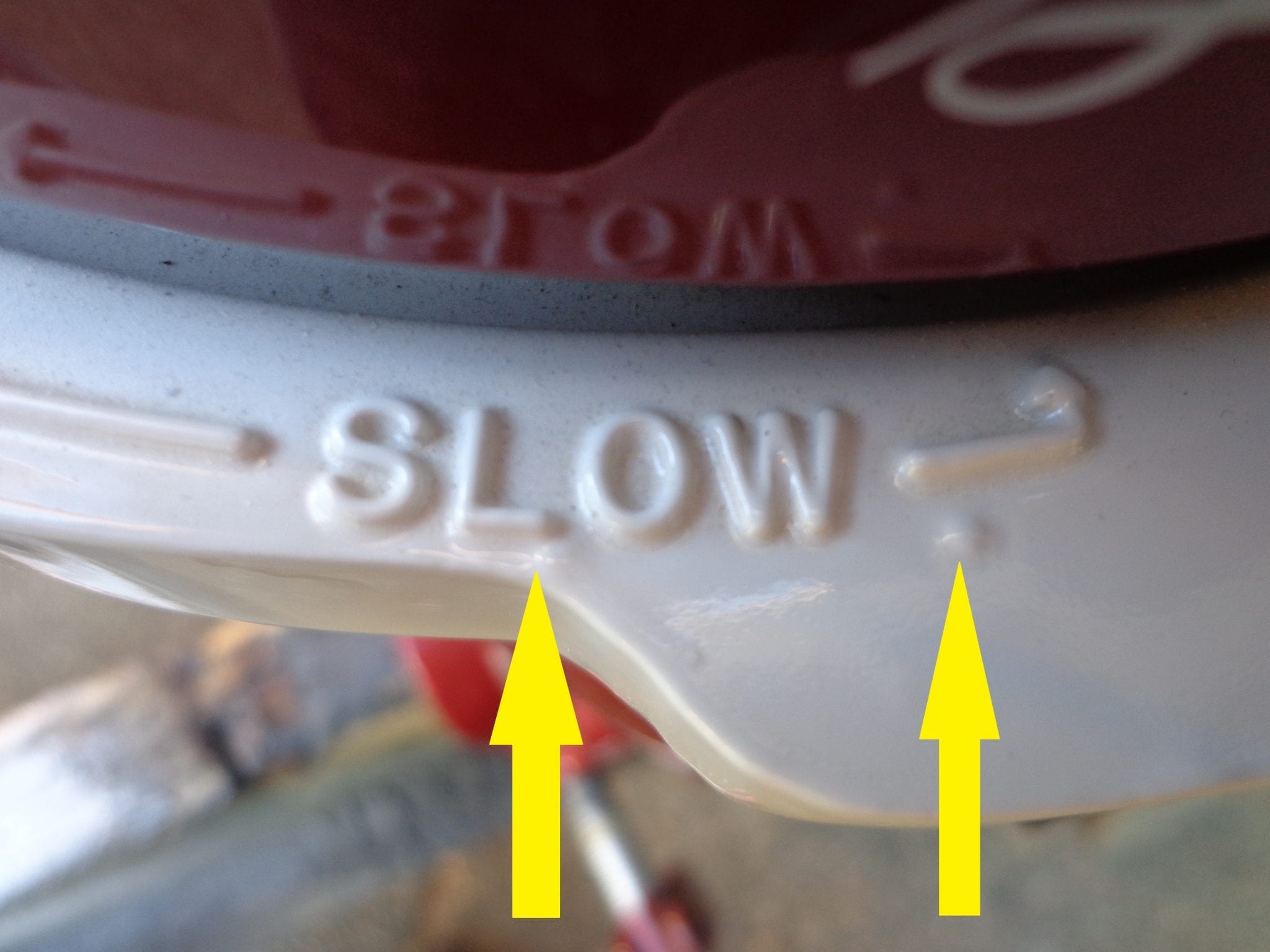

          #209674
            The Johnson JW’s are synced with the speed control lever between the two dots on the gas tank ring. The Evinrude Lightwins are done by viewing from the bottom.

              Thanks! Great photos!
