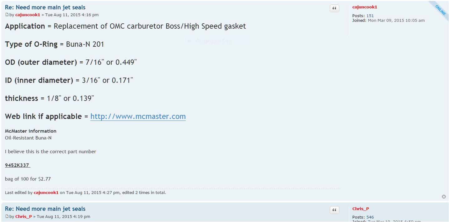

                    This was posted a few years ago about replacement O rings for the nozzle gasket.
                    Main-Jet-O-rings-AOMCI
