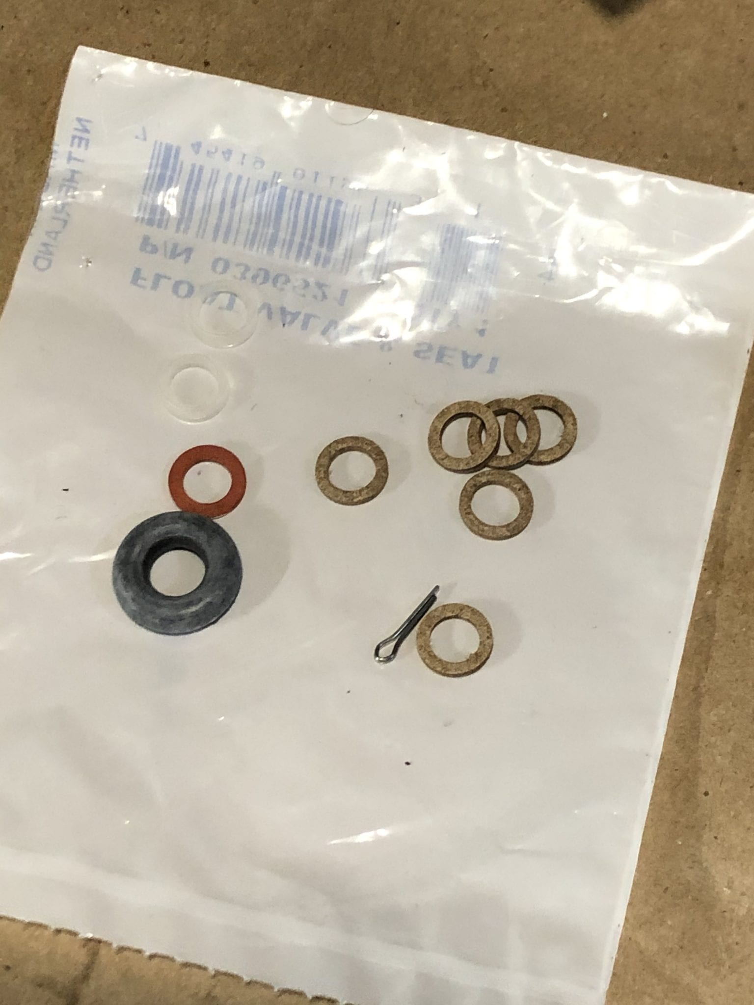

      Wondering if this is supposed to be the “ boss gasket “ seems like the bowl won’t fit on tight enough with it in there

        That’s the one. The bowl will actually stand off the carb a bit when putting it together but tightening the bowl screws evenly will crush it down.
        #226637

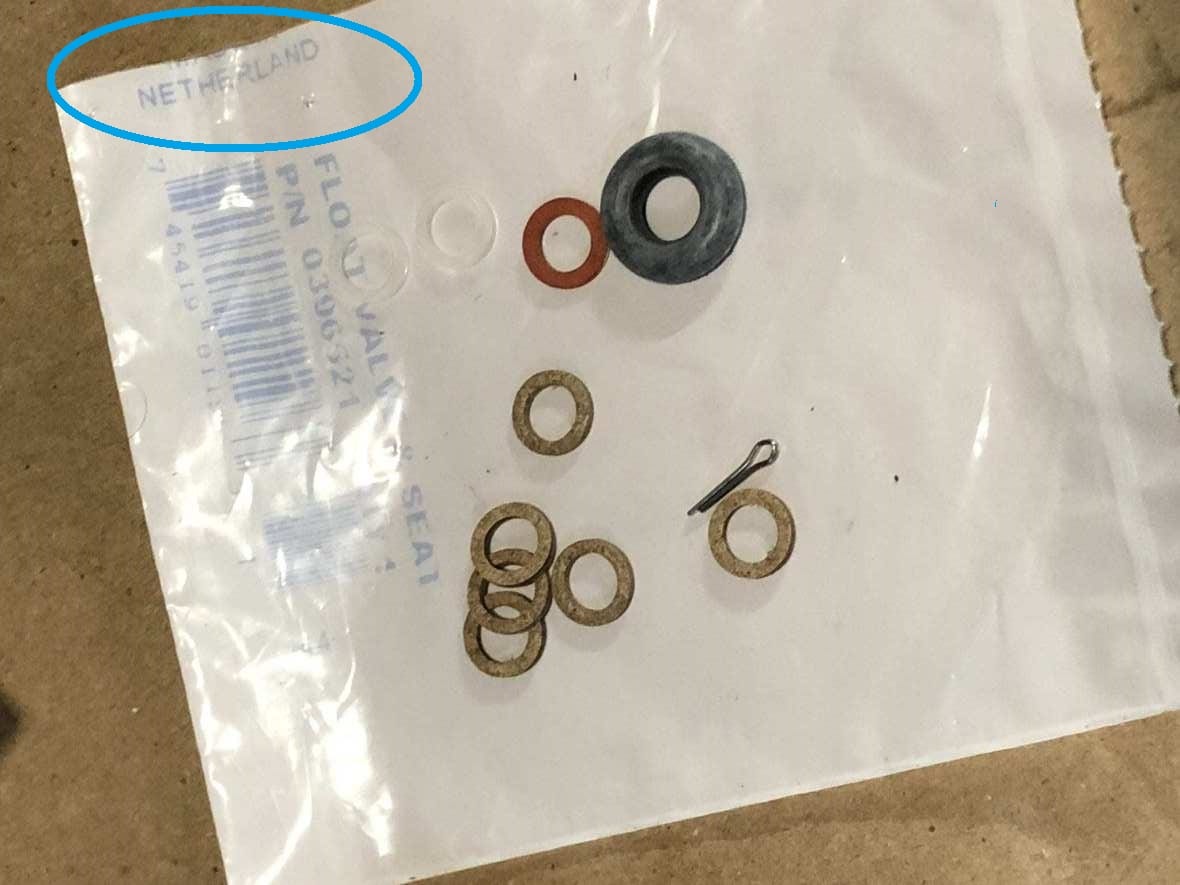

          chineese carb kit ?? …with the funny cotter pin ?? carefull with the carb body gasket (orange?) …they hae a reputation of melting away and clogging the carb.
          #226641
            That’s an OMC/BRP kit.
            Carb-Kit
            #226663
              good eye… if OEM great Netherlands did not open up any lights for me
              keep in mind they print whatever you want of their products
              my son brought back a $1000 + “Canada Goose” winter parka from China…. “made in Canada” for $80 🙁

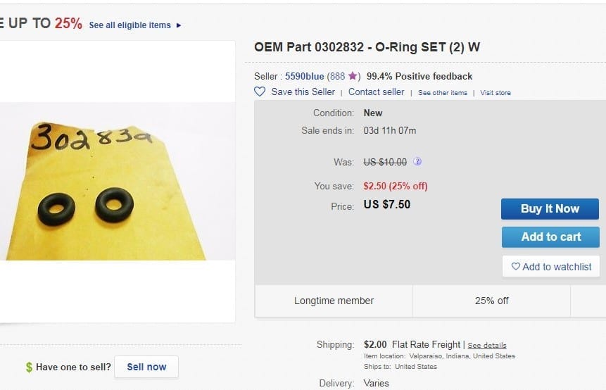

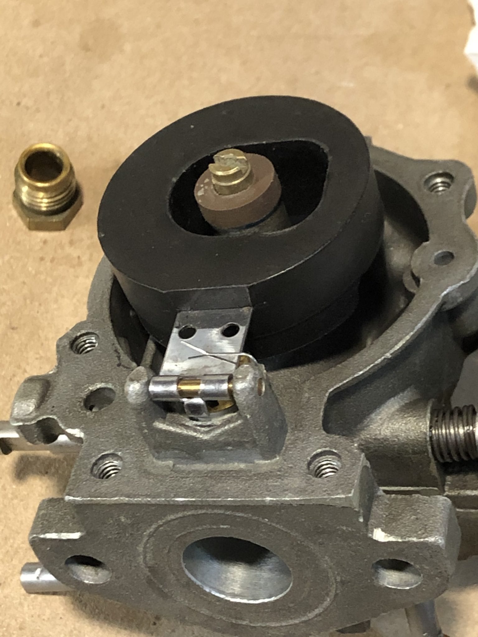

                  How is the rubber O-ring in this kit use in a carburetor? Does it have some other function as well in this outboard?
                  #226784
                    not used on the carb….at least I never used it
                    #226786
                      This question has been asked here and on Facebook multiple times but no one seems to have an answer for it. All I know is I have a bunch of them saved up just in case anyone does figure out what they are for.

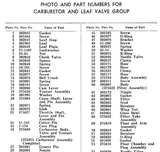

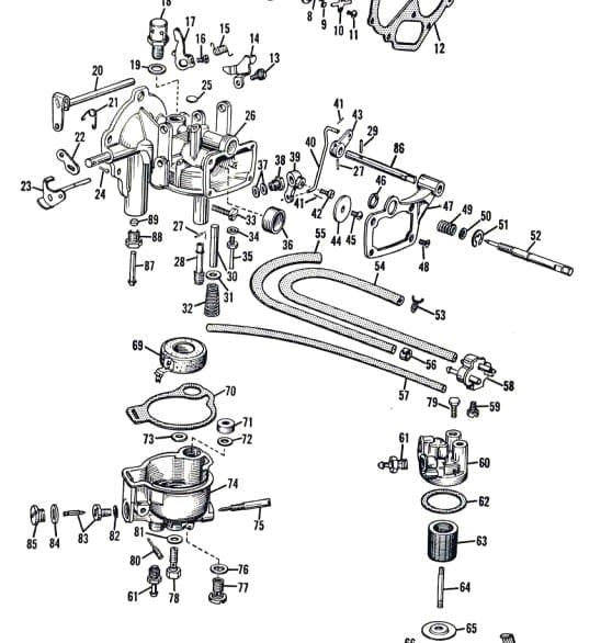

                        My guess is 1953 Johnson QD-14 10 HP. I don’t have a carb on hand to check it but I believe there is a fat o-ring like that in the carb. I know the rest of the kit doesn’t apply to that year (except for maybe a hard fiber gasket and a couple packing), but in the parts manual it shows #72 – part #302832 that fits in a recess under a retainer. When I searched 302832 it looks like the same fat o-ring in the carb kit. Maybe someone who’s got a QD-14 carb could verify that.
                        https://www.aomci.org/forums/topic/rubber-doughnut/
                        1953-Johnson-10-HP-carb
                        1953-Johnson-10-HP-carb-part-72
                        1953-Johnson-10-HP-carb-part-302832
