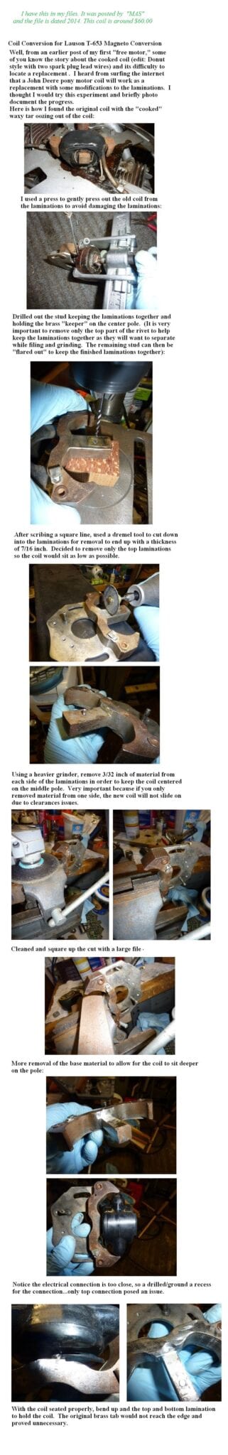

      Thanks Joe, I believe I still have the JD pony motor coil from my failed
      Neptune transplant, so I may be looking for it when I work on my Lauson twin.

        Not sure if this file will work, but Tubs clipped it from my original post that was lost years ago when we switched servers…
        Mas
        LausonPonyCoilConversion

            Thanks Mas and Tubs. Not sure why I could not get the JD Pony motor coil
            or the B&S coil to work out on my Neptune with the Eisemann coil, but
            glad to know there’s hope for the Lauson!
