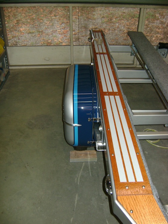

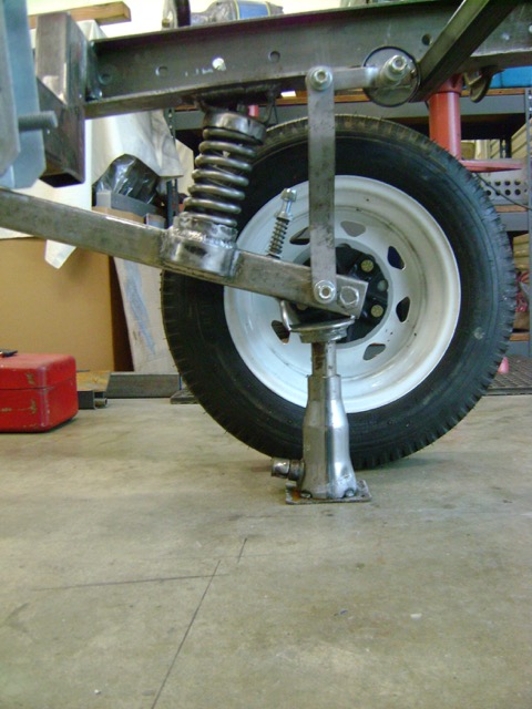

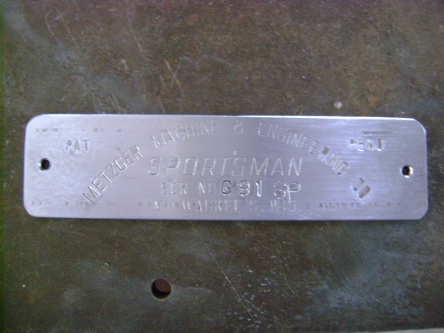

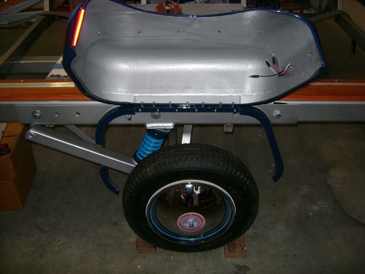

          Guys, I really appreciate all your comments & thoughts. This trailer doesn’t have an axle. It is custom built, but was built from a Metzger Sportsman G91 that was under the boat when I got it. Of course it is now completely change, but the suspension remained basically the same. Sending a few pics so you get the idea. These were during construction. The idea was to have a soft ride for the boat. It rides beautiful. Something is just out of whack on the alignment of the tires? We are not seeing any adjustment factor. I have a spring man when I get home or it may get a regular torsion axle setup put under it. Thanks again!

              With workmanship like this, I don’t think you need any advice, this is really a beautiful rig! That said, I wonder if you couldn’t work out some type of cam on the spindle much like a control arm uses to adjust the toe. I can’t fully see how the spindle mounts, but hopefully I can see it tomorrow. I hope to be able to head up to Tomahawk in the morning. (I will not be camping on site like I usually do, life is getting in the way again! :roll:) I plan to be there Thursday mid-day and leave Friday late afternoon as I have to work on Saturday.

                Hmmmm. Dan, I don’t see what locates that trailing arm laterally. I see a vertical link that appears to be connected to a bellcrank. Looks sort of like an old fashioned friction damper (shock absorber). But I don’t see that that link would stop the arm from moving sideways. So I suspect that the tread was scrubbed off the tires as they were running with a lot of toe-in or toe-out. (If the trailer wasn’t noticeably moving sideways, one could suspect similar geometry on both sides…) The camber you can check by putting a level up against the tire and using a little trig to calculate the triangle. There are homebrew ways of measuring toe, but they may not tell what it’s doing on the road. If you know a good racing suspension person it might make sense to have her take a look at it.
