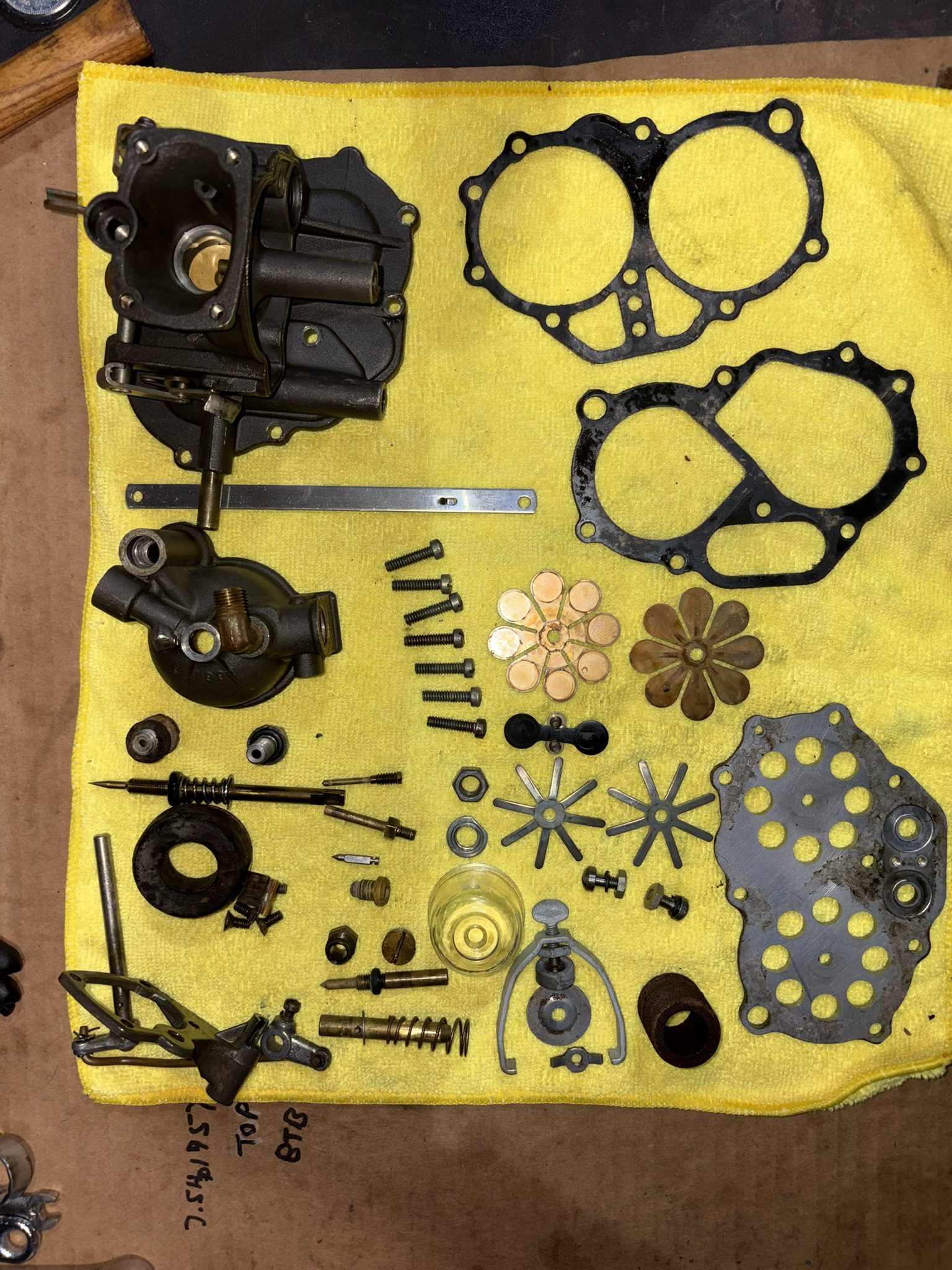

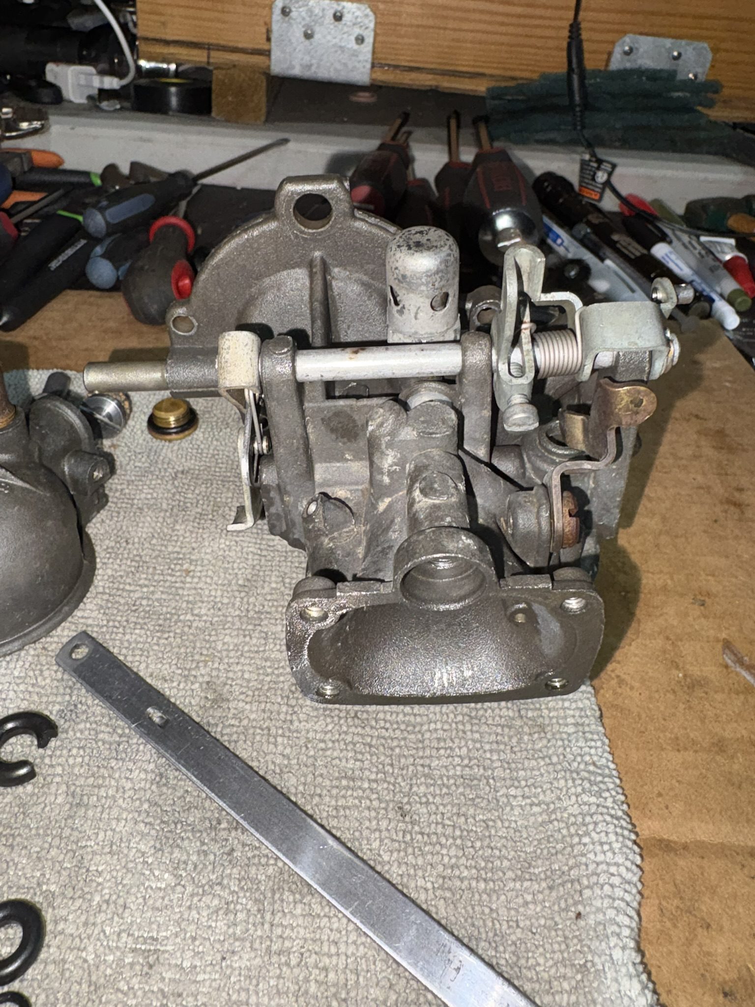

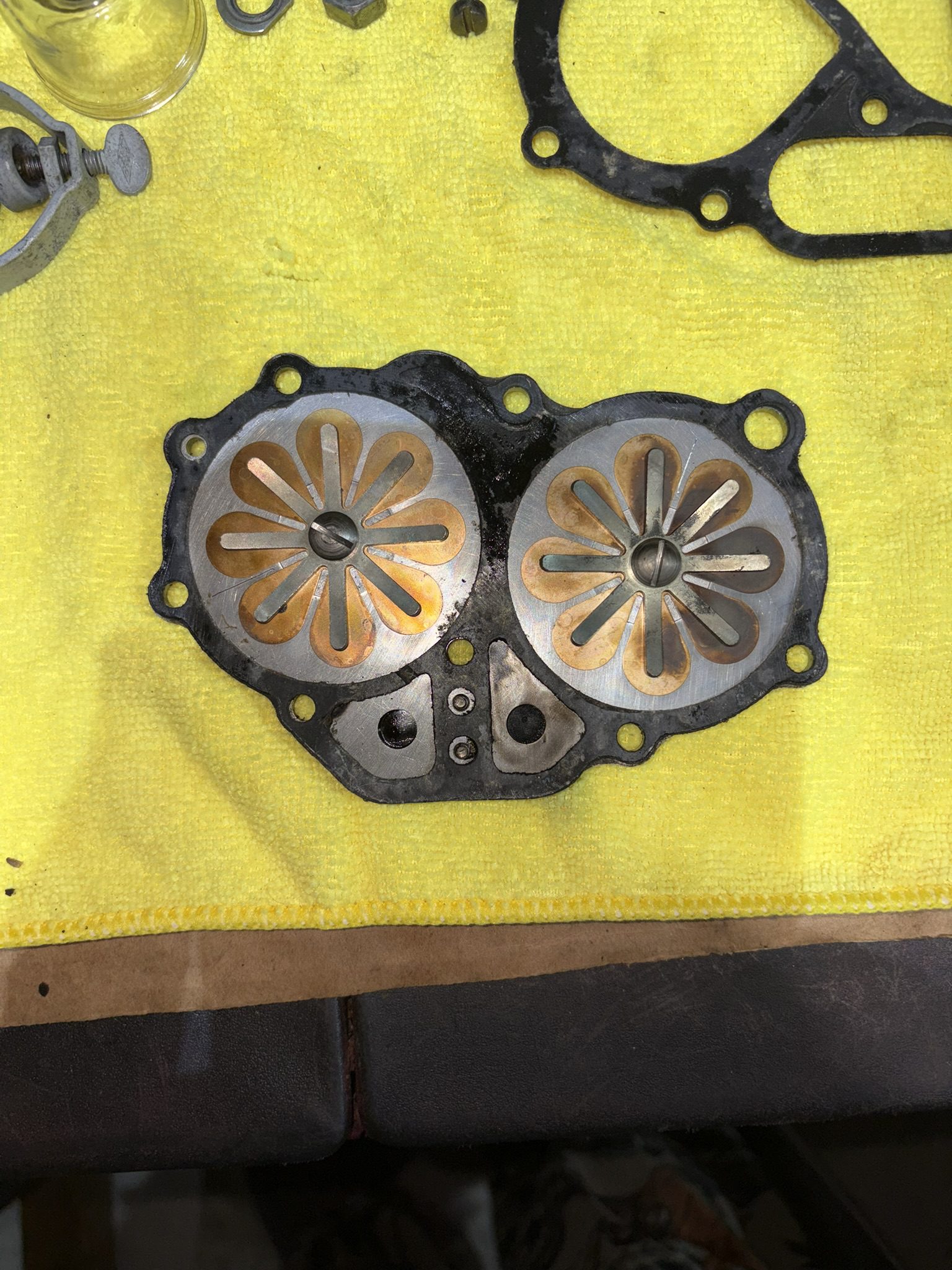

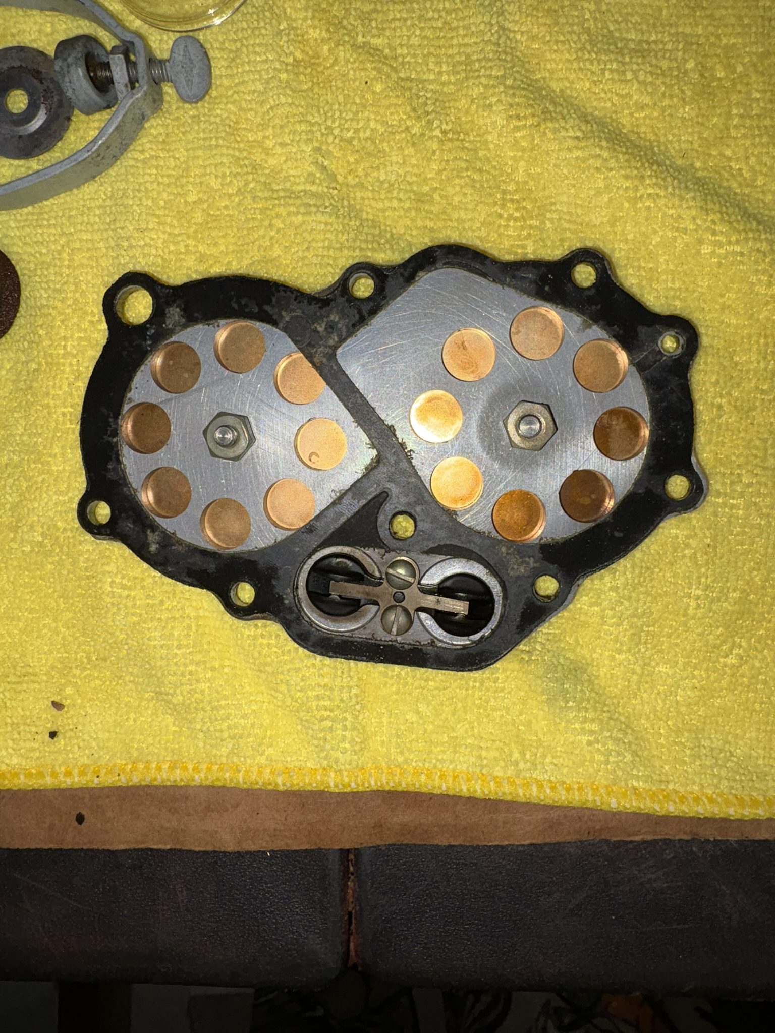

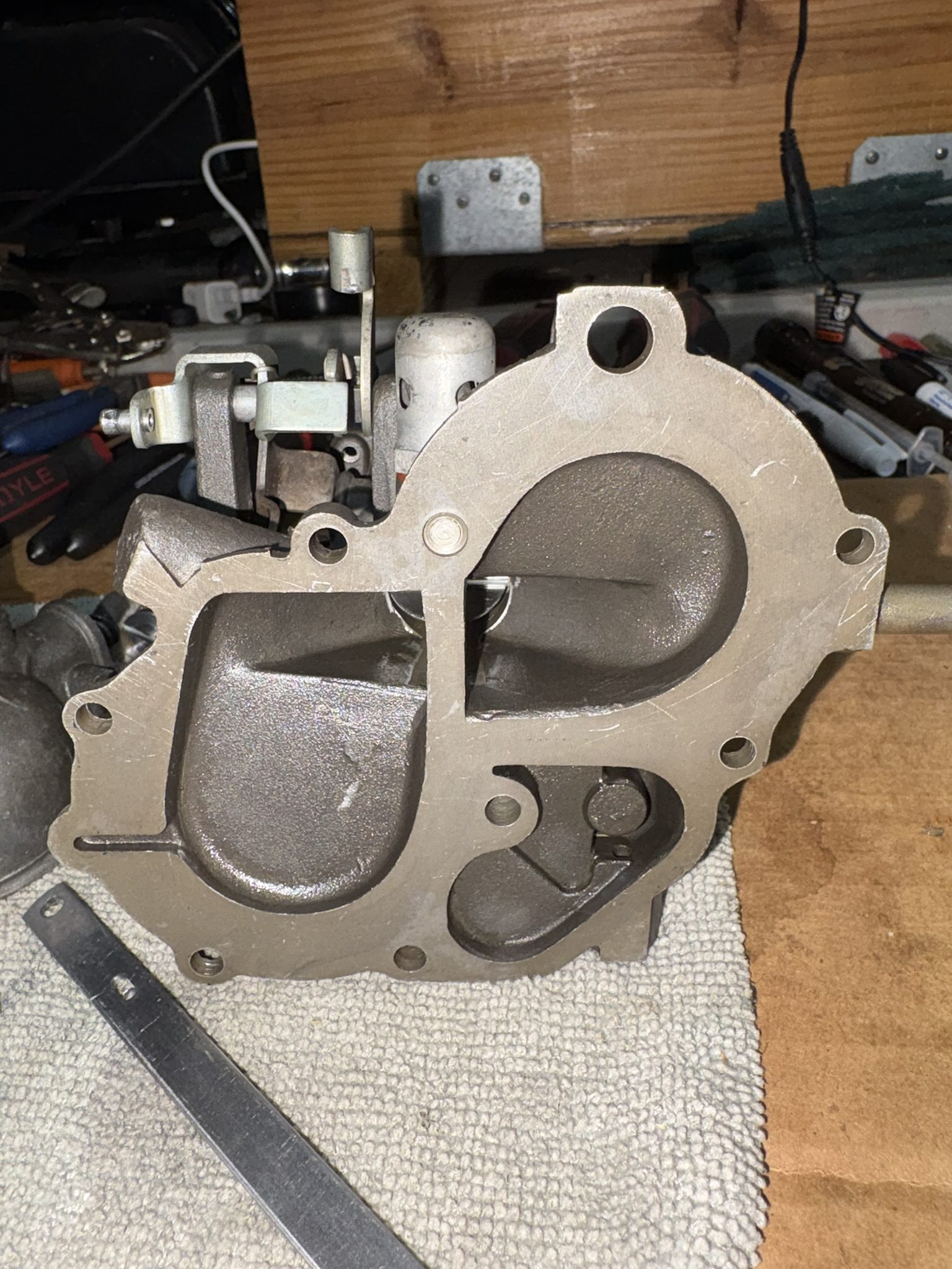

                I went ahead a pulled the carburetor off again for inspection.
                I do not see any issues with the carburetor itself. During my inspection I did notice the outer Leaf plate gasket that attaches to the carburetor side was cut in one spot. I will have to order a new one.
                Should I have taken the leaf plate apart for cleaning, or was this a bad idea? Should I also replace the rubber check valve that is on the leaf plate? Any advice on how to clean the leafs themselves?
                I  am going to try to post some more photos of the carburetor.
                Thanks, everyone for your advice. This one has been challenging so far!

                Kent Cochran
                  Couple of more photos. I think I have got the attaching photos down!!!

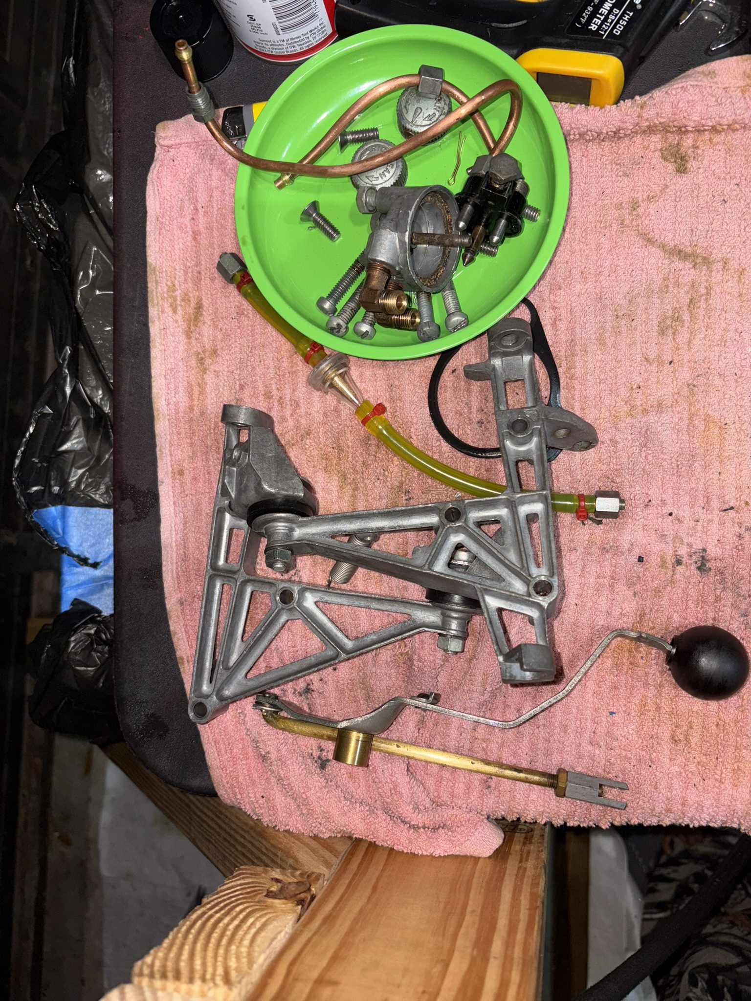

                    from here that glass bowl filter looks pretty bad… why not take it out for a test run
                    you could always hook up a lawnmower filter  on the fuel line instead  and leave the bowl filter out.
                    #303514
                    Kent Cochran
                      Check out the photo with little green bowl. I have built a hose (yellow) with a new inline filter. I will leave the main filter out, when I reassemble and install the carburetor.
