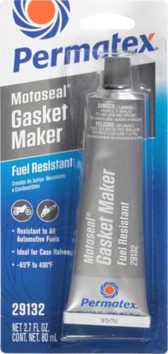

      Any autoparts store or tractor supply will have Permatex MOTOSEAL.
      I got mine at AutoZone for $13.99
      Permatex MotoSeal Ultimate Grey RTV Gasket Maker 2.7 oz (autozone.com)s-l500
      s-l500
      I also used a grey colored Felpro gasket between tank halves and sealed one side at a time using many addtional C clamps.

        Fifty20One, I’ll add that to my shopping list for my next
        trip to the “big city”. Sounds like good stuff to have on hand.
        Thanks!
        #272346
          Never had occasion to seal a fuel tank before, but I’ve used the Permatex Motoseal to seal the crankcase halves on a couple motors with no problems.
