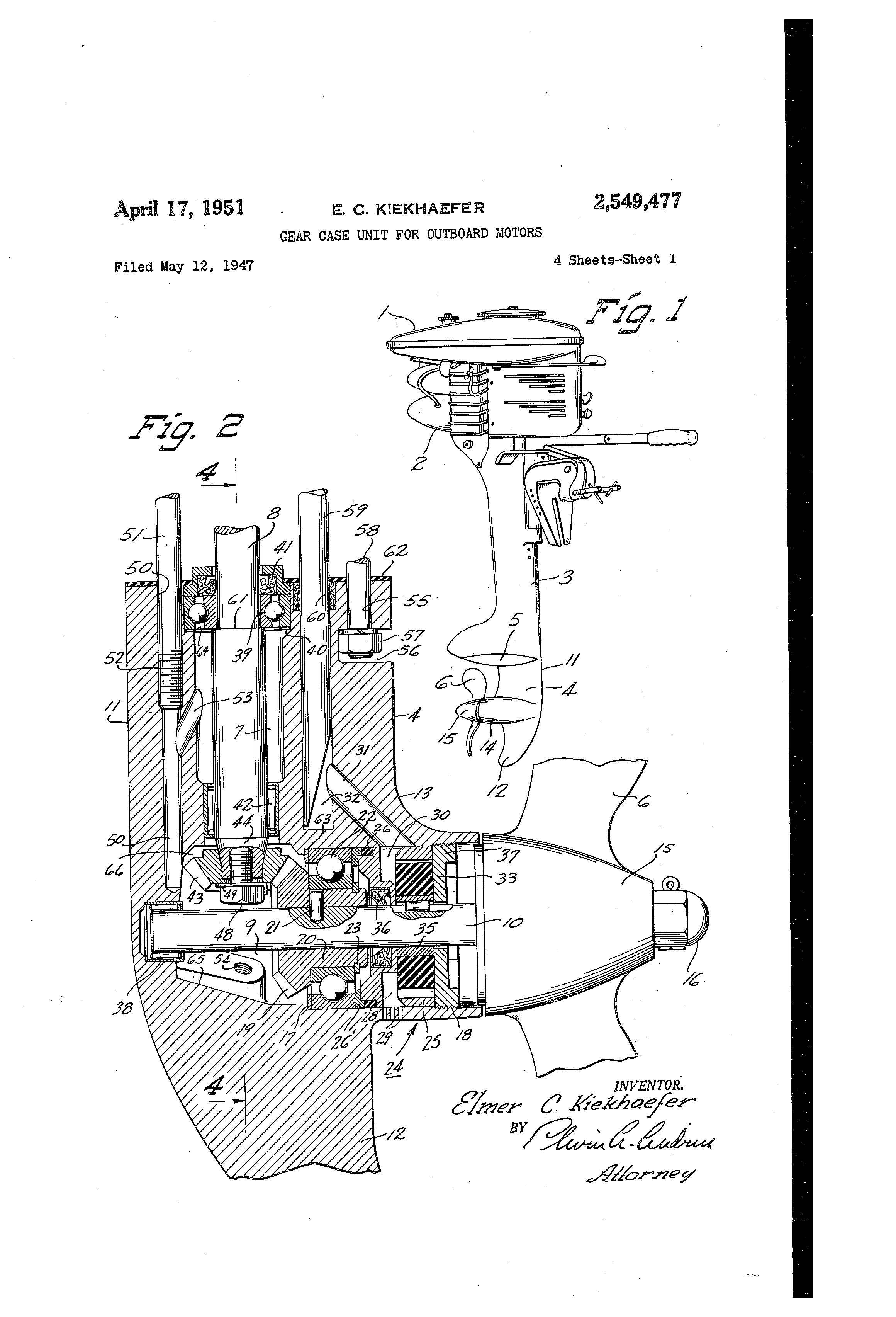

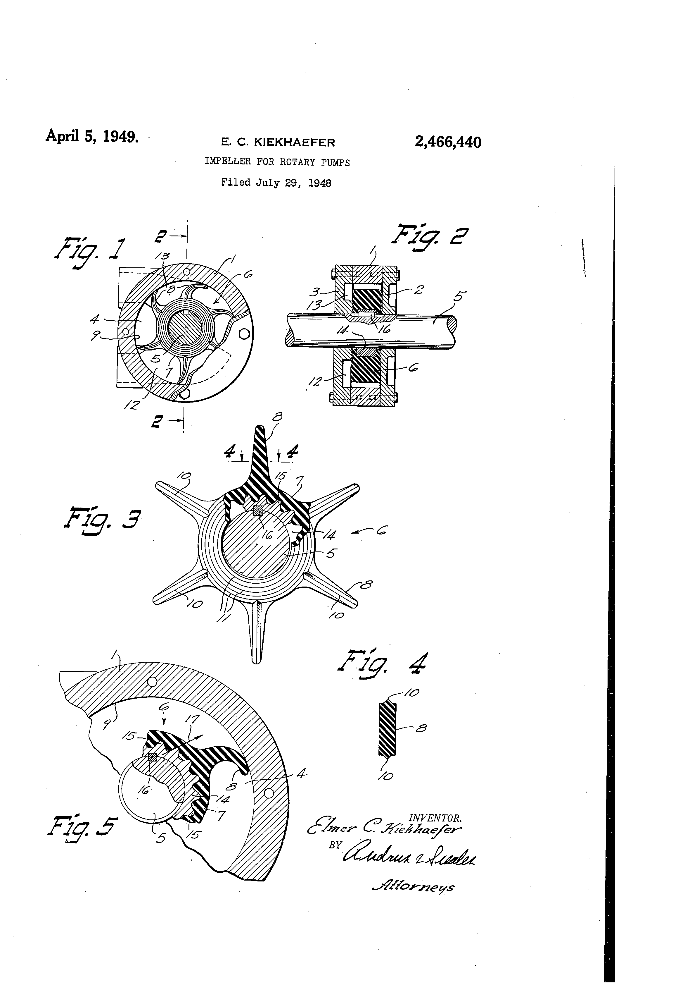

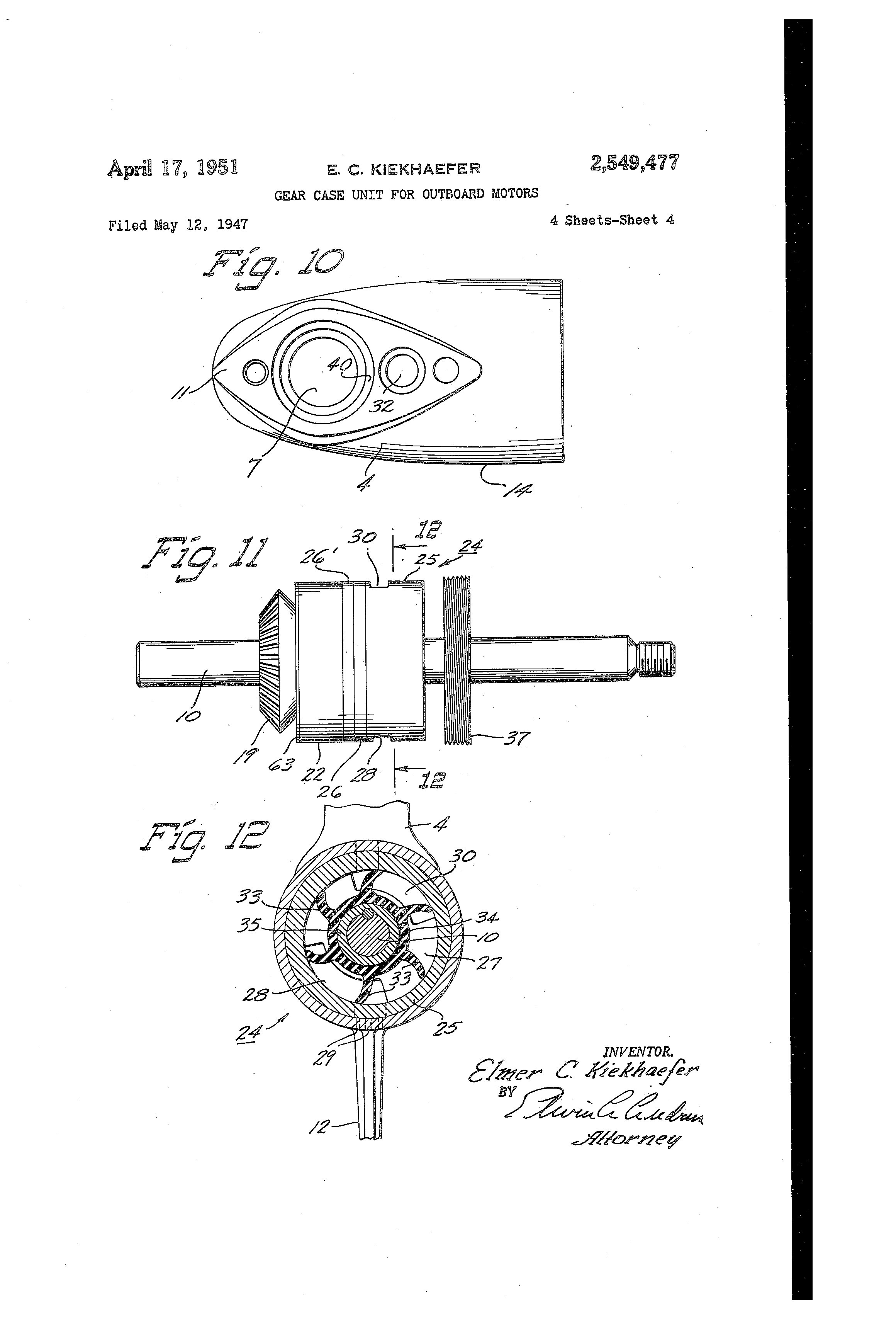

              ROBERT LAFAYETTE

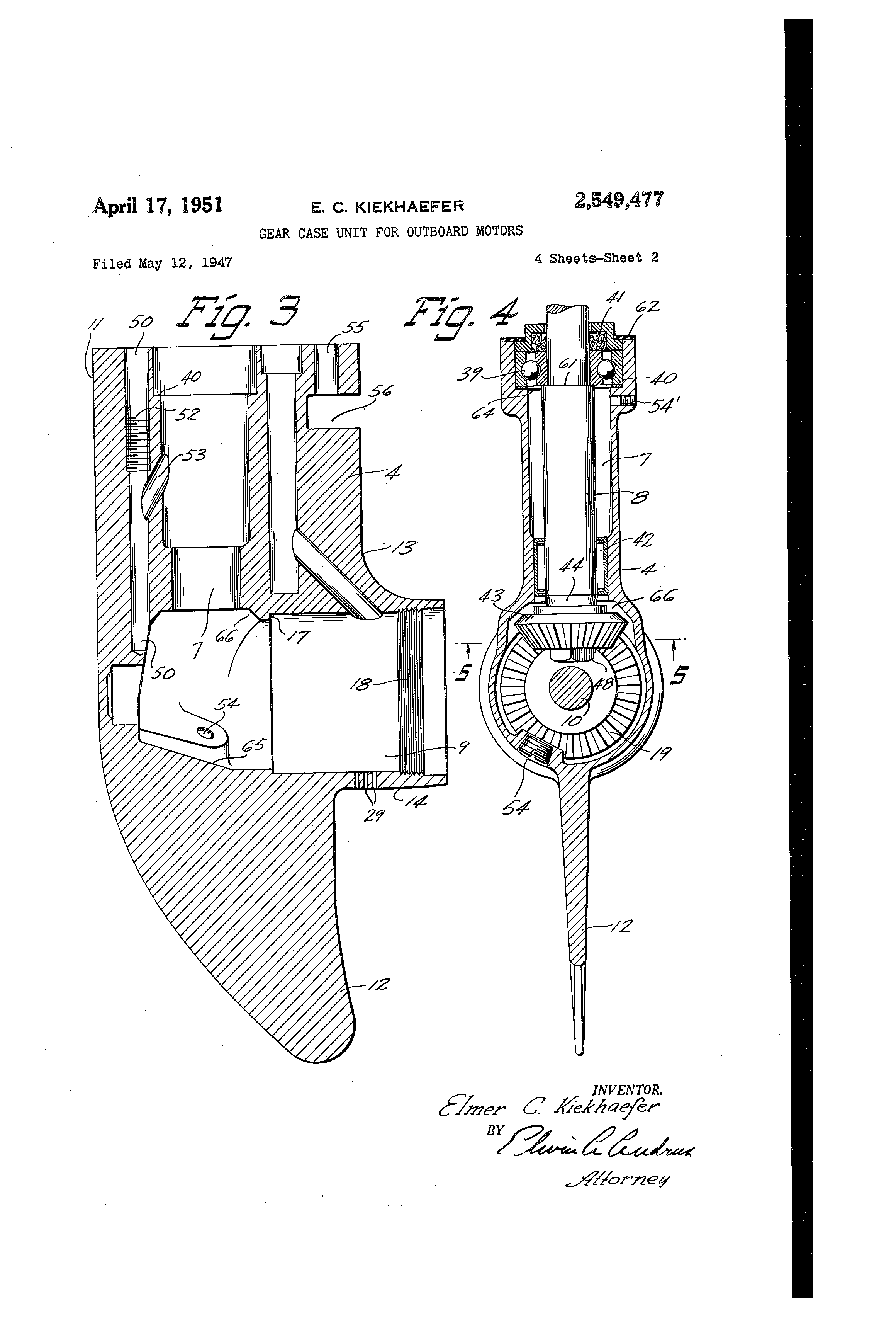

                Some patent drawing s may help?
                US2466440-drawings-page-1
                US2549477-0
                US2549477-1
                US2549477-3
                #200371
                  Thanks, you guys got all the goods, like a treasure box full of info on this site 🙂
