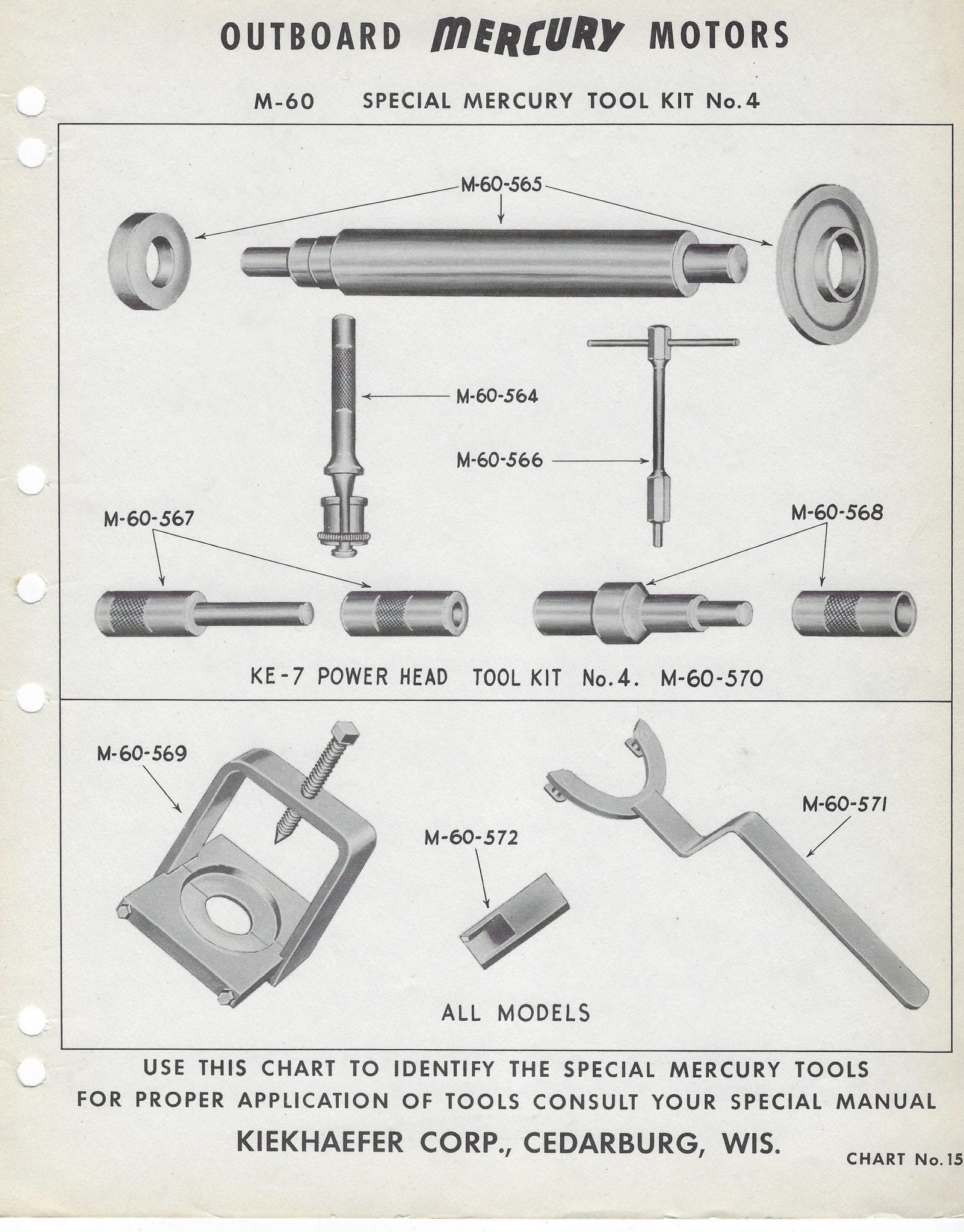

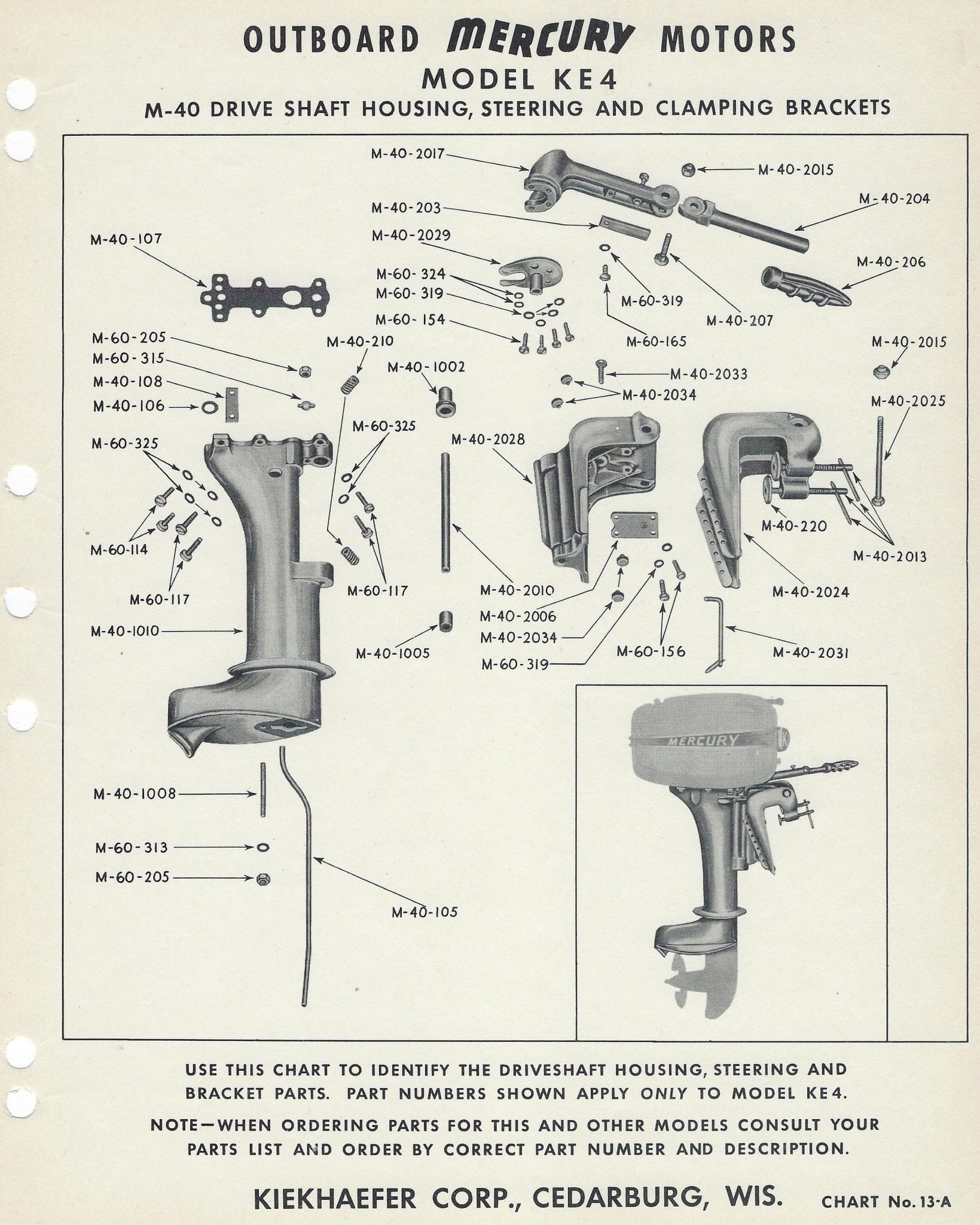

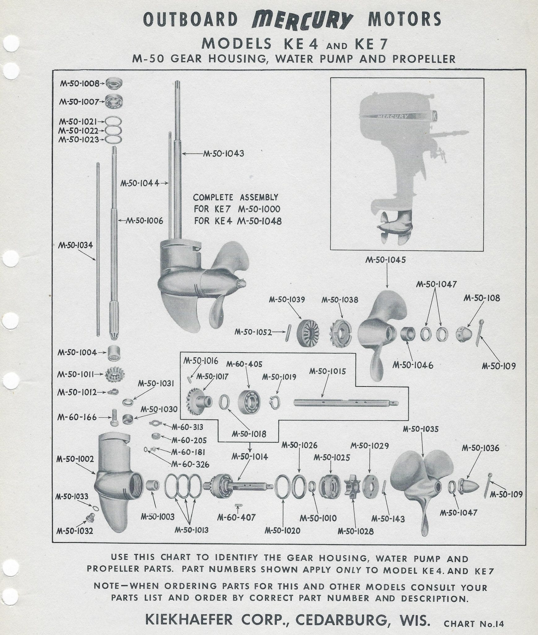

                  Some Mercury factory training charts.
                  Can be found in “Technical section”
                  On this site.
                  Chart13A
                  Chart14
                  Chart15
                  Chart16
                  #199812
                    thanks yes that tool is close to what i pictured in my head. After the cover is off is it necessary to remove the entire impeller housing or can the impeller be replaced without going further than just removing the cover?

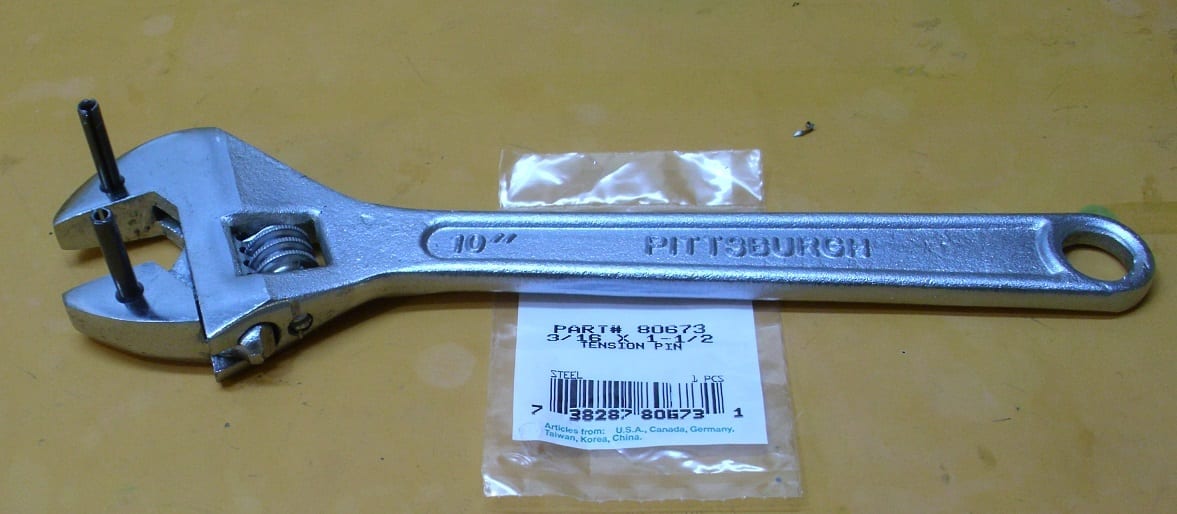

                    #199816
                    CHUCK
                      I could be wrong but I think it was Member Tubs who posted this picture of a tool he made. Just to give you some idea of what people do to help things along without spending $$$$$ on a factory tool that you will only use a few times……
                      Tubs_Span
                      #199871
                      LLOYD LAUTNER
                        I made a tool similar to the M-60-544 shown above for my KG7 some years ago. Worked like a charm. As noted above the cover is a Left Hand thread. If you are near me in Traverse City Michigan, You are welcome to come by and use it.
