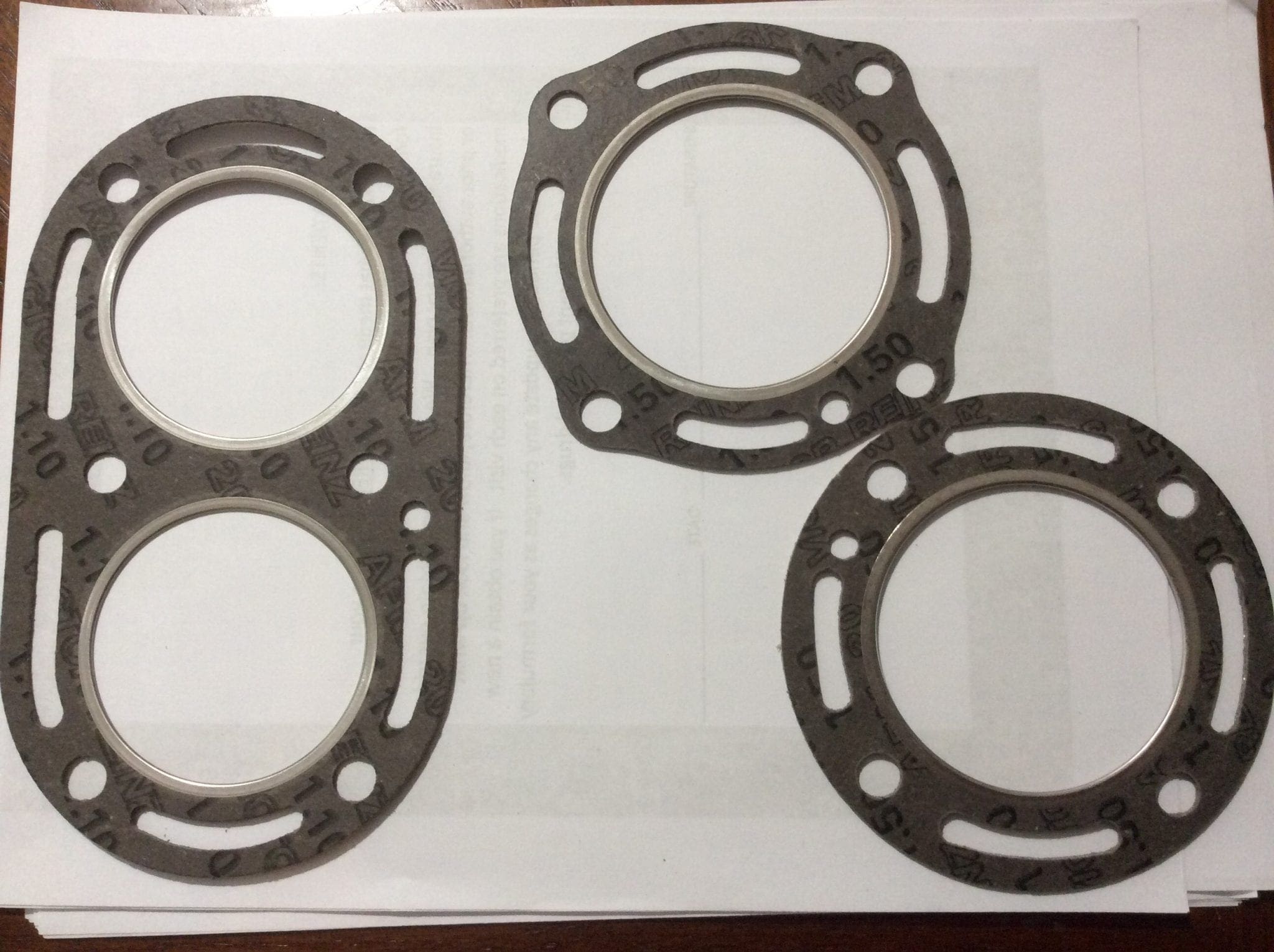

October 18, 2023 at 5:39 pm #281808Don’t know how the gasket set photos got there! Can’t figure out how to delete them. Sorry
Steve
October 18, 2023 at 10:23 pm #281844The pin wrench would be a good investment if one was working on
Mercs. Nice gaskets anyway, lolPrepare to be boarded!
