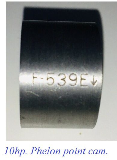

            Looks like the carburetor cam on the Scintilla mag is different from the Phelon. Is it a direct fit or does the cam need to be switched?
            I’ve got the complete Phelon Magneto less the speed control handle.  Also have the 398-241 Phelon magneto cam and the flywheel.

            #301850
              Scintilla lever will interchange with the Phelon magneto. I don’t have part numbers. The flywheel and point cam from the 7.5 hp motor won’t interchange because the crankshaft is smaller on the Mark7 & KE4 . Are you sure you have the cam for the 10hp. motor? Does it fit on the crankshaft? On this type on ignition, when moving the magneto lever, your advancing or retarding the timing, so there is no correct timing. You will also need a different flywheel key than the one from the Scintilla. It would be a good idea to change the crankshaft seals and remove the fuel  filter to check its condition, if it is still in there.

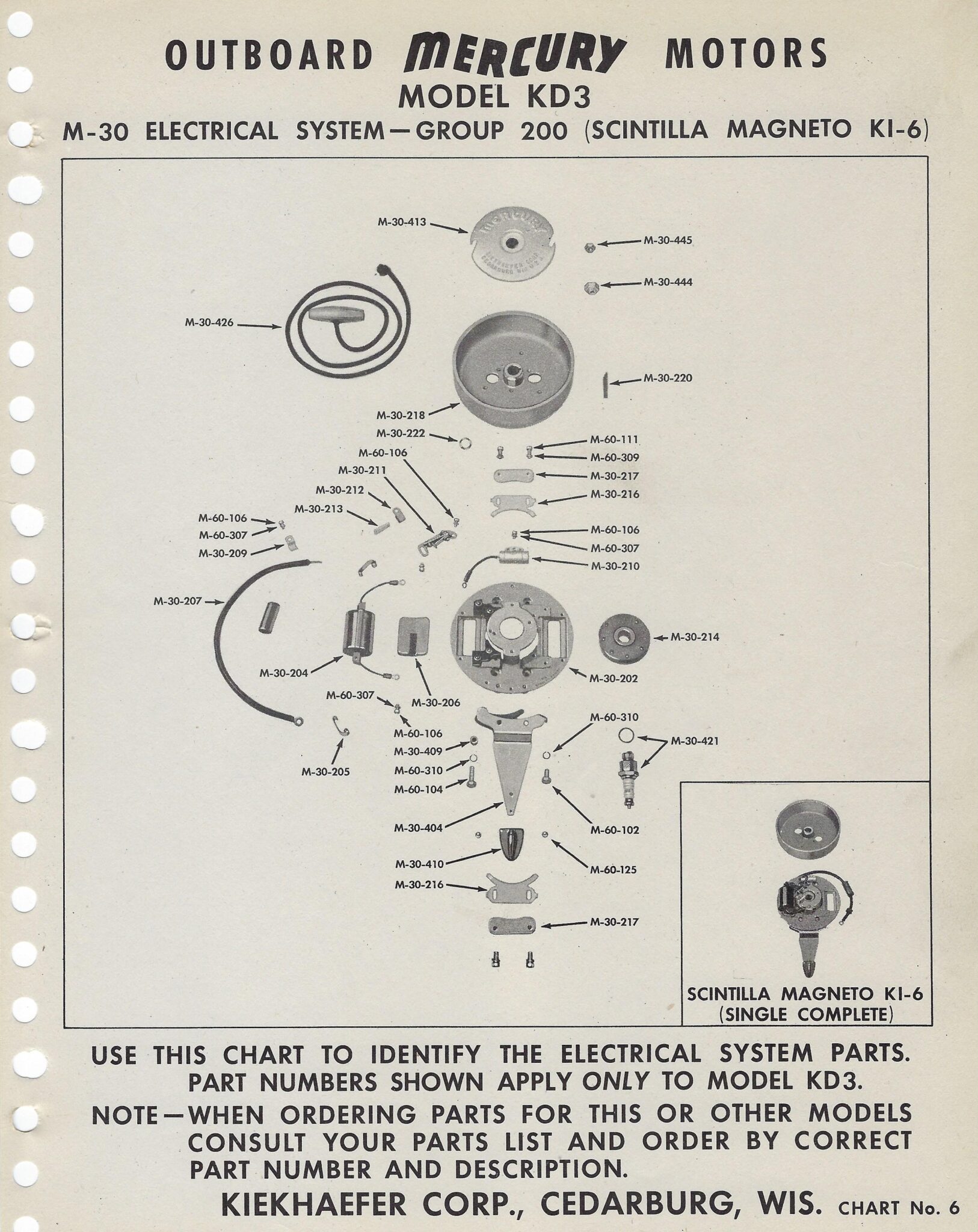

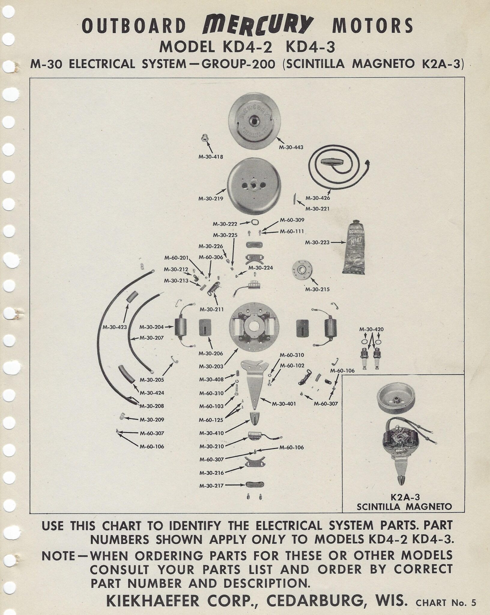

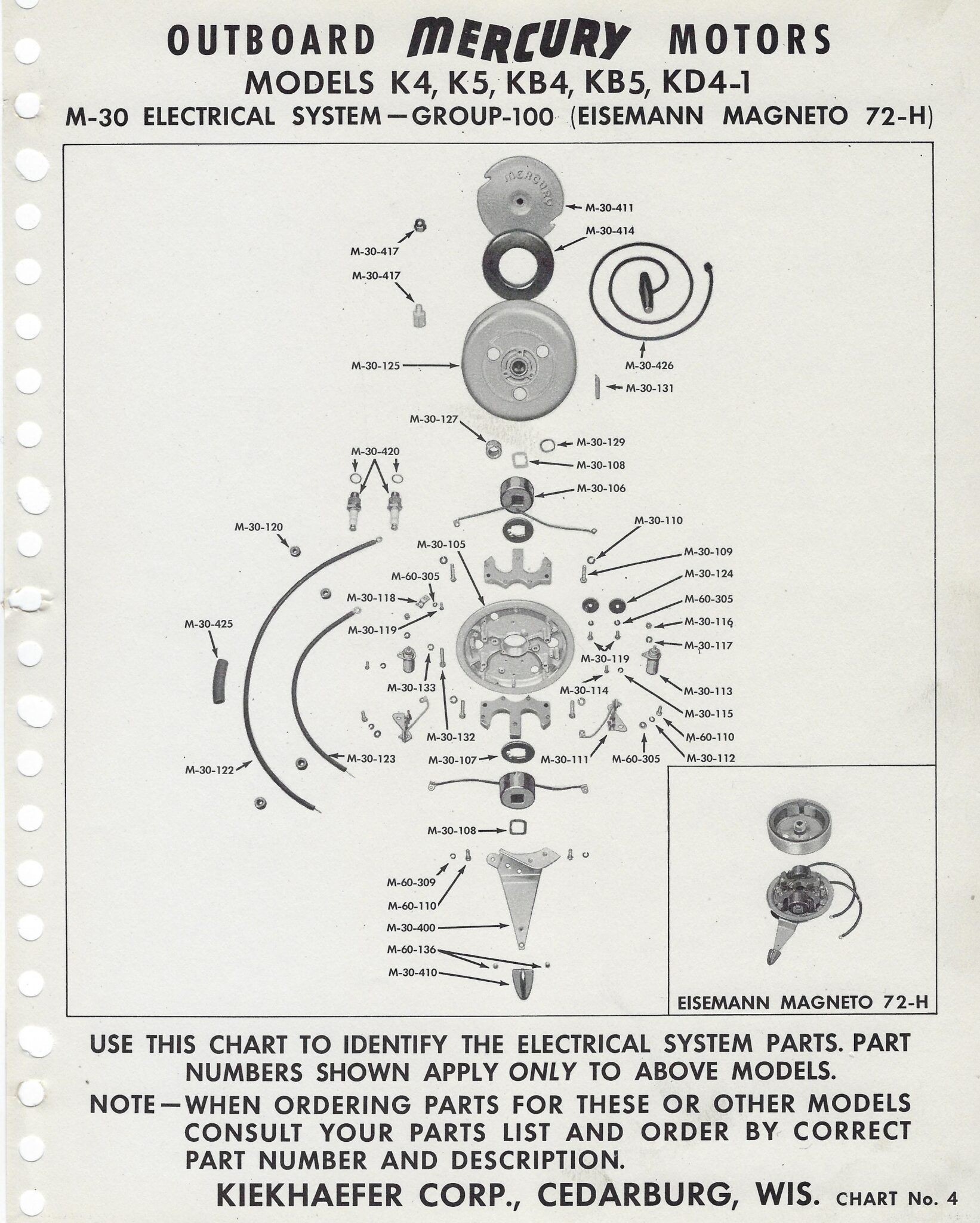

                      ROBERT LAFAYETTE
                        as requested by Lou. (GreenThumbs)
                        Chart4
                        chart5
                        Chart6
