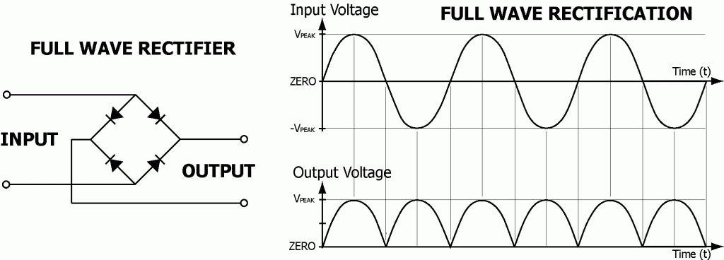

      Wish I could show a wave form using my O-scope. Always instant understanding! 😉 Frank describes the process well though.

          Wouldn’t installing a capacitor across the output leads help to smooth out the DC current a bit?
          #31398
            quote Mumbles:
            But why would it be necessary? The battery also does that.
            #31403
            jeff-register
              Been a long time since I read about a battery being a filter, One of the best filters around for both sag & swell correction. Thanks Frank, You make me think!
