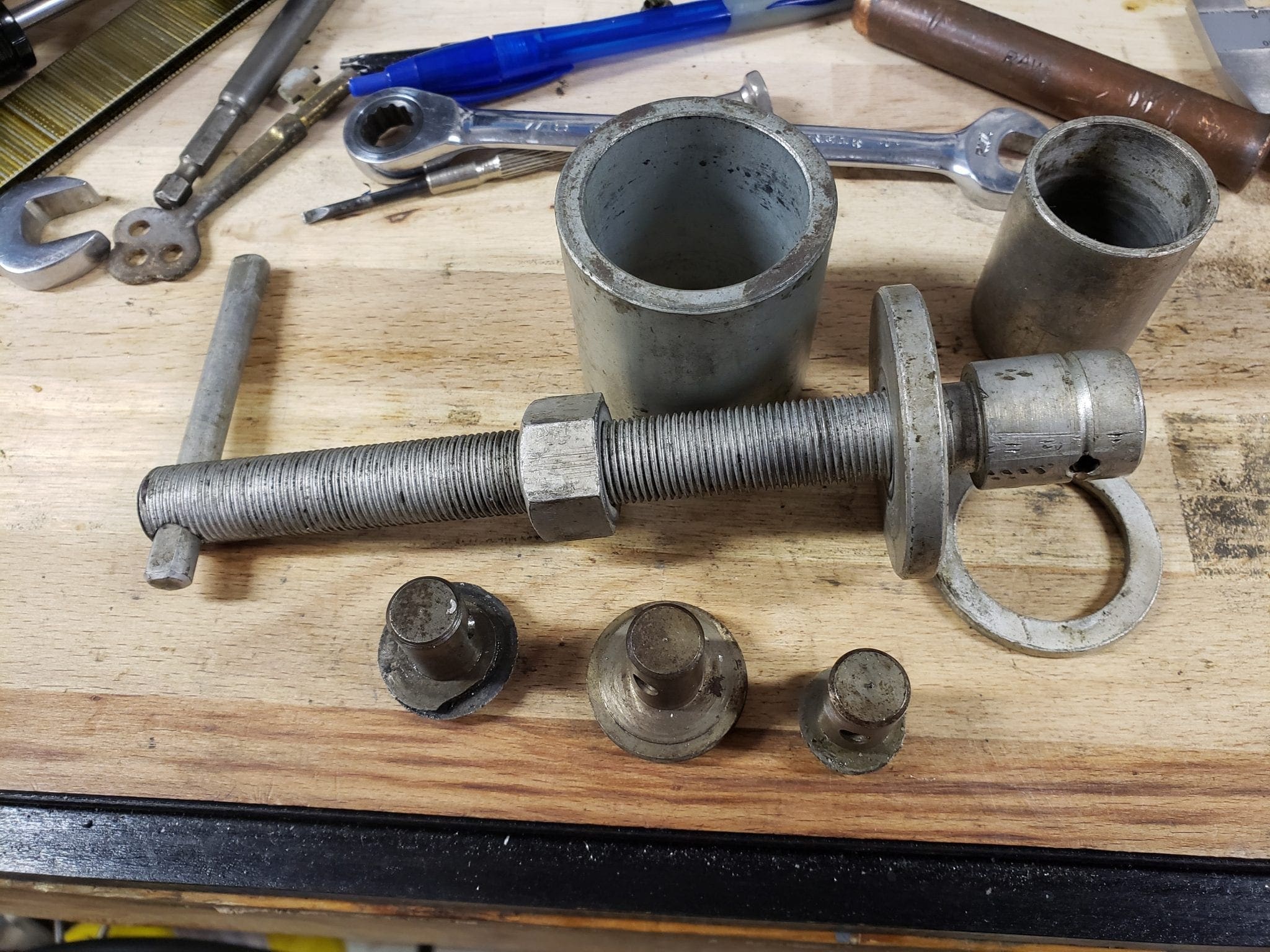

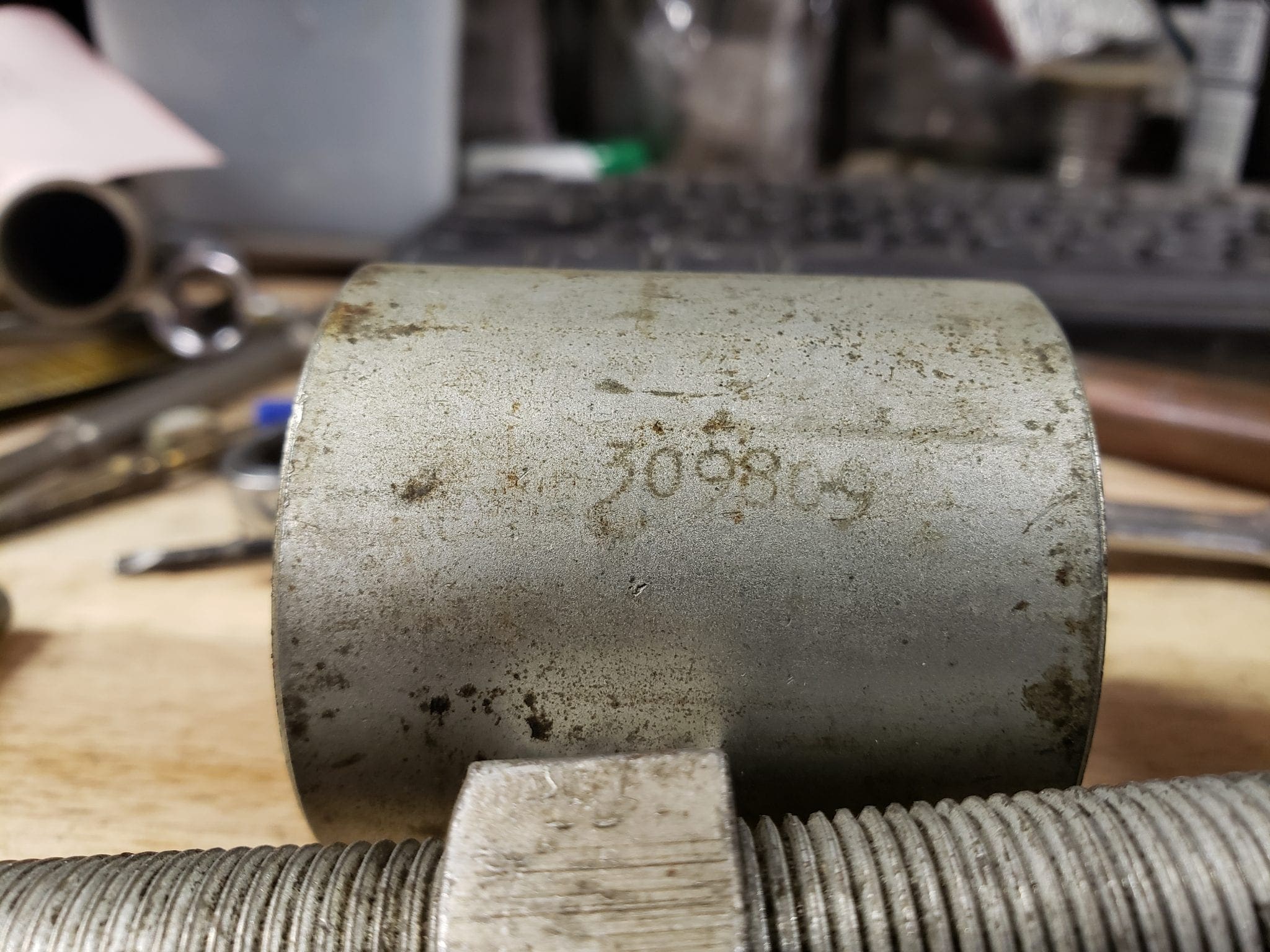

            #167846
              I believe this is what you are looking for Crosbyman
              http://www.everythingoutboards.com/brp/tools/377565.html
              And photos should also be included.
              Having used this puller, I would agree with Frank, while it does work, there are some inherent issues, like the threaded part breaking threads, as it is hardened, I suspect threads like I use for the seal puller would most likely work well. And I am not intending to sell it, just showing you all what was made to do that job.
              20190221_182637
              20190221_182649
              • This reply was modified 6 years, 11 months ago by RICHARD A. WHITE.
              • This reply was modified 4 years, 11 months ago by Mumbles.
