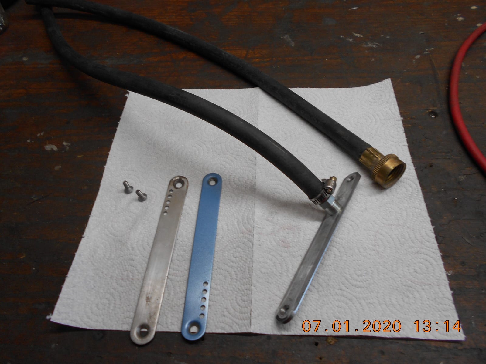

        I made something like Steve posted using an old washing machine water hose as it had the hose connection on it and was smaller ID than a regular garden hose. Brazed a fitting onto a piece of scrap steel.

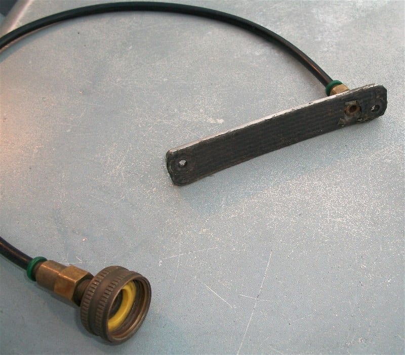

          I made up a test hose a couple of hours ago. I also used a double female
          washing machine hose……. cut it in half, so I could make up another unit
          if I get the urge.
          I used a scrap piece of 3/4″ x 1/8″ galvanized strap metal that I had,
          and drilled (29/64″) and tapped it for 1/4″ pipe thread.
          A 1/4″ npt air tool coupler fitting screwed into the plate, and fit inside of the 3/8″ ID
          washing machine hose nicely.

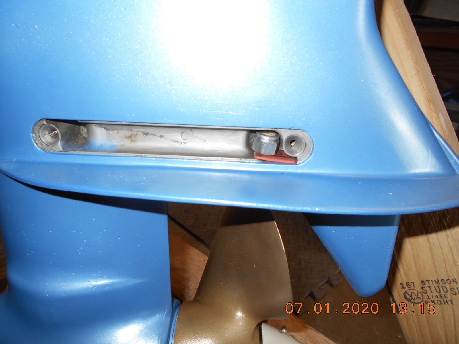

          Though evidently not necessary, I laid a piece of rubber gasket material over
          the hole going to the intake screen, and put a nut over it to keep it in place.
          (Hope I remember to take it back out!)

          P.S.- I had to use some longer #10 bolts to attach the test plate to the motor

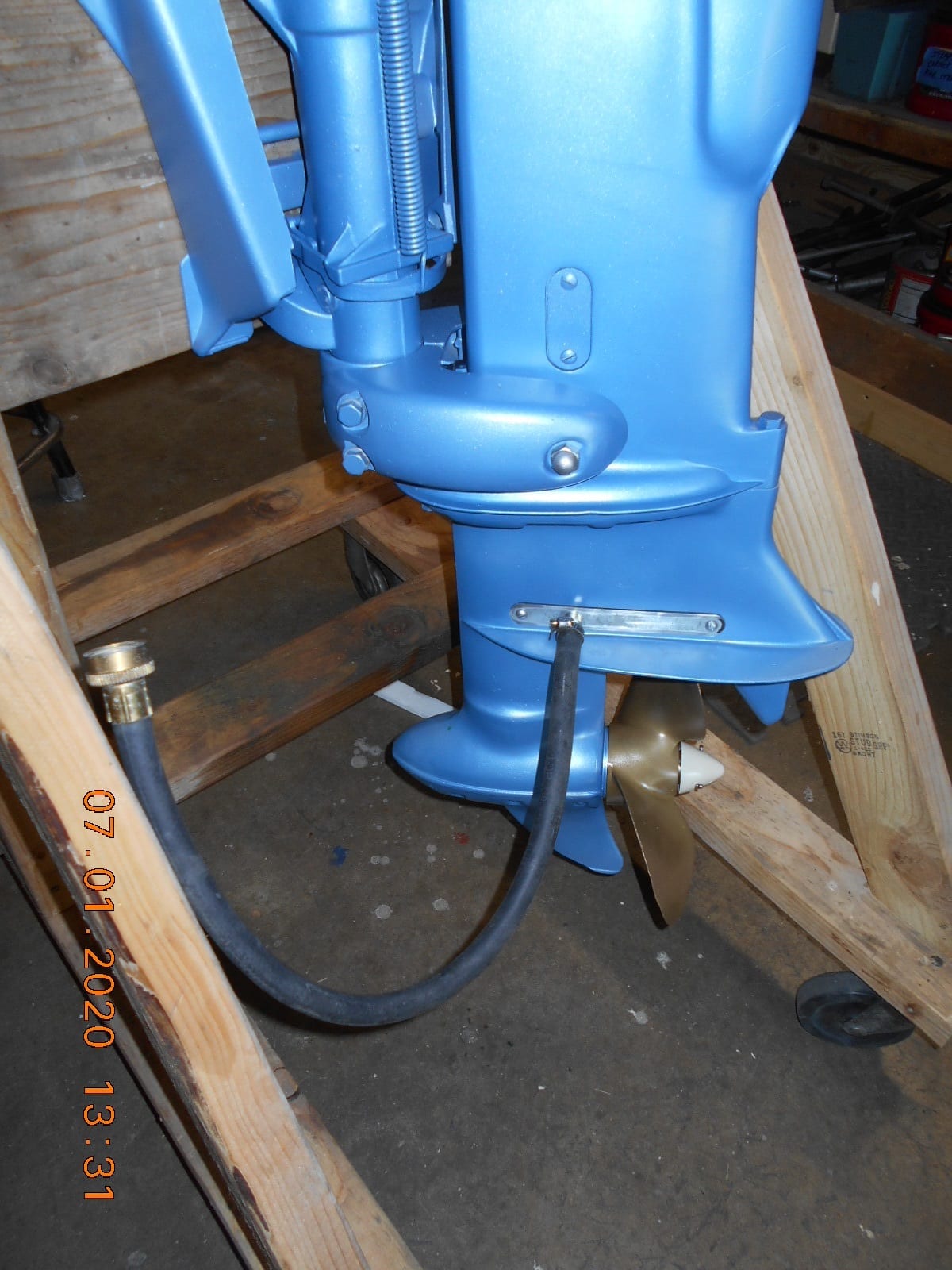

                  The water supply test plate in action.
                  Maybe I should have made a gasket for the test plate, but
                  it seem to move plenty of water thru the motor.
                  First time I’ve ever heard this one run………. it shows promise!

                      “Maybe I should have made a gasket for the test plate”
                      You can’t see it too well in my other picture Buc but I glued a piece of rubber to the back of the plates and it does help the seal. If someone wanted to use an original plate instead of making one this would also block all the holes off.
                      I like your idea of blocking off the rear water intake from the inside to help direct the flow up.
