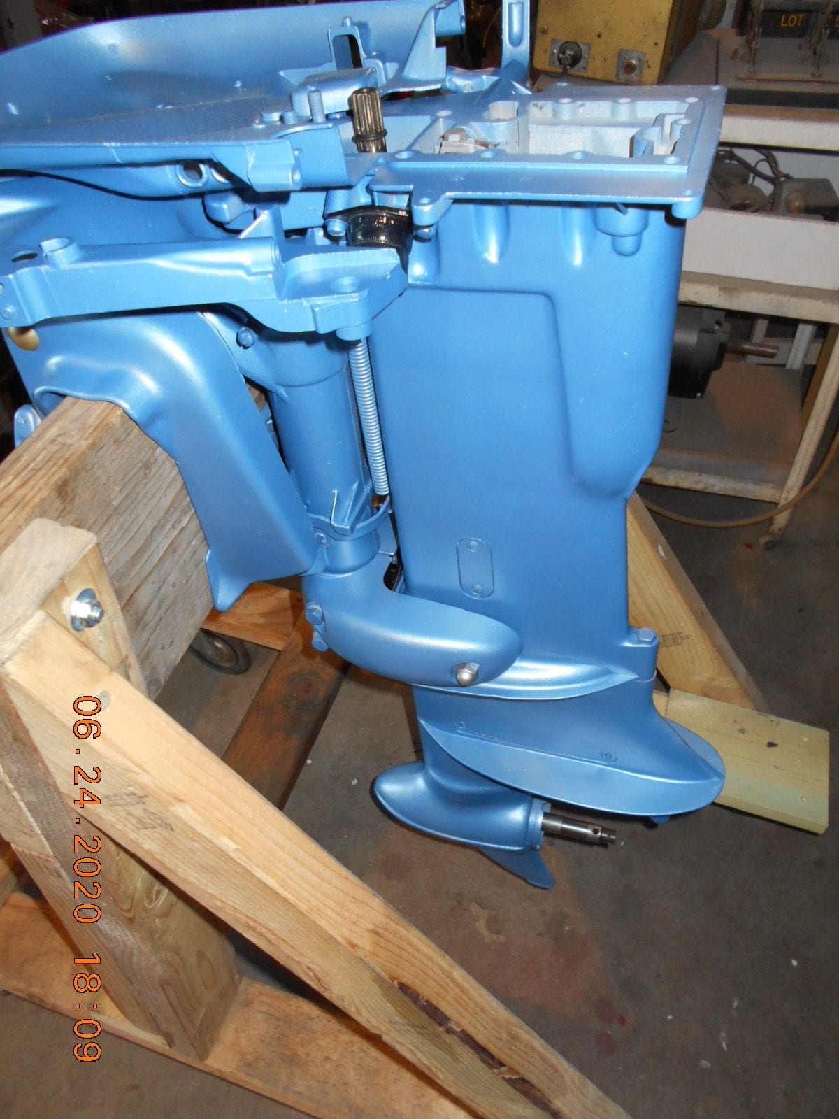

      What style “muffs” were designed to fit the vintage OMC’s like
      my 57 Evinrude 35 hp?
      I’ve searched on site for “muffs” but didn’t come up with any photos.
      I seem to remember seeing a homemade plate with garden hose
      attachment. Anyone have photos of homemade or aftermarket muffs
      to fit these motors?
      I’d like to test run this motor but getting a tub of water under it on this
      stand is problematic!
      Thanks.

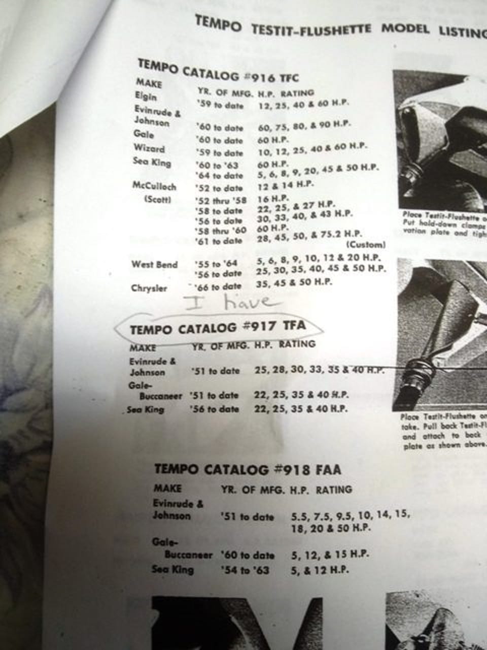

        I believe Tempo Marine Products may have made one back in the day but I have only seen homemade ones.
        #207180
          tempo made 2 types one replaced the side cover and one clipped over the exhaust snout.
          #207192

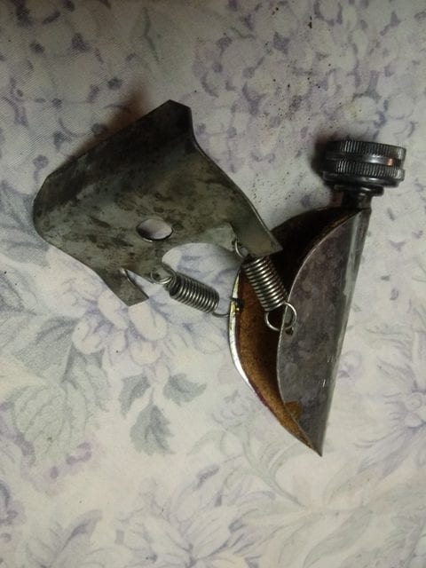

          outboardnut
            I have used the 917 for rd-17 and rds 20

            #207197

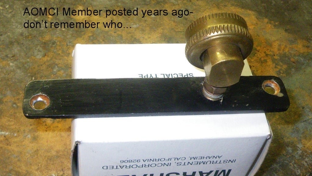

              Thanks for the replies. Anyone make their own side plate / garden hose contraption?
              Tempo-917-Muffs

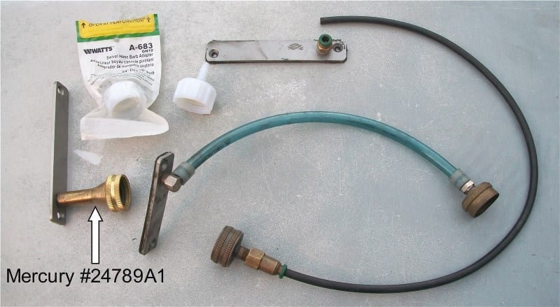

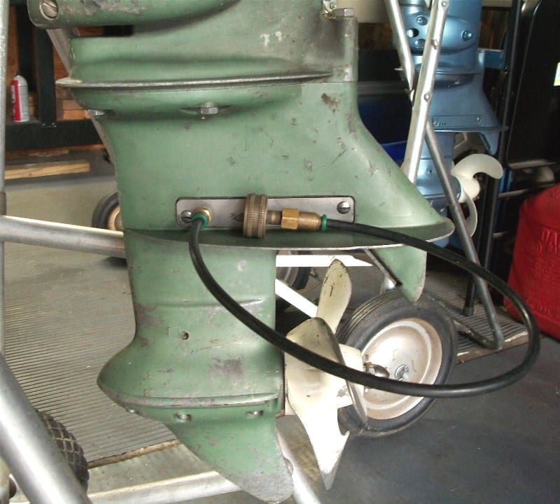

                Buc, With your skills it should be a piece of cake. I’ve done it a few different ways but you basically just make a plate to fit the water intake, or sacrifice one from a parts motor or an extra in your stock, whatever…tap into it with a fitting, and attach a hose, and garden hose adapter and that’s it. Mercury makes a brass adapter you can adapt to your plate, or use a fitting, a piece of hose, and a cheap plastic garden hose adapter. One of the pictures shows one that a member made but don’t remember who.
                Edit: Pictures didn’t seem to upload properly. Might be duplicates.

                #207205
                  Steve, excellent! I have lots of ideas now. Thanks!
                  #207216
                  Dale
                    Steve, that looks pretty good! What do you do with the pickup behind the prop? Duct tape? I suppose you could put a piece of rubber behind the plate so the water could only go one way. Think I am gonna make one of those puppy’s!
                    dale
                    #207223
                      dale
                      I “think” I was wondering the same thing. There’s the intake screen lower down for the water pump,
                      and if I remember correctly, the passage runs up into the cavity where the little plate is
                      bolted on, and where the garden hose adapter would attach.
                      #207227
                      Steve D
                        Water does come out of the pickup behind the prop and you could cover it if you wanted to for a more direct flow. I’ve never worried about it too much because there’s still enough pressure from the garden hose, even with the faucet open 1/2 way, to force water up past the impeller to the powerhead. Of course this doesn’t really test the impeller but it still is a good way to test initial running, settings, etc. when you don’t want to use a bucket or like you said Buc, when you have stand limitations or a heavy motor like yours.
