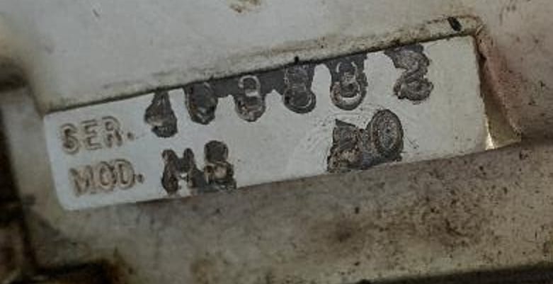

Yes still has 2 cylinders

HS20 indeed! Lots of HDs out there but not many HS models! That is a really nice example! Take care of that baby!
March 30, 2020 at 8:45 pm #198851Opposedtwin and buccaneer, thanks to both and lloyd for the confirmation on the model for the motor.
Otwin .. you say rare motor should I put this on the back burner and look for another motor to push my boat? My intention is to use the motor a few times a month till fall.
For all watching waiting to chime in. How do I test for spark? And where do I go for guidance with this old outboard?
March 30, 2020 at 10:33 pm #198856I believe the only difference in the HD (deluxe) and HS (standard) is the HD had the rewind.
Guess most people back then probably paid the extra $5 or whatever is was, for the rewind.Prepare to be boarded!
