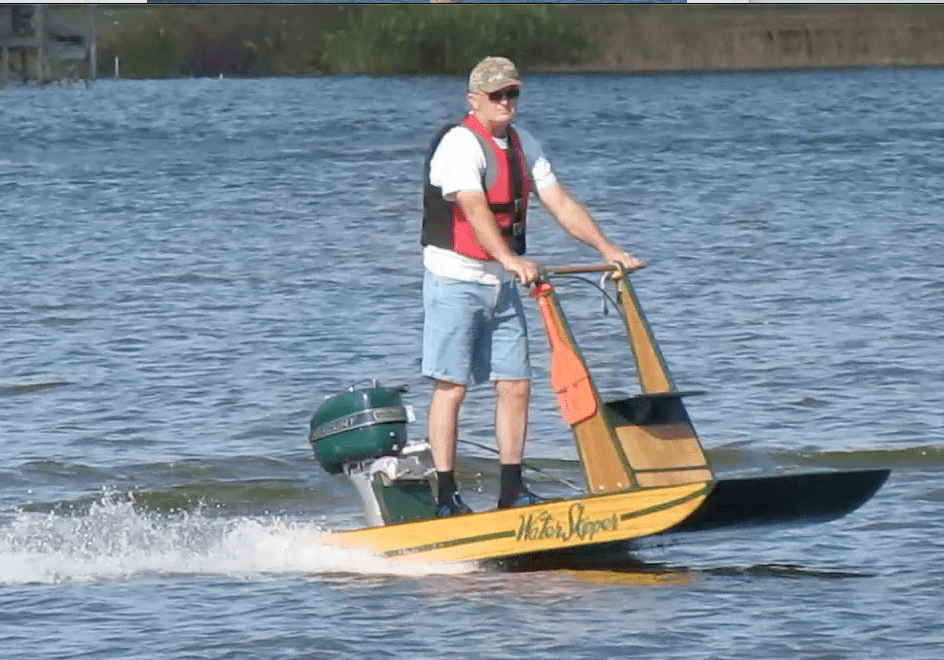

      I had one of these Water Skippers that dad brought home from the New York Boat Show. It would plane well with a five horse but would run like a scalded dog with a seven and a half. I can give you the plans if you want to build one. The Marten would be a lot of fun on it. – As for a tilt lock – these were available in the 1950s. Not hard to make if you’re a blacksmith. . .

        Those waterskippers look like a riot! H looked up a few more pictures (some from AOMCI events). The Scott does have mounts for remote throttle and steering, so that could be an interesting option. Also, what about something like a 12′ runabout? I’m guessing a 7.5 hp would be on the small side for those.
