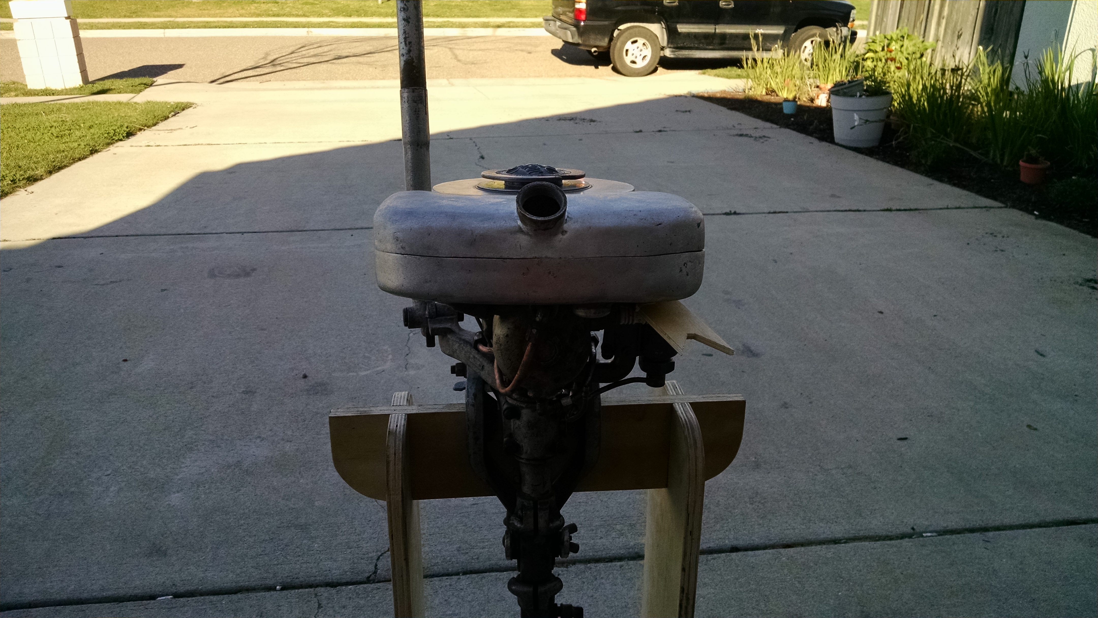

          I’m happy with the simplicity so far. One air screw on a carb is a nice change! I need to check the water pump to make sure it’s working, and I’m not yet sure how to get to that. I’ll figure it out though.
          Your J-80 looks nice. I’m envious of your tank. Mine is so warped on the bottom that it is actually sitting lower than the flywheel. Doug says he should have one to replace it.
          #32014
          vwtrey
            Took the tank off today. Got most of the dents out, and warping too. I still have some straightening to do, then I’ll weld it shut. Should be good enough for a runner.

                My J-80 is on hold until I stumble upon a parts engine.
                VW, would enjoy seeing photos of the tank welding
                process, and equipment used. Is the tank steel or
                aluminum……… that’s one part I’m missing along with
                a carburetor.
