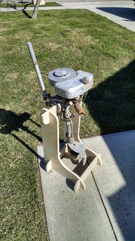

In my first post here, I didn’t take the time to introduce myself. I’m Trey, and I’m new here. I am in the Air Force, and have been for almost 19 years. This is my first outboard engine, ever. I have experience with engines and metal working, so I should be fine. I also do a lot of woodworking, which brought me to finding an older outboard. I’d eventually like to build a small boat to go with my engine, if I can find what it should look like. The engine I bought is a Johnson J75. I put together a quick stand for it, and today I am tearing it down and looking things over. The tank is worse than I thought, but can be fixed. I’ll need to find, or fabricate, and original style muffler. I also need to source a grip for the tiller. The compression seems good, and everything looks relatively untouched. Here’s a picture of it.
February 9, 2016 at 11:05 pm #31708Well, first off, welcome to the group. You will find that the folks here are most helpful in assisting you to get that motor running. From what I can see your motor looks like it’s in pretty good condition. That vintage Johnson motor is normally very reliable, you should find that the ignition coil is good, clean, clean the points (set at .020) and see if you have spark. The condenser may have to be changed as they deteriorate with age, about any .22 uf capacitor will work. That motor has a plunger water pump, be sure that the check balls are not stuck shut or it will not pump water. Clean the fuel system thoroughly, from tank all the way thru to the carb. The tank, it looks pretty nice from this view!
I’m sure that guys with more specific knowledge of the J75 will be checking in with more info.
That’s a real nice stand that you made, knock down design.. I suspect that many guys here would like one like that.
And finally, where are you located? check the "upcoming events" page here and come out to one of the local meets, that’s where you will find parts, info, help and friends.Joe B

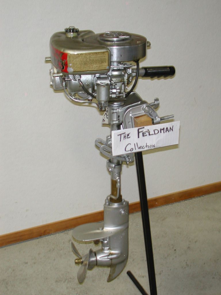

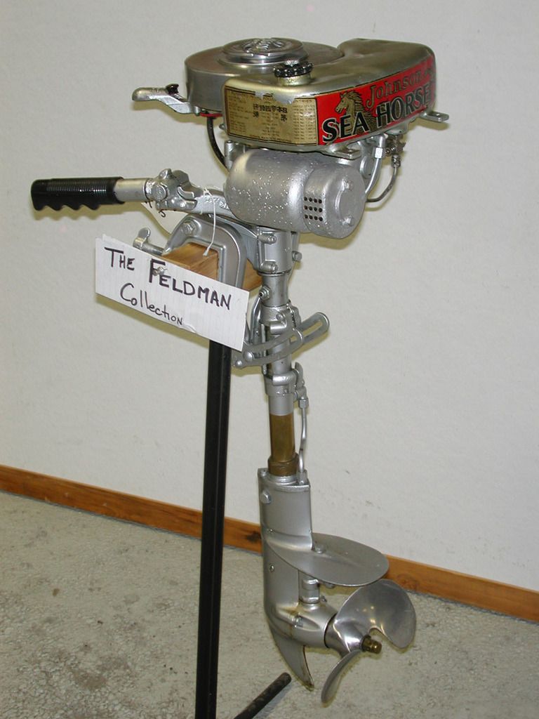

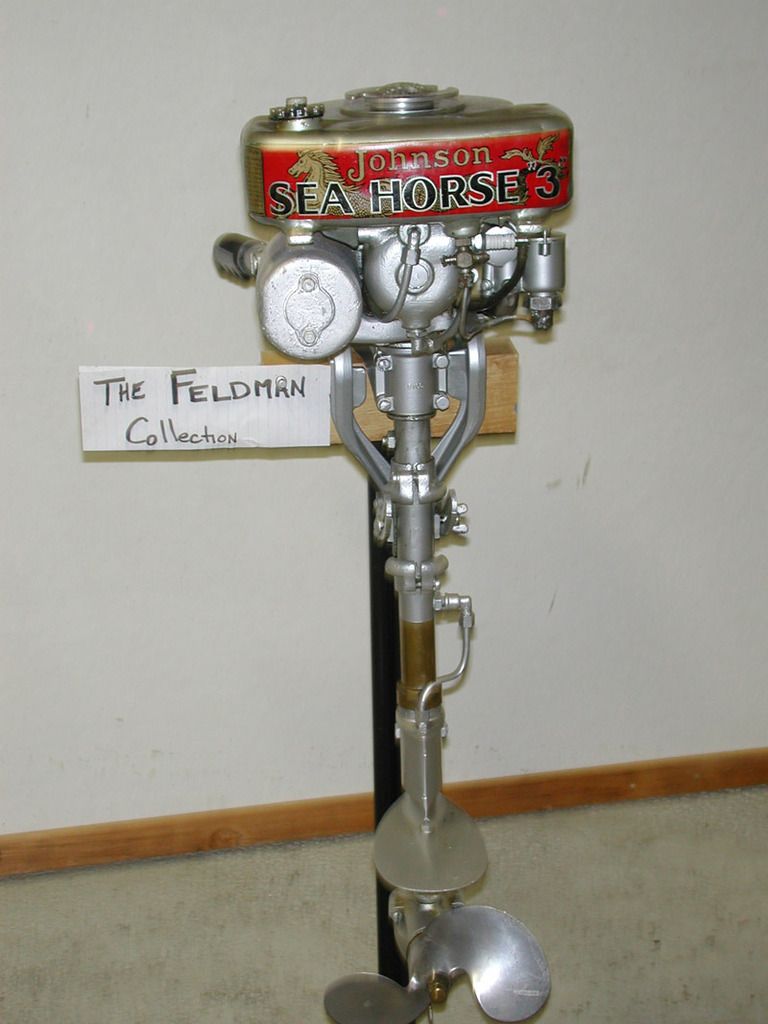

Here’s some pics of a J-75 I found somewhere to help you see what your muffler looked like originally. Notice the short tiller with what might be a bicycle grip on it. The tanks filler is also in a different position.

February 10, 2016 at 12:11 pm #31732Also note that the tiller grip in the previous picture provided is on a restored motor but the grip is not correct from the era. Also note that the parts to be painted are in the restoration guide on the club site.
