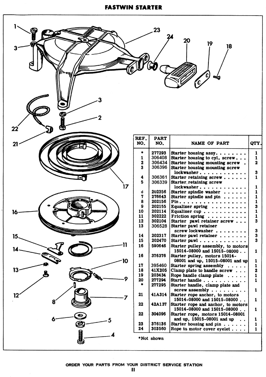

              The Flywheel and starter are different on your QD – the Evinrude is a ’56 – that year the starter changed. – this is the 1955 –
