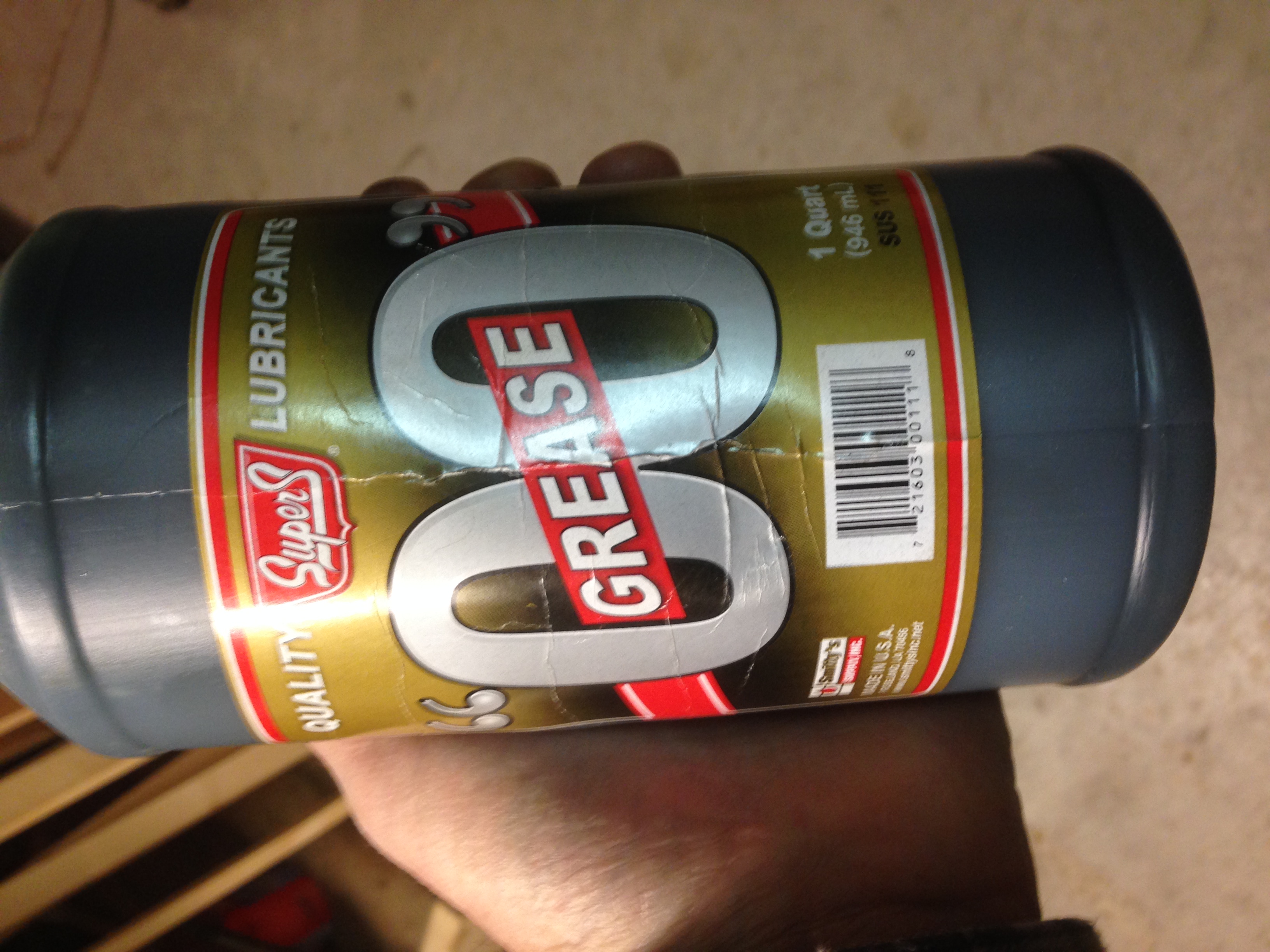

          Impeller is ordered. I started on the gear case. First one I’ve taken apart that is full of grease. Has grease written by the drain plug. So I guess grease goes back in. Any type of grease, or suggestions?
          #32161
            Outboard motor gear grease is no longer made by anybody. Most people use Lubriplate 105 "Motor Assembly Grease", available at NAPA Auto Parts Stores. It comes in a handy squeeze tube. Another popular lube is Corn Head Grease, available from John Deere dealers. Good stuff, but not as handy to get in the gearcase, as it comes in a standard grease gun cartridge.

              #32175
              david-bartlett
                quote fishingnuts:
                This is what I am using. I get it at Tractor Supply.
                #32189
                fishingnuts
                  I guess a trip to Tractor Supply. Wish I had one a little closer.
