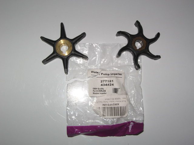

        Evinrude-6hp-5-impeller
        OK GC down… when I took out he GC -drive shaft …. found no ROLL pin below the upper brass cup…  I will try local hardware store
        water pump impeller looked fine   bent blades (nornal & flexible) so the last guy who worked on it likely destroyed the roll pin, just took
        it out or  just forgot to put it back  although removal was unnecessary
        pump housing got a good brushing small holes cleaned out… new China  impeller 277181 going in…same size   as the old one  strangely for China  it has  bigger brass core . should be ok …
        pump-purge-2
