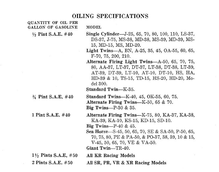

            For Johnson owners:
            #70987
