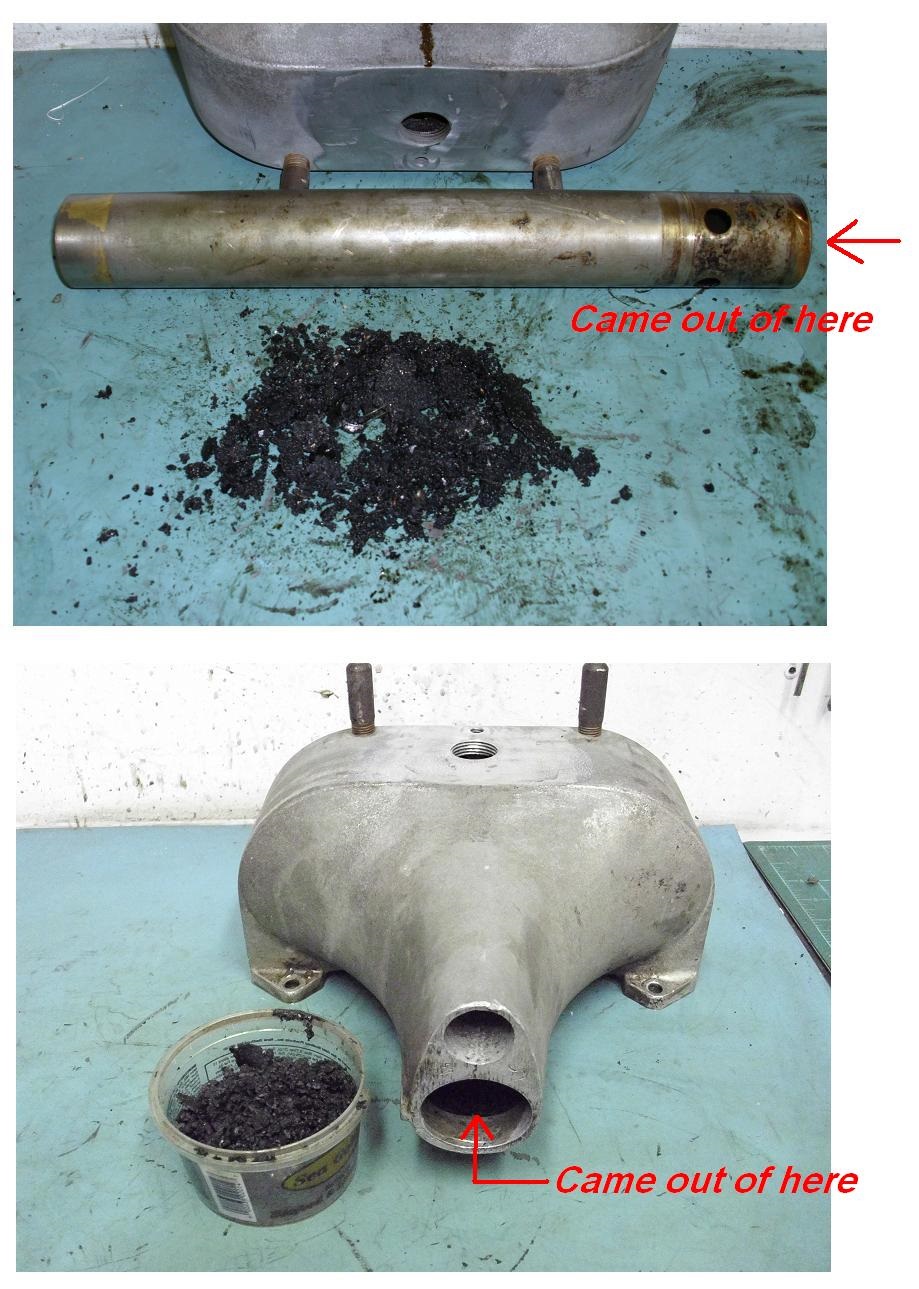

      Why is there detergent oil today? This is why?
      The junk non-detergent of the past is the reason these
      rings were stuck (video) and the motor was full of carbon.

      #71068
        See the holes in the upper end (on the right in the picture) of the exhaust pipe? When those get plugged, it causes hard starting. They should be open to the water outlet cavity. When the motor starts and the water jacket fills, the outlet water will (Is suposed to) quiet the noise. . . 😆
