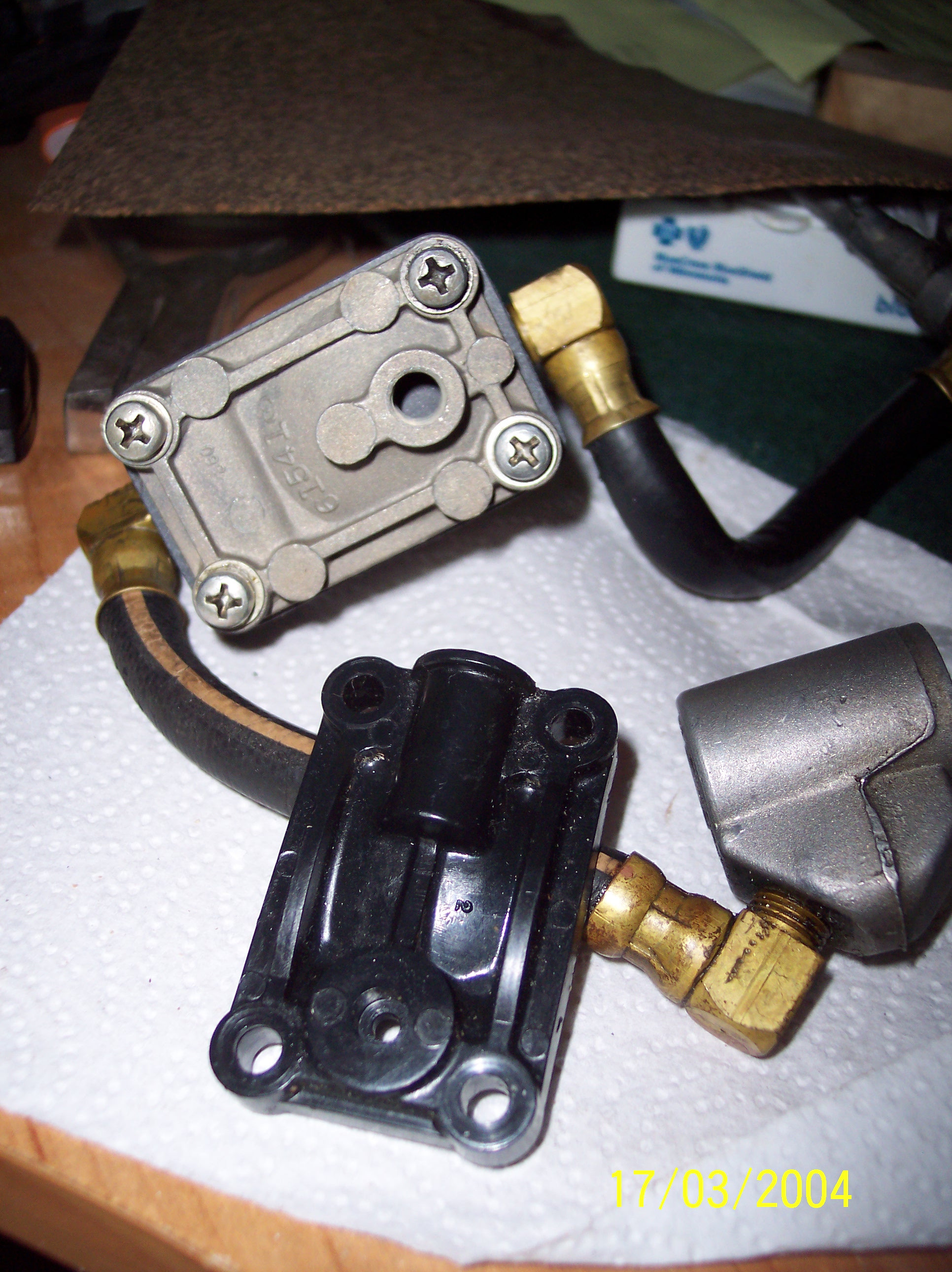

              Got the pump cover and gaskets but I have another question. As you see in the photo the original plastic cover has a vent port over the smaller part of the diaphragm. The cast replacement does not. Should I drill one in it? I’m thinking the cover went on a pump whose center section hard a port. Other than that it should run as the carb wasn’t dirty.
              #61392
              guzzi-john
                After seeing a drawing of the pump in Clymer 4-40hp 1964-75 I’m concluding a port is useless as the chamber that would receive pressure relief is the output side feeding the carb. Why would the pulse to the float chamber need buffering?
