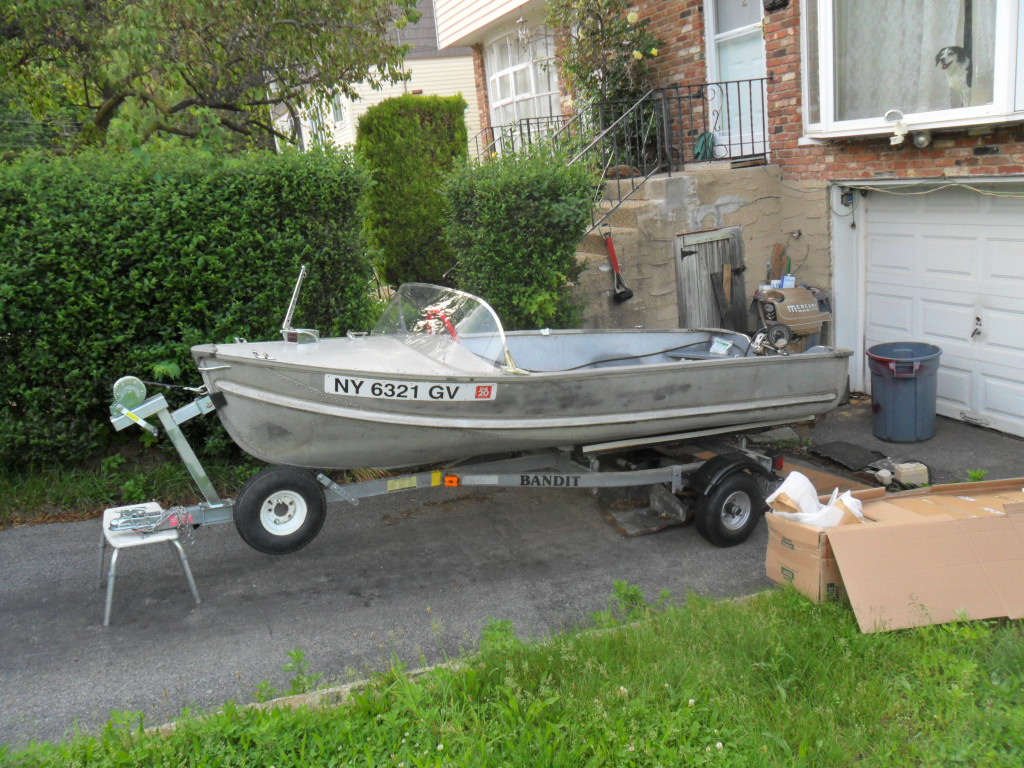

July 2, 2017 at 8:53 pm #60850I sold my canoe Old Town 174 (only used once in 10 yrs) and my sailboat O’Day Javelin last year(I wasn’t able to step mast myself safely-balance issues) which I dearly miss. So I’ll be hunting for a little trailer putter that an old fart can deal with. Lots of big old runabout being given away lately but no little rowboats. Lots of dead jet skis too-maybe I could graft a motor on one of those. Nah, I need to take grandkids for rides maybe even fish.
July 2, 2017 at 11:02 pm #60854July 2, 2017 at 11:35 pm #60856Nice, much better than the giant glass tri hull bass boat behemoths
