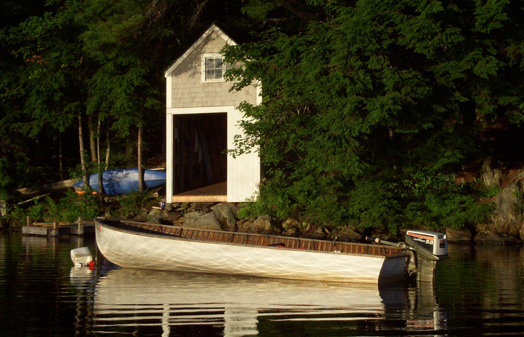

                    About 3 years ago Dick got rid of this 9.9
                    for a new brand new Mercury 9.9 four stroke.
                    He was really missing his Johnson putting
                    that heavy four stroke on to the boat last year.
                    He was really missing his Johnson after spending
                    2 days pulling on his new motor without getting
                    it to start. He was really missing his Johnson
                    getting the Merc off the boat and up to the
                    camp so he could put it in his car to take it
                    in to have it fixed. I don’t remember how long
                    long it took to get it back but I remember it was
                    over the 4th holiday. He was without a motor for
                    at least 7 days. I remember when he put coils in
                    the Johnson and an impeller. He also replaced
                    the throttle gear in the tiller. He always repaired
                    it the boat house and it wouldn’t need to be down
                    more than a day. I swear he went to town for gas
                    every other day when his boy was growing up. He
                    really misses his old Johnson when he gets teased
                    about if his Mercury is going to start today.
