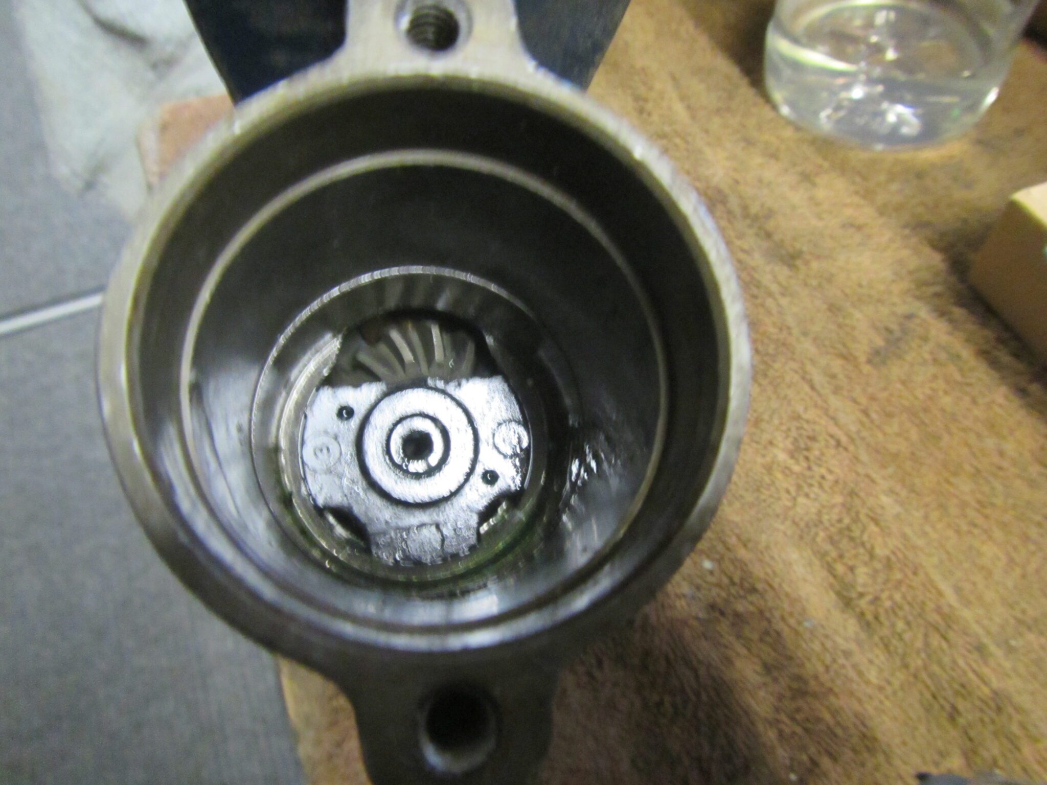

      Hi guys, How do you get the pinion gear out of the gear case on a 1952 Evinrude 3hp outboard?
      dale
      IMG_1223
      #267794
        To jar it loose, with the drive shaft removed, give the gearcase open end a whack on the workbench top.
        #267829
          The thrust bearing has to come out before the pinion gear will.  It’s that flat thing in there with the circle on it. Like FR says, give the gearcase a sharp rap to try and jar it loose. I have used long needle nose pliers to remove it but it’s made of breaklite or something and is rather fragile.
          #267837
          labrador-guy
            Well I rapped the snot out of it and it would not budge.  Since the housing is junk, the PO cut the tail off trying to make it a racer,  I slipped a punch in through the gear oil hole and got that black plastic thingy loose.  Another rap on the bench and it fell out.   I just wanted to save the gears for another go-around some day.
            thanks guys dale
            #270218
            LeeRoy Wisner
              What I do is tap the center hole with 1/4″ X 20 and then make a Ell shaped tool out of 1/4″ all thread.   this has to be at last 6 1/2″ to the handle (Ell) to clear.   Thread in into the tapped hole all the way & when it bottoms out in the front, it will push the thrust bearing out,
