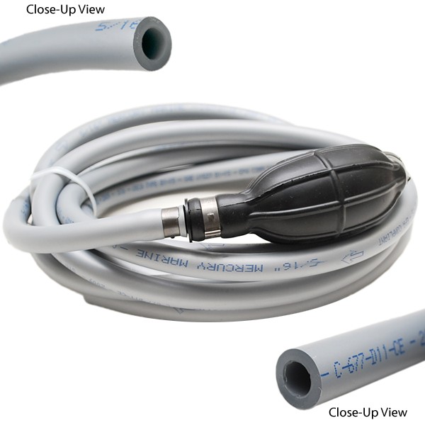

You at least need Coast Guard approved type A1 for above deck outboard fuel line. The new stuff (B15) has the internal vapor barrier lining. The new hose is a royal pain IMO, because the barrier lining can come loose and partially or completely obstruct fuel flow. If you don’t get Quicksilver or BRP hose, and decide to go to Wal Mart, for example, your’ throwing your money away! Some dealers stock and sell the new B15 hose in bulk, so I would go that route. As far as using the old black Gates or Dayco hose, it will work just fine,

Having said all of that, I have had good luck with, and use the Quicksilver type (B15) silver colored hose. I have put it on a gazillion of my customers boats, year after year with no issues. I’ve replaced a truck load of Wal mart, Sierra (the worst IMO) and other aftermarket hoses with the Quicksilver stuff. Be sure your Quicksilver hose has the BLUE print on it. If you find some of the old hose with RED print, don’t use it! That stuff WILL fall apart on the inside, and cause major headaches. I’m not sure if i’ts the modern fuel that does this, or just the age of the hose? At any rate, it should be discarded and replaced.
November 5, 2017 at 3:19 pm #67055OK, I will take this as authoritative. What’s the part number for buying it in bulk and how much does it cost. Do you use this under the hood also? There is some for sale on ebay for $4.50/foot under this mart number: 32-8M0038500, which is listed as the part number for a 100 ft role in this bulletin: http://www.marinepartsexpress.com/Merc_ … 008-11.pdf, but without the 32- prefix.
November 5, 2017 at 4:03 pm #67056The 5/16 ID fuel line is part # 32-8m0038500. Current list price is $265.00 per 100 ft. roll.. I would think $3.00 a foot would be reasonable?

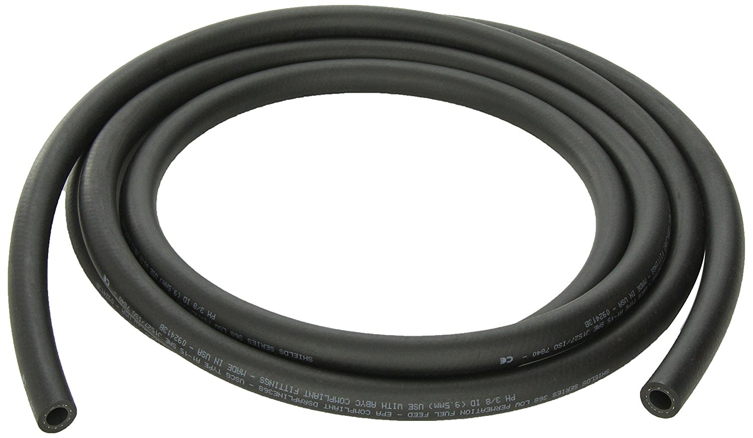

With regards to your Crestliner, I would suggest using Shields fuel supply hose, the same stuff used in I/O or Stern drive/inboard applications. Run it up to a barb that mounts say, through the splash well of the boat. On the other end is another barb to hook a standard fuel line to. many bass boats are set up this way. That stuff lasts forever, and has all the appropriate coast guard specs for enclosed areas. if you have an O’reilly store in your area, they should have it.November 7, 2017 at 3:13 am #67109Yes, the permeation thing is about reducing VOC emissions. But somebody mentioned fire hazard and it got me to wondering if that could be an issue.
I found some Shields hose when looking for the Merc stuff, but it was different from the picture here. It would be a lot easier to install than metal tube, no worry about fatigue and corrosion….
