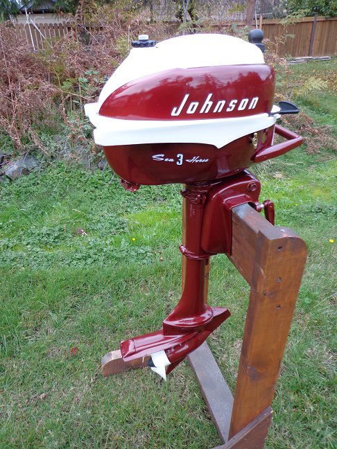

October 2, 2024 at 2:28 pm #291284So beautiful, wish I possessed these skills

October 6, 2024 at 2:55 pm #291375The pics of the motors are gorgeous!

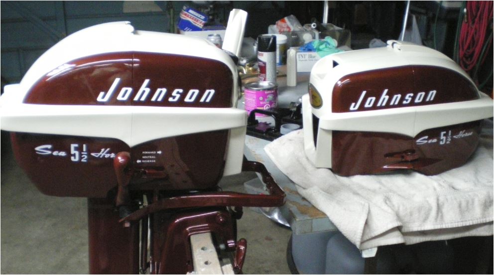

1958 Johnson 5.5 Hp, CD-15October 6, 2024 at 10:05 pm #291379I’ve used Rustoleum rattle cans on a couple of motors. It doesn’t produce a super high gloss finish like you would get with a spray rig and high quality automotive paint and clear coat but they are good enough for me. See pics.

October 7, 2024 at 9:50 am #291390Those motors turned out really nice despite not being super shiny. Do you recall if you used Rustoleum Burgundy and Almond colors on the FD-12?
