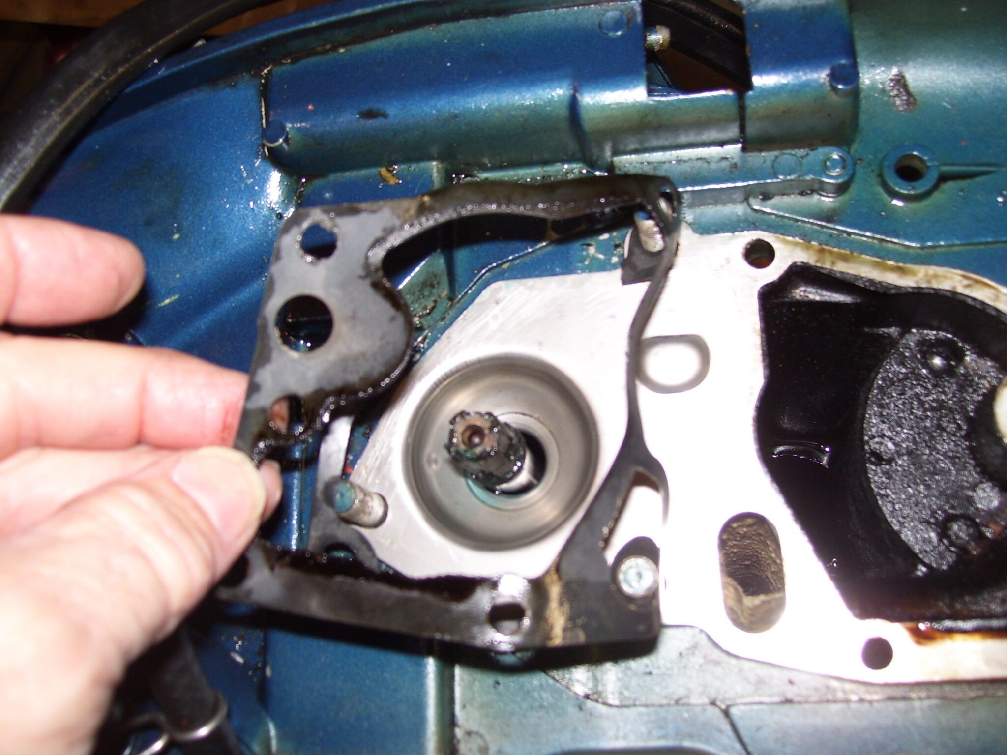

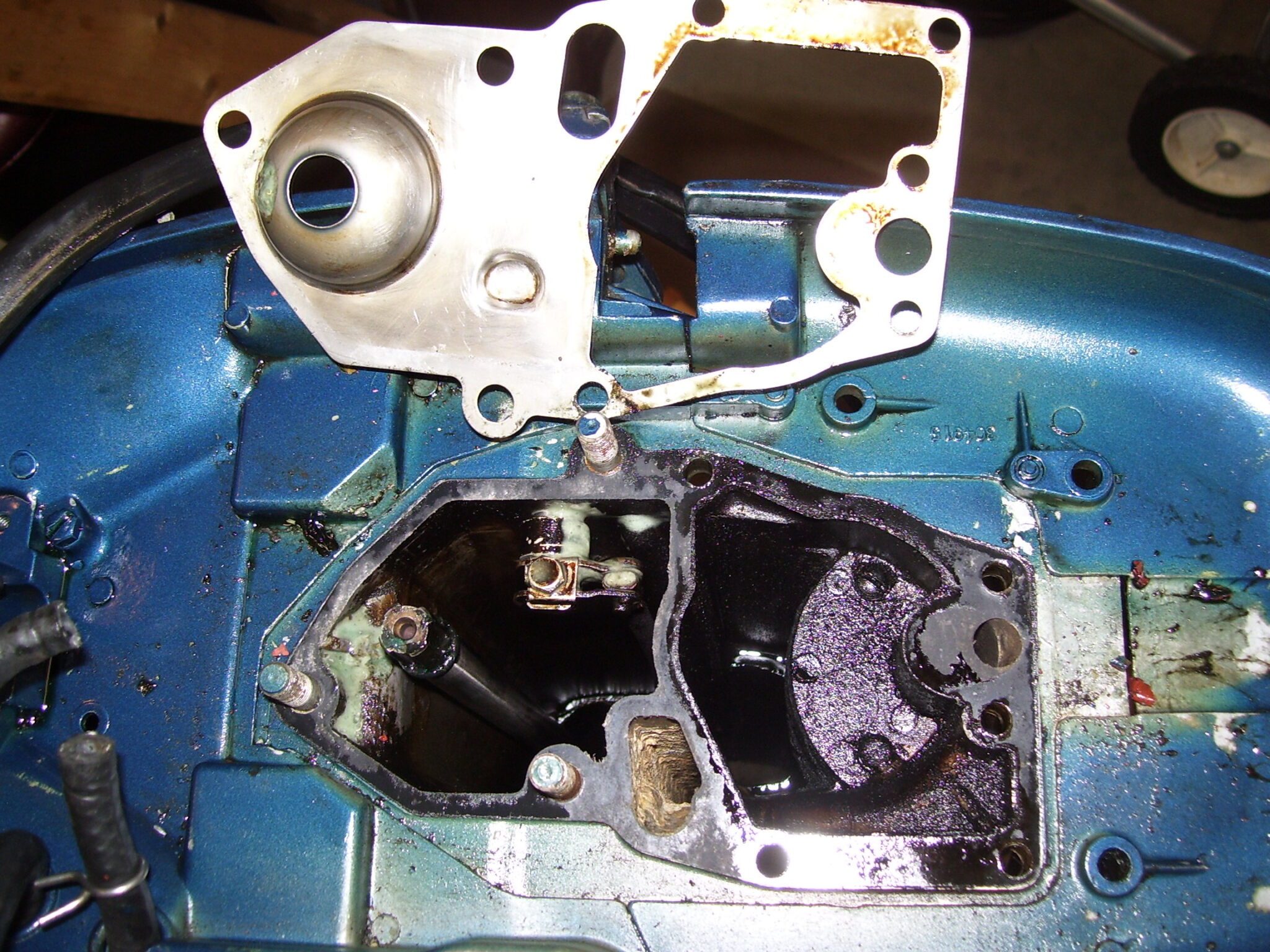

1958 Johnson 5.5 Hp, CD-15October 15, 2024 at 12:45 pm #291521FWIW last spring I put the exhaust on a 1958 Evinrude together with two thin gaskets and the baffle plate, no sealer. Result was black goop from the exhaust leaking into the bottom tray of the powerhead. See photo. Looks like the thin gaskets were leaking. I will replace the gaskets and this time use E/J/ BRP part number 508235 sealant.
October 16, 2024 at 12:46 pm #291558In the picture I posted previously, I applied Permatex #3 Aviation gasket sealer to the powerhead base gaskets.
