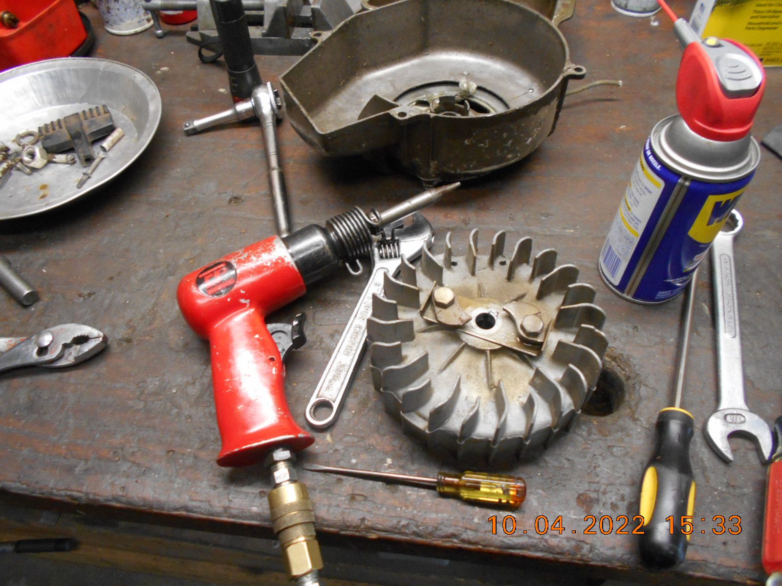

                    Yesterday I tried the air hammer method to remove a flywheel,
                    as I had the perfect motor to try it out on. An air-cooled Clinton
                    outboard of no great monetary or sentimental value!
                    Note that the flywheel nut wasn’t super tight, but the flywheel
                    was not loose on the crankshaft taper. I never even had the
                    cowling off this motor since I owned it the last 8 years perhaps.
                    I pried on one side of the flywheel with a big screw driver.
                    Had I had three hands, I would have used two screw drivers.
                    Long story short, when I pulled the air hammer trigger, the
                    flywheel popped loose in a millisecond!
                    Try this method at your own risk…… I’ll keep using my OMC
                    puller on anything I cherish!
