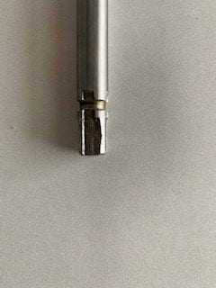

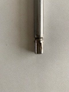

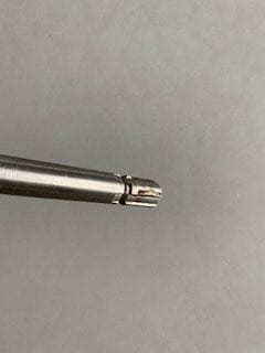

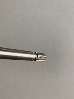

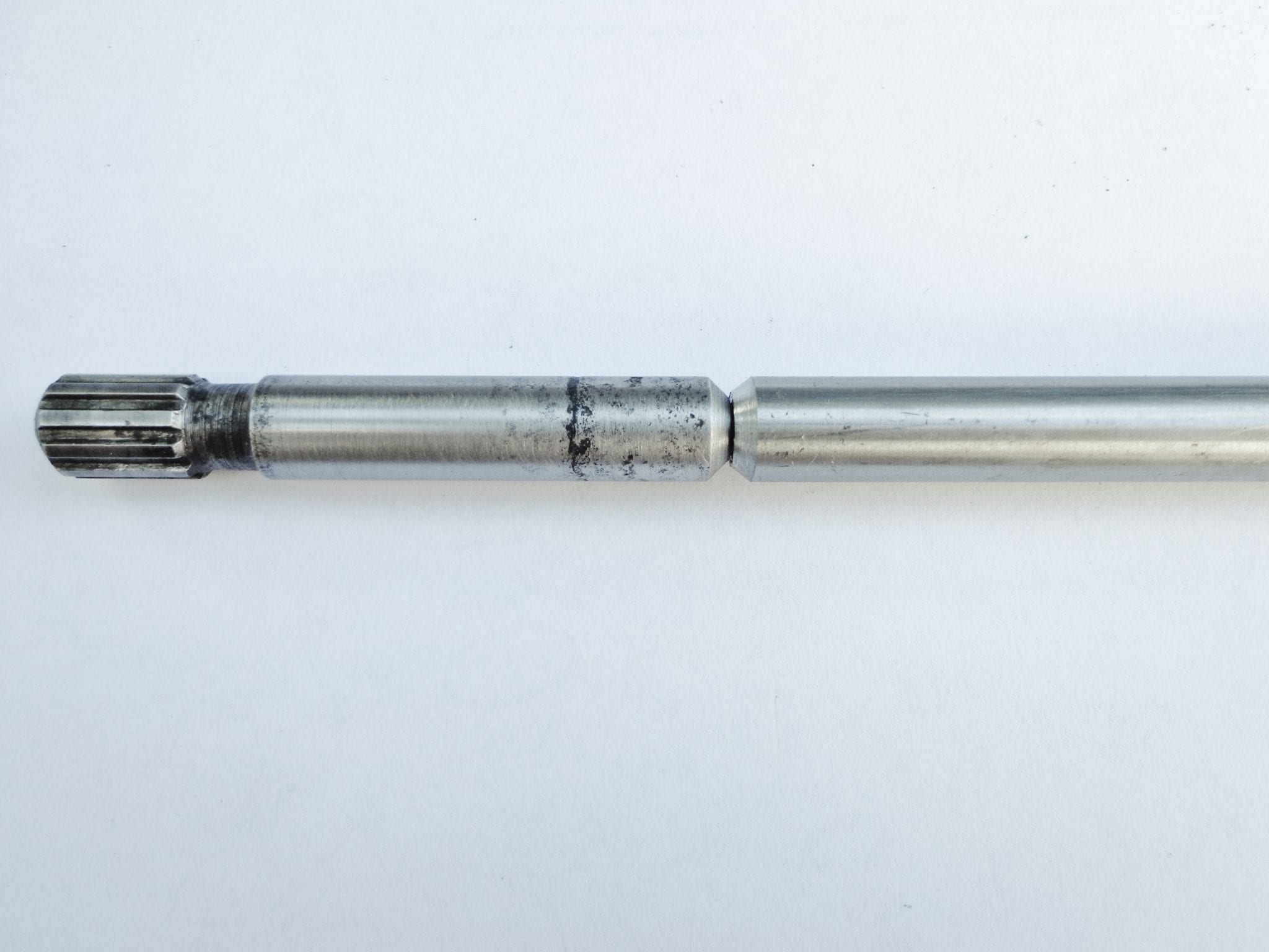

      Looking for some thoughts as to what to do with this driveshaft before bundling up the lower end and waiting for soft water to give it a go behind a boat. This motor runs in a tank. Upper 60’s compression, and great spark. Pictures are representative. All four splines have the same damage. The rest of the shaft is in good shape.
      Repair (not sure of cost)?
      Replace (looked high and low for a used shaft with no luck so far, cost unknown)?
      Use as is (will probably work OK on shakeout cruise and fail when on the middle of a big water with a big storm coming!)
      I have not taken the powerhead off to look for any damage in the business end of the power train, and probably should, but just trying to get my lower end back together to test it out before I put too much more effort in.
      Penny for your thoughts?

        took how many years to wear that far. how many left? I would use John Deer corn head grease and a O ring and be done with it.
        can it be flipped over ???????

            It’s almost a guarantee that the crankshaft spines are in worse condition. Damage was caused by water getting into splines and rusting the ones in crankshaft. Lesson to be learned. Never leave tho oring out.
            #188599
              Like Frank says, the crank is probably in similar condition.. Does this engine get a lot of use? If not, I would look for a decent used driveshaft, use the OMC moly lube liberally and replace the oring. I would probably pull the gearcase yearly to inspect the splines.
              Before installing the new driveshaft in the gearcase, you may want to lube it with WD40 and ram it in and out of the crankshaft splines to clean out remaining rust. Then, I would lube the upper driveshaft splines liberally with moly lube and ram it in and out of the crank splines…Do this a few times to get at much grease into the crank splines as possible. Once the gearcase is reassembled, clean and lube the splines once again before gearcase installation…

                Are you able to do any braising? I have one around here that looked like that. I put some brass on the wear spots and filed it smooth. It will last as long as I do!

                  I see a few “parts motors” for sale cheap here and there. Maybe you will get luck and find one for 30 bucks. I’d find out what motors that part will cross reference to, and expand your search.

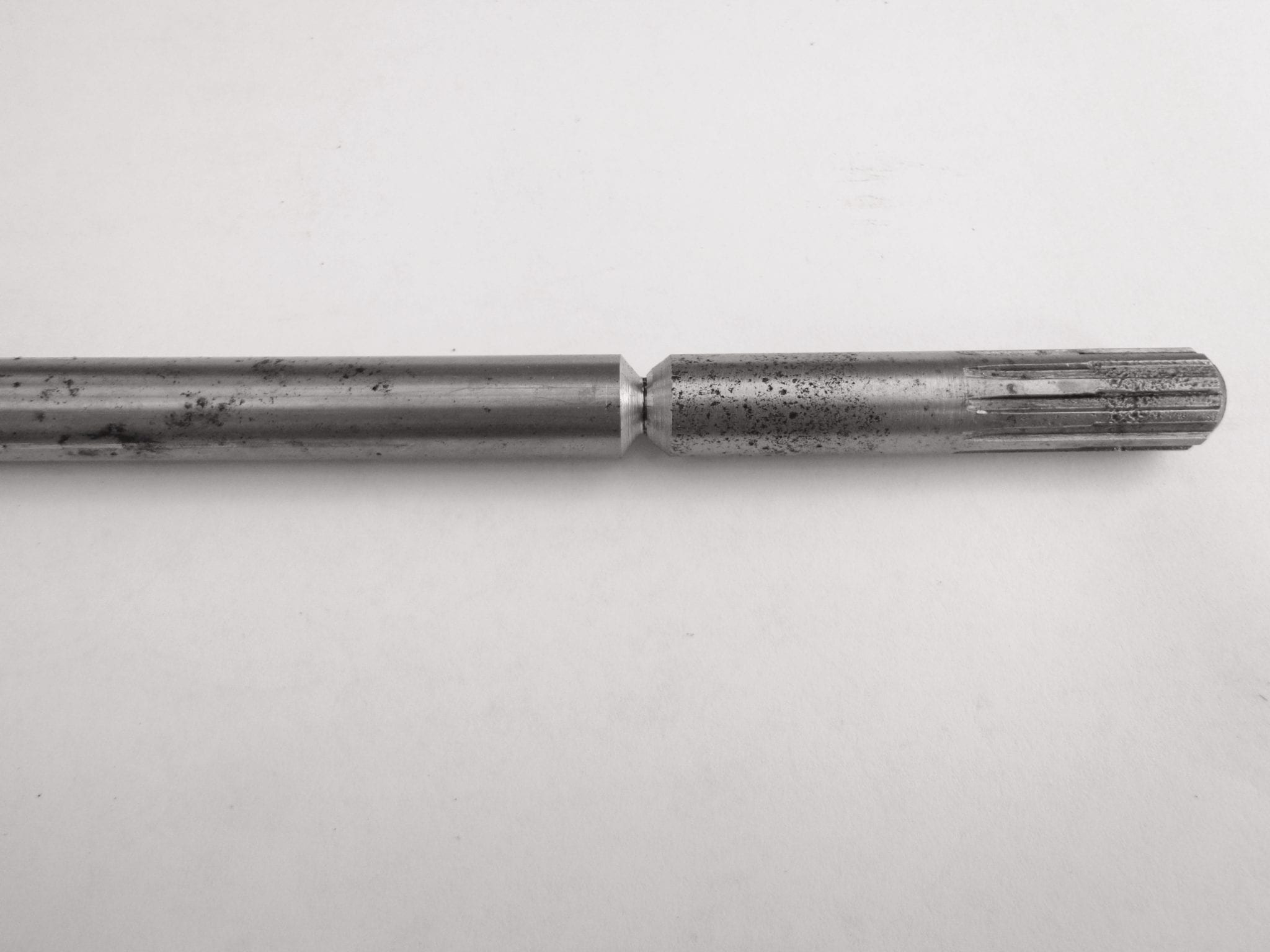

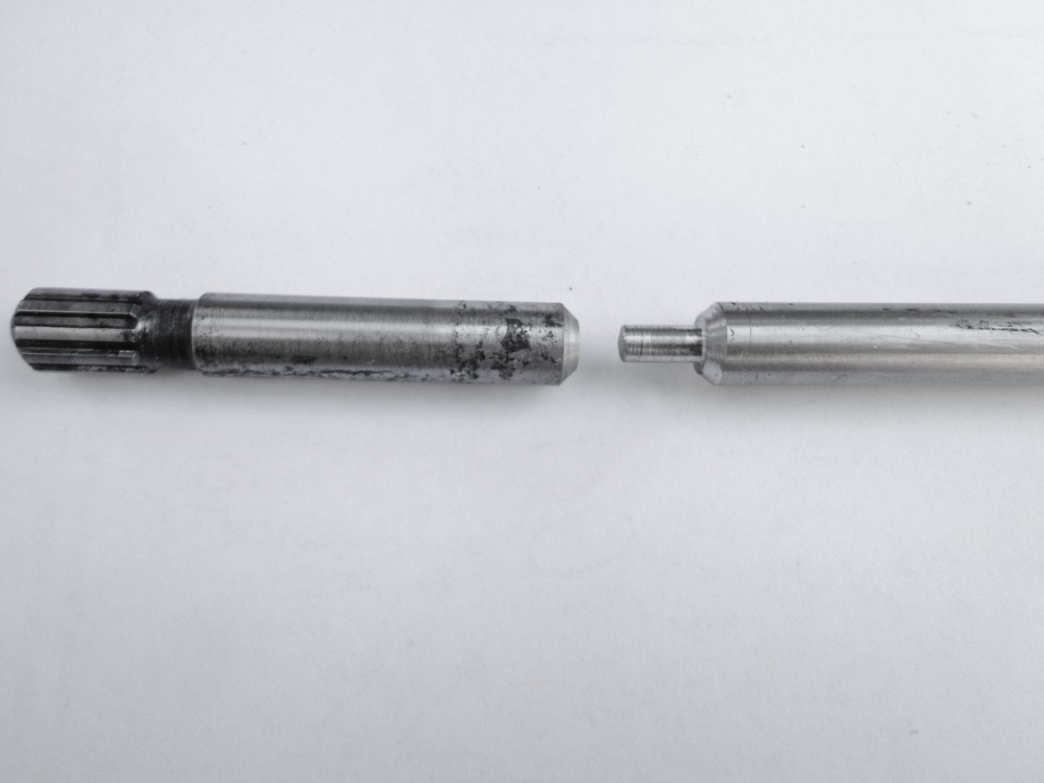

                        A motor with worn splines will usually rattle when it’s idling and the noise can be confused with piston slap.
                        If you have a bad shaft with good splines on it, the splined end can be cut off and grafted to the good shaft with bad splines.
