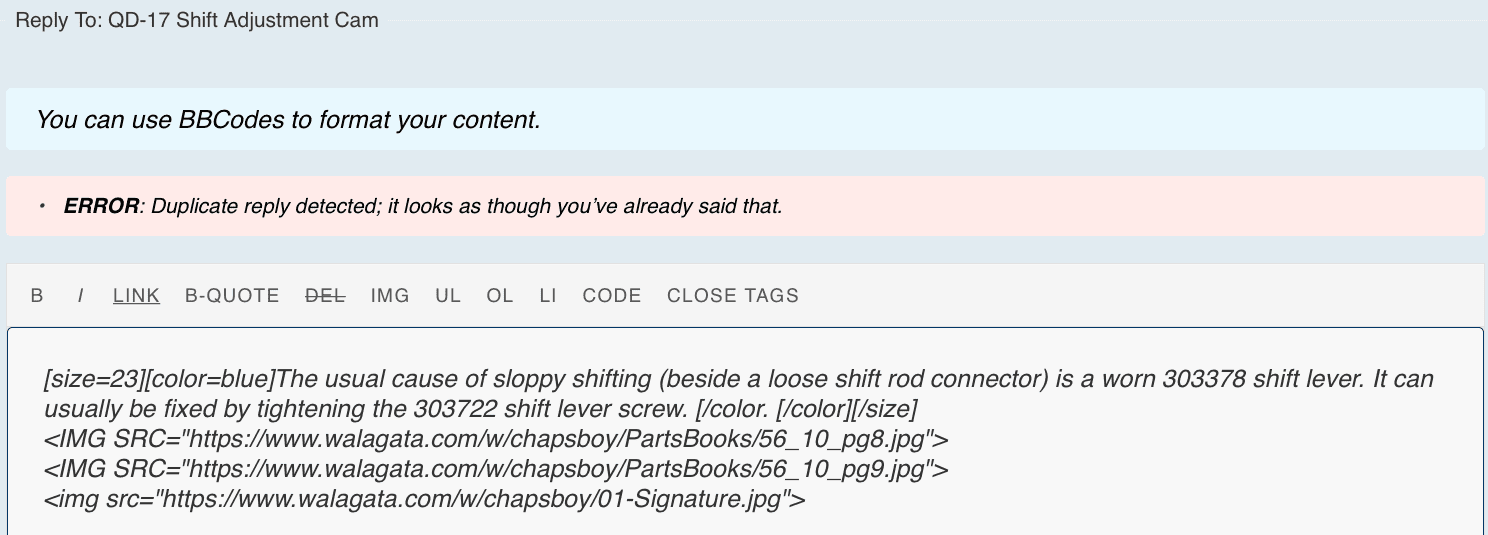

          #191150
            I shouldn’t have tried to correct my typing error – my re-try disappeared. I will try again . . .
