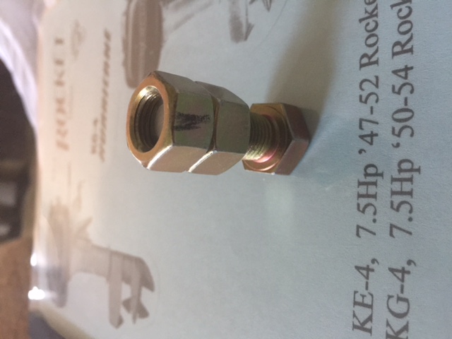

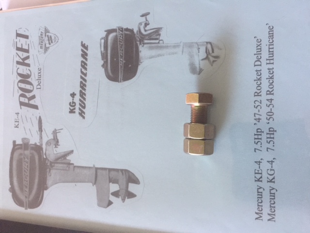

              I used Tub’s Idea because I have used that before. No nut welding for the guy’s that don’t have a welder, just take a couple of minutes and sand the end of the bolt smooth and 90* to the bolt. Buy yourself ‘Grade 8’ items bolt and nuts, one 1/2 fine tread bolt and two fine thread nuts. I screwed one nut up onto the bolt and the other only 3 1/2 turns then tighten the nuts with two wrenches. Screw it onto the crank and just snug it up……smack with hammer flywheel comes right off the taper. I used a 1.5 lb hammer if you have to hit it again stop and make sure the bolt is still tight before you strike it each time. That way you will not hurt the crankshaft threads.
              IMG_1972.JPG[/attachment
              Worked perfect
