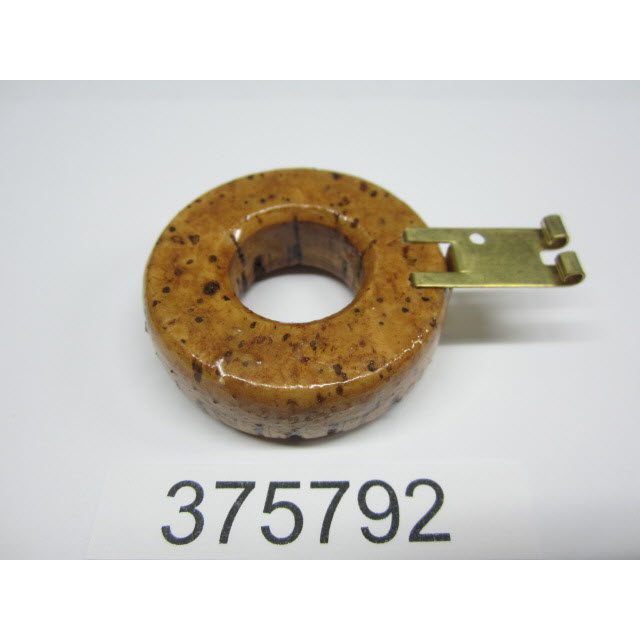

                    I use this float in RD-17s
                    Is there a plastic alternative to the cork.??????
                    Without filing and sanding
                    0375792
                    #272322
                      #272323
                        The coating on the 375792 is supposed to be a fuel-proof material, albeit the same part number, and is not the old orange shellac that was used years ago.  Alcohol eats shellac for lunch.
