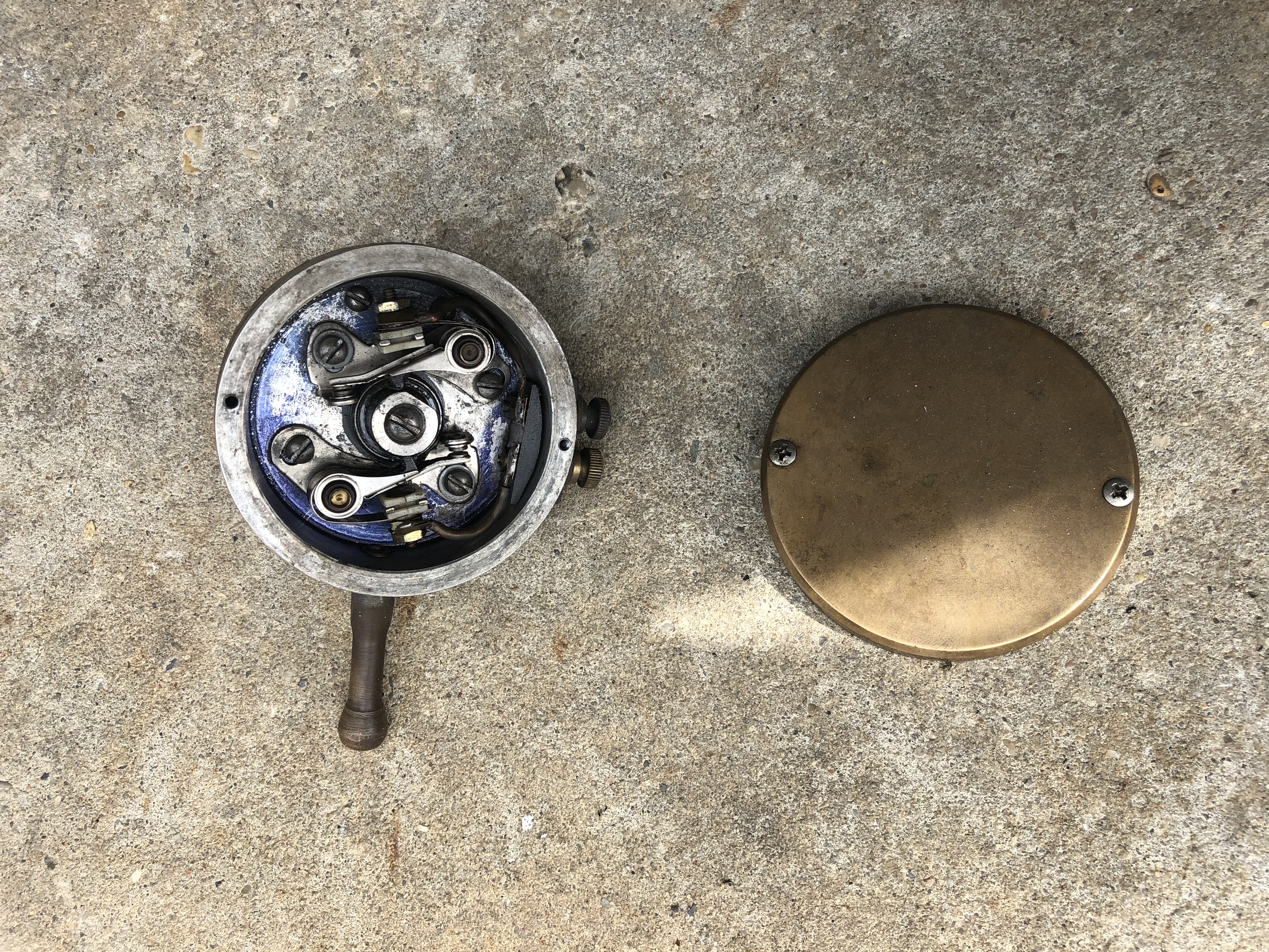

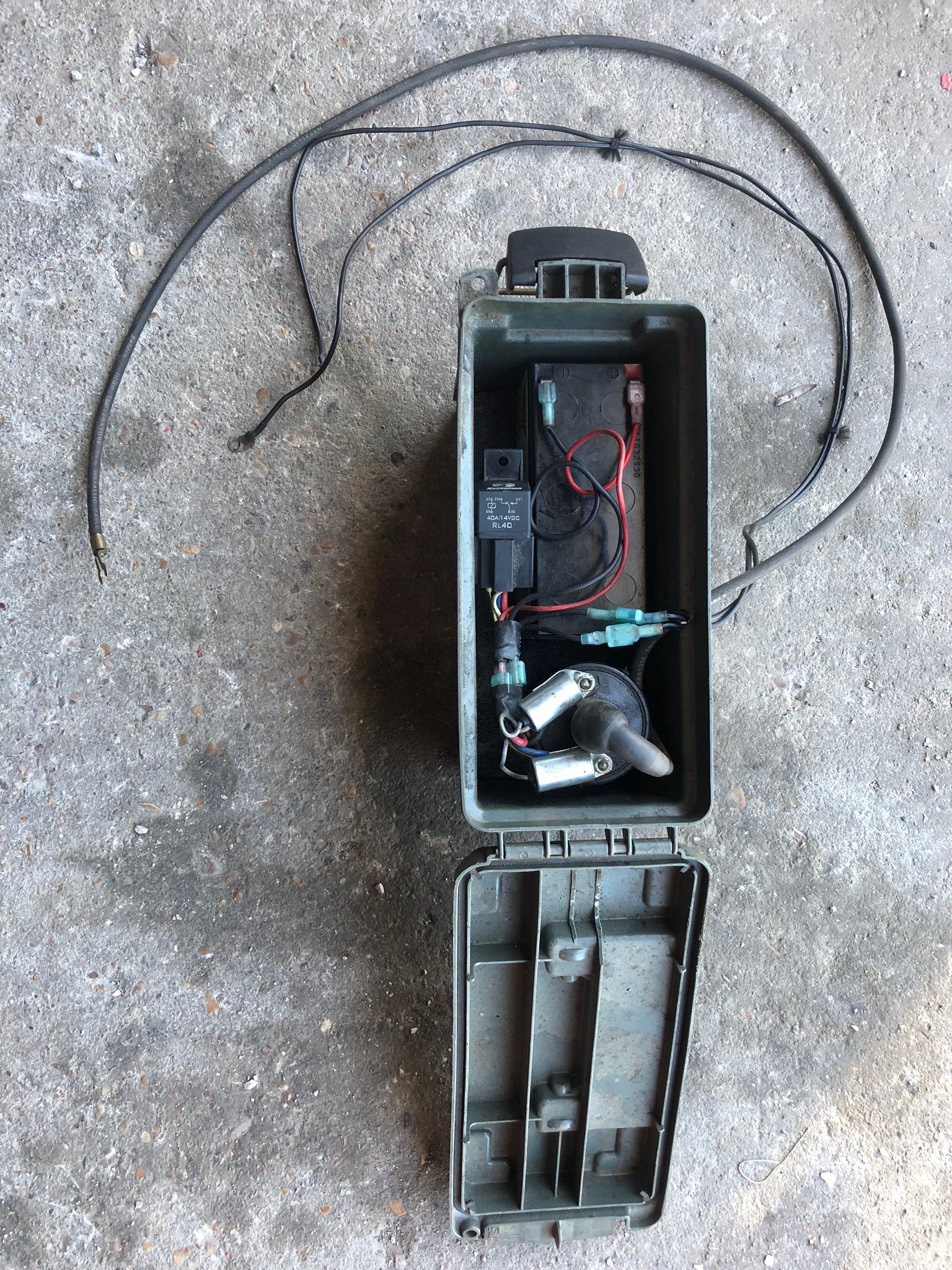

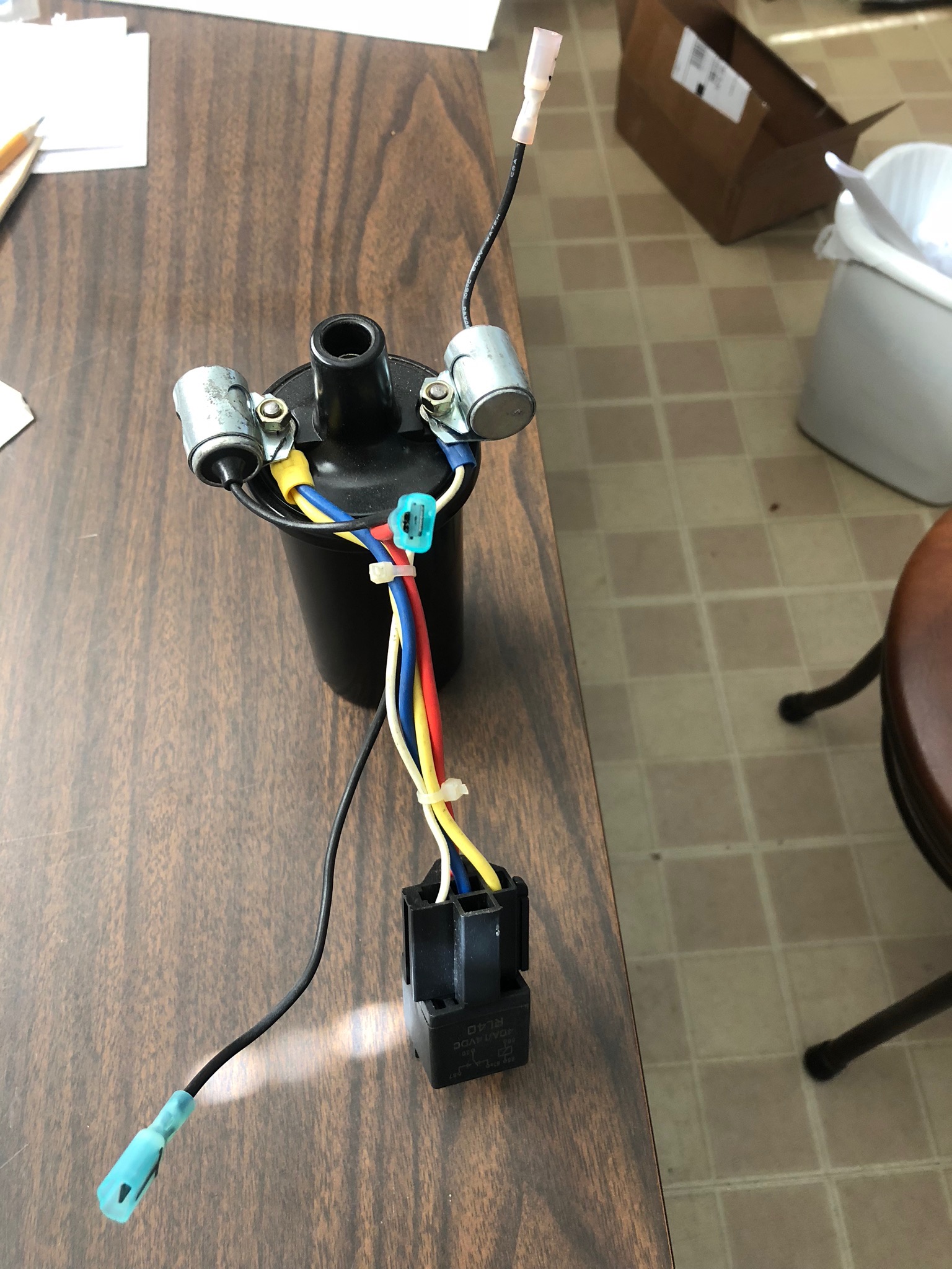

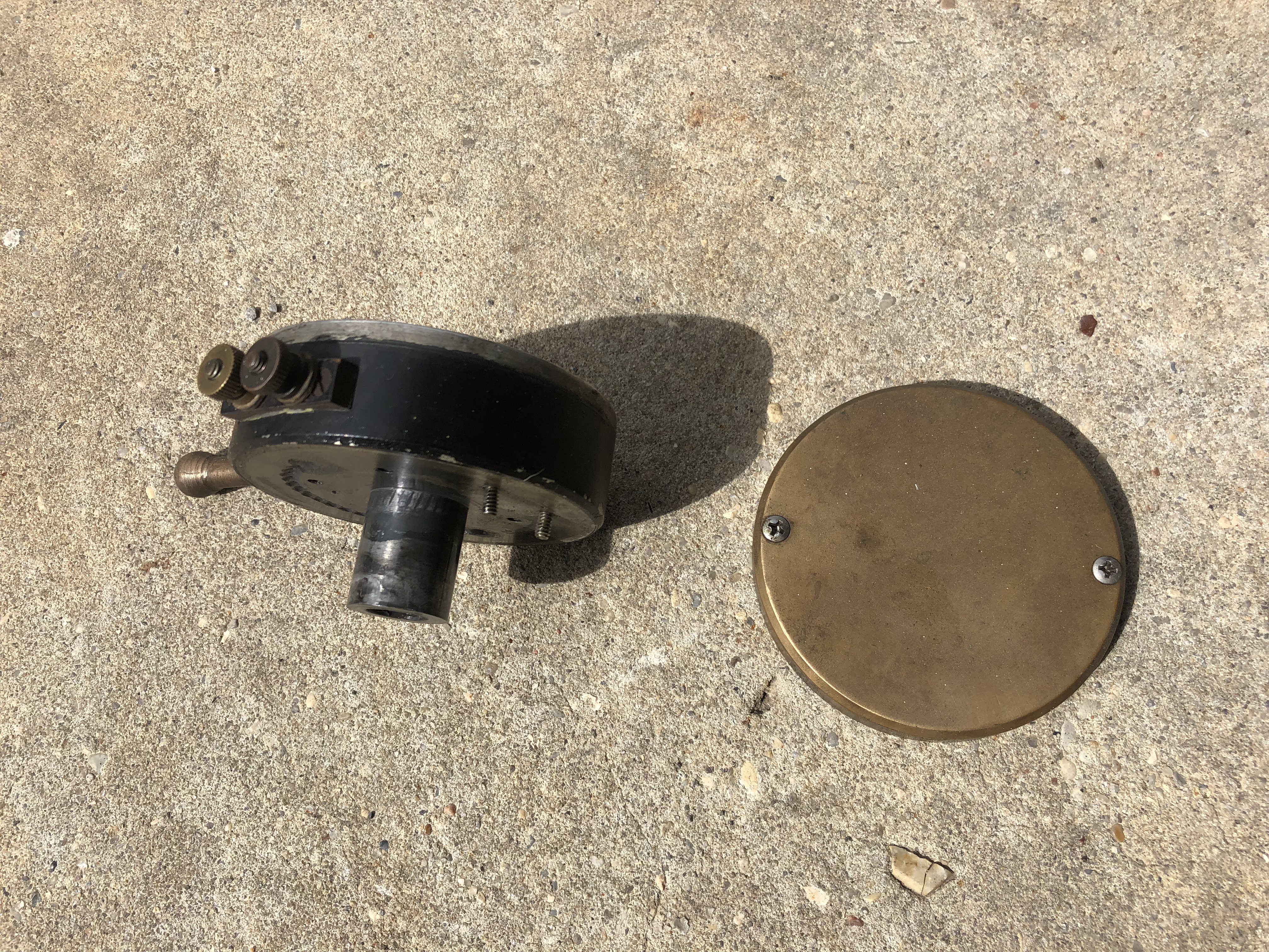

Attached are some links to buzz coil options and pics of my set up which is a JB coil.

That Lockwood type of timer you show intrigues me. Your drawing
gives me a general idea on how to make the timer handle
swivel. I would have to figure out some "stops" to limit travel,
and some way to tension the advance so it didn’t wander.
Again, Thanks for all the help!quote JimParrott:Buccaneer,Attached are some links to buzz coil options and pics of my set up which is a JB coil.
http://www.pfs-ware.com/rbmj/pdf/RBMJ_V2_I1.pdf
http://www.oldmarineengine.com/discus/m … /3079.html

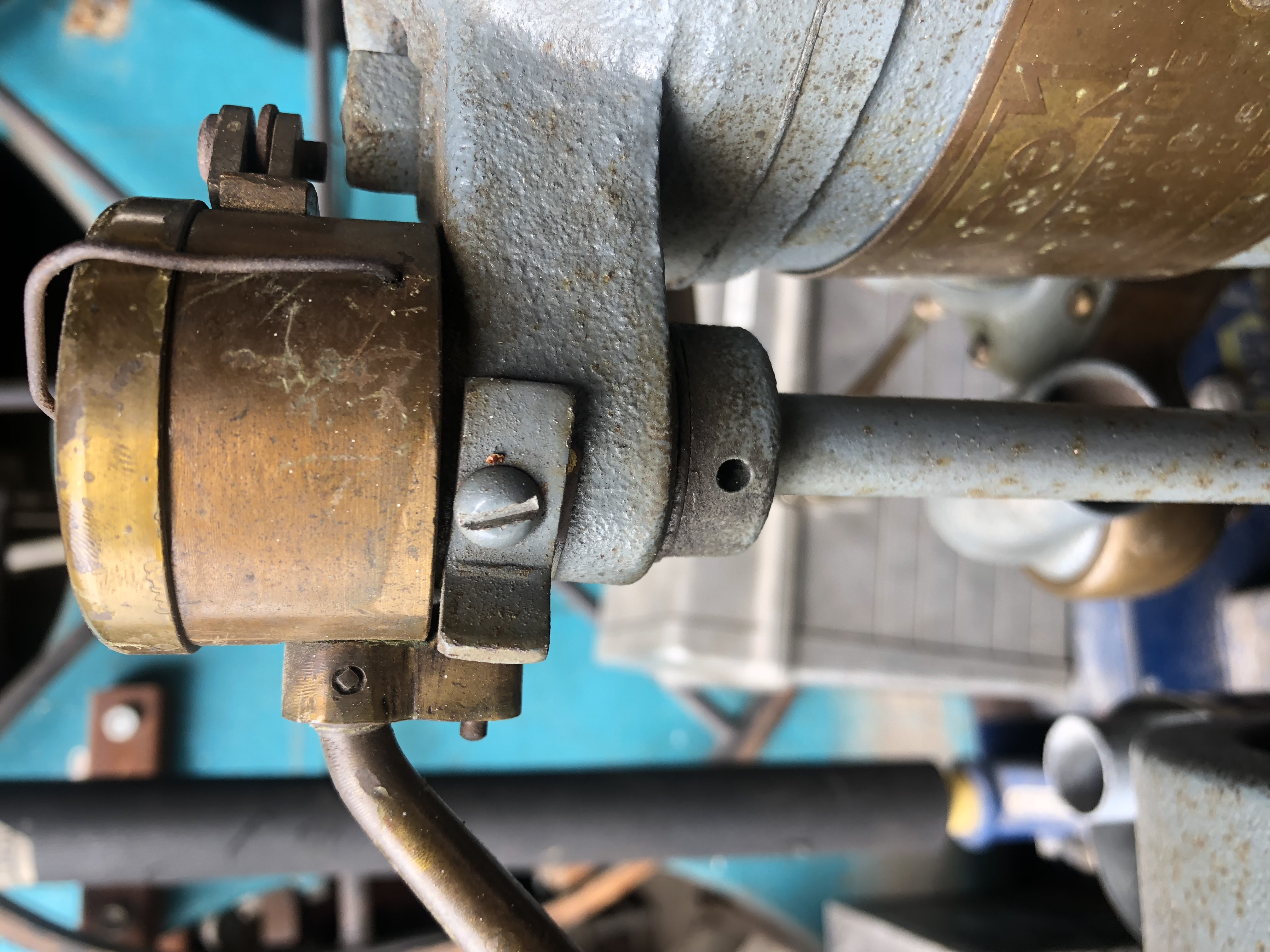

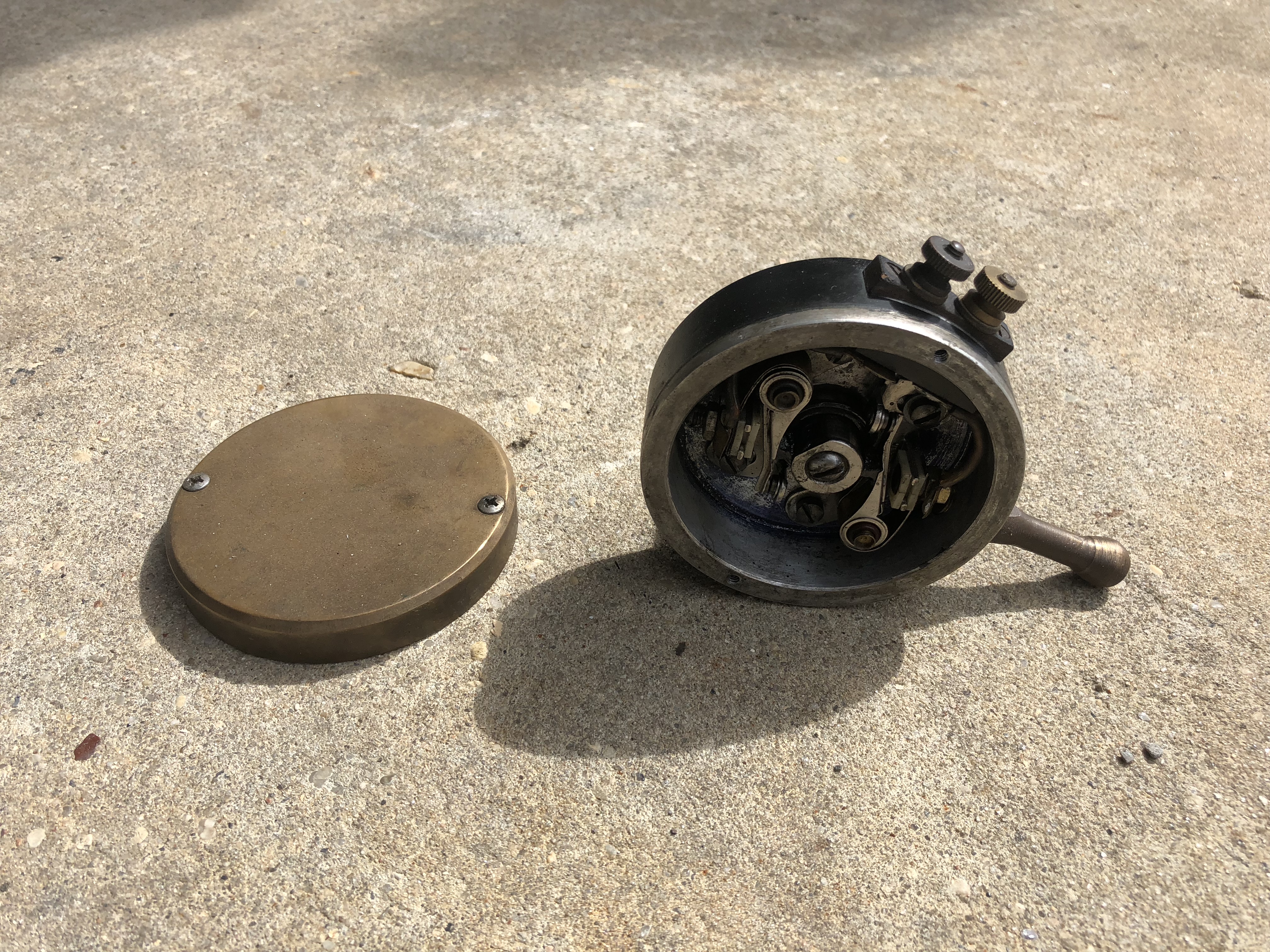

October 20, 2018 at 7:36 pm #84709Buccaneer,
You could split the mount on the top and add a screw to tighten the gap, or just add a nylon tipped set screw. I do have the blueprint drawings for the Lockwood timers if you need them. The Lockwood timer has stop pins that stick out the bottom and hit the upper timer mount. Below is a picture of a homemade timer for a two cylinder Lockwood. Also a bottom view of the Ferro timer.
FYI, I checked my Ferro RBM, it has a Bosch Magneto but doesn’t fire in both directions. I think it could probably be set up to fire in the opposite direction with changing the internal timing. These motors don’t really need reverse.

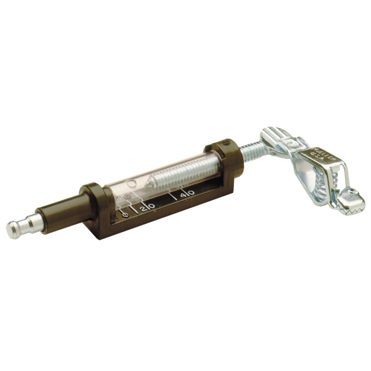

Your problem can only be one of three things; spark, gas or compression. I suspect spark and I would ask how you are testing it. Generally you would want to verify that your spark can jump a nice healthy gap….maybe twice or even three times the 0.35" gap at the plug. This is best done with a spark tester like this one:
If you have good spark with this test I would then remove the plugs and squirt a bit of pre-mix directly into the cylinders and try starting again. You can also inject pre-mix in the throat of the carb. You might have to remove the silencer part up front to do that.
