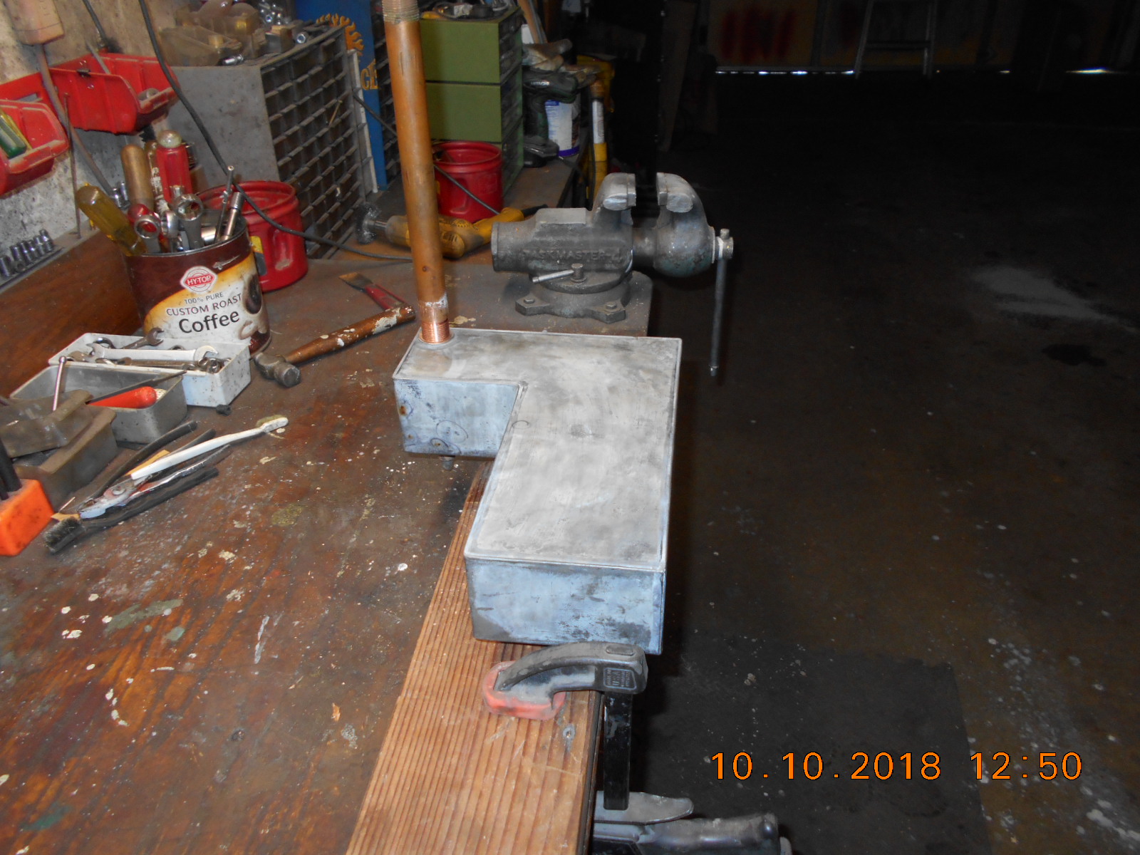

        Richard, I wanted to seal the pin holes so the phosphoric acid would stay in the
        tank long enough to clean the insides out! Only the little filler cap in the
        corner to look into the tank, so no good way to inspect the sides of the
        tank as a whole. I like the "idea" of un-soldering the top of the tank, but
        not the potential for screwing it up!

          I would lay off of the acid treatment, and preserve the steel that’s left. POR makes "Marine Clean" solvent that will clean the tank better than anything else, and will not eat up the metal. Redkote will seal up the remaining rust.
          #84240
          dmbono
            The existing solder joint looks good, I wouldn’t mess with it.

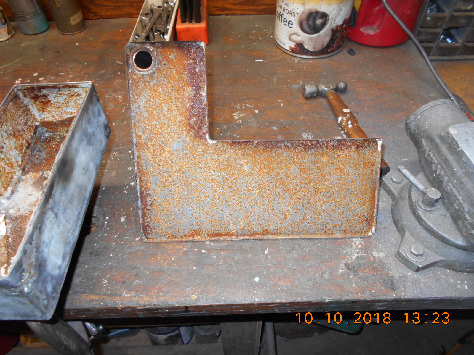

                Tubs, thanks for the tips and video! Looks like your
                tank turned out pretty nice.

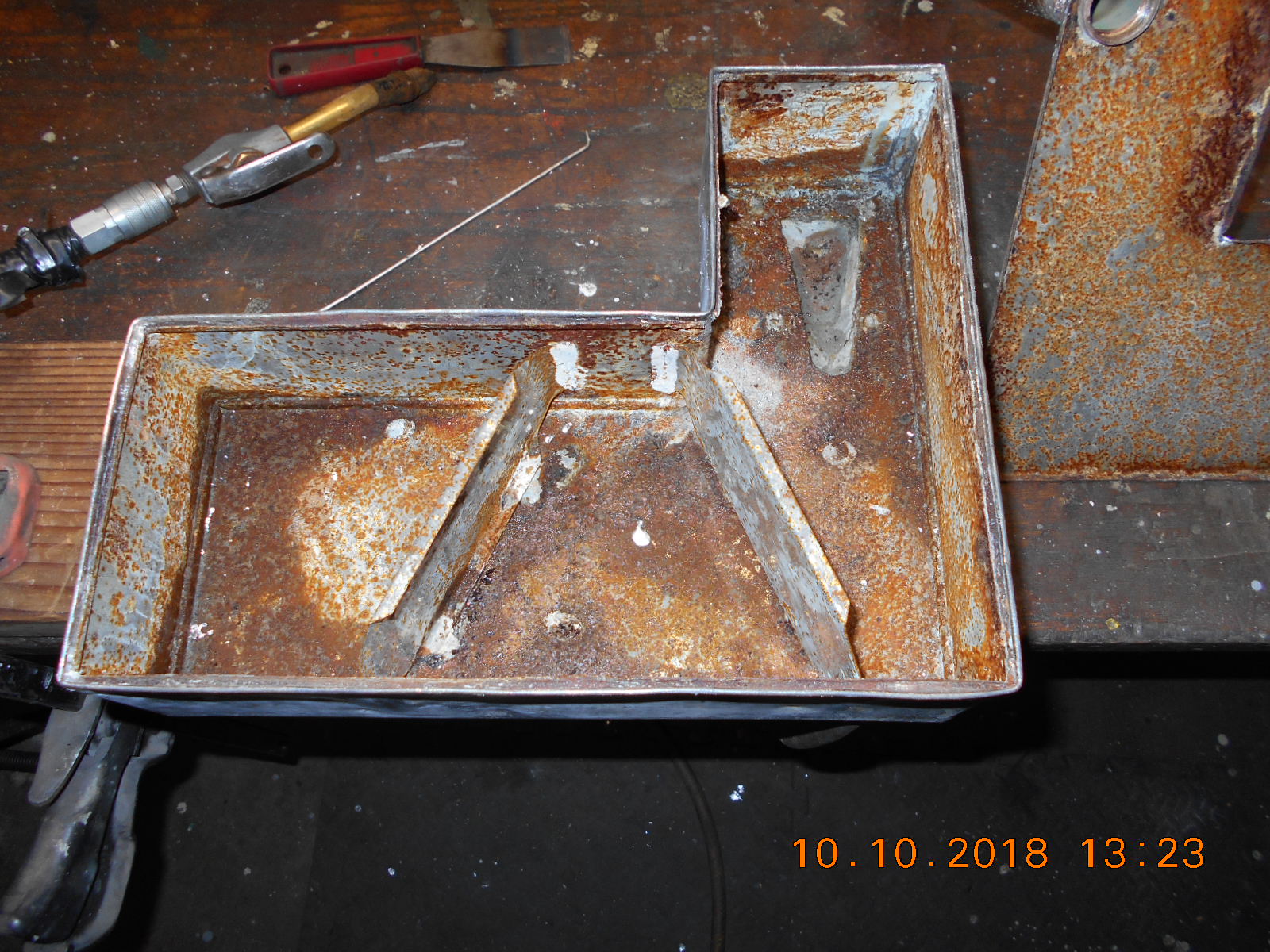

                I decided this morning to try to remove the top so
                I can thoroughly inspect and clean out the inside.
                I turned some 14 tpi threads on some 1" pipe to
                screw into the filler cap hole, so I’d have a little
                leverage to lift up on the cover. Am going to try
                after a while, so wish me luck!
                Thanks.

                  Take pics of what you find inside!
                  #84260
                    Tubs, your idea of blowing the liquid solder out with compressed air
                    worked great… Thanks!
                    I’m glad I opened it up, don’t think I’d ever get all that rust and crud out
                    otherwise.
                    Now, if I can sandblast the insides without warping the tin is the
                    next question. Will try tomorrow…… too many interruptions today.

                      Do you have a soda blaster? Less abrasive and less heat.
                      #84268
                        Most persons run their blasters at too high of a pressure thinking it is better..it is not…
