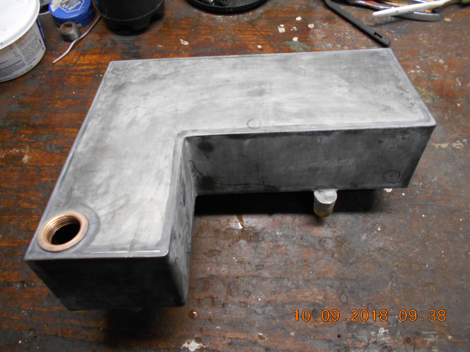

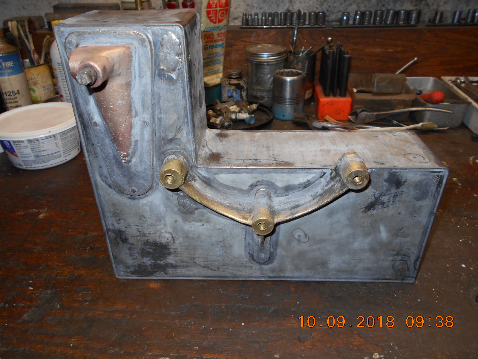

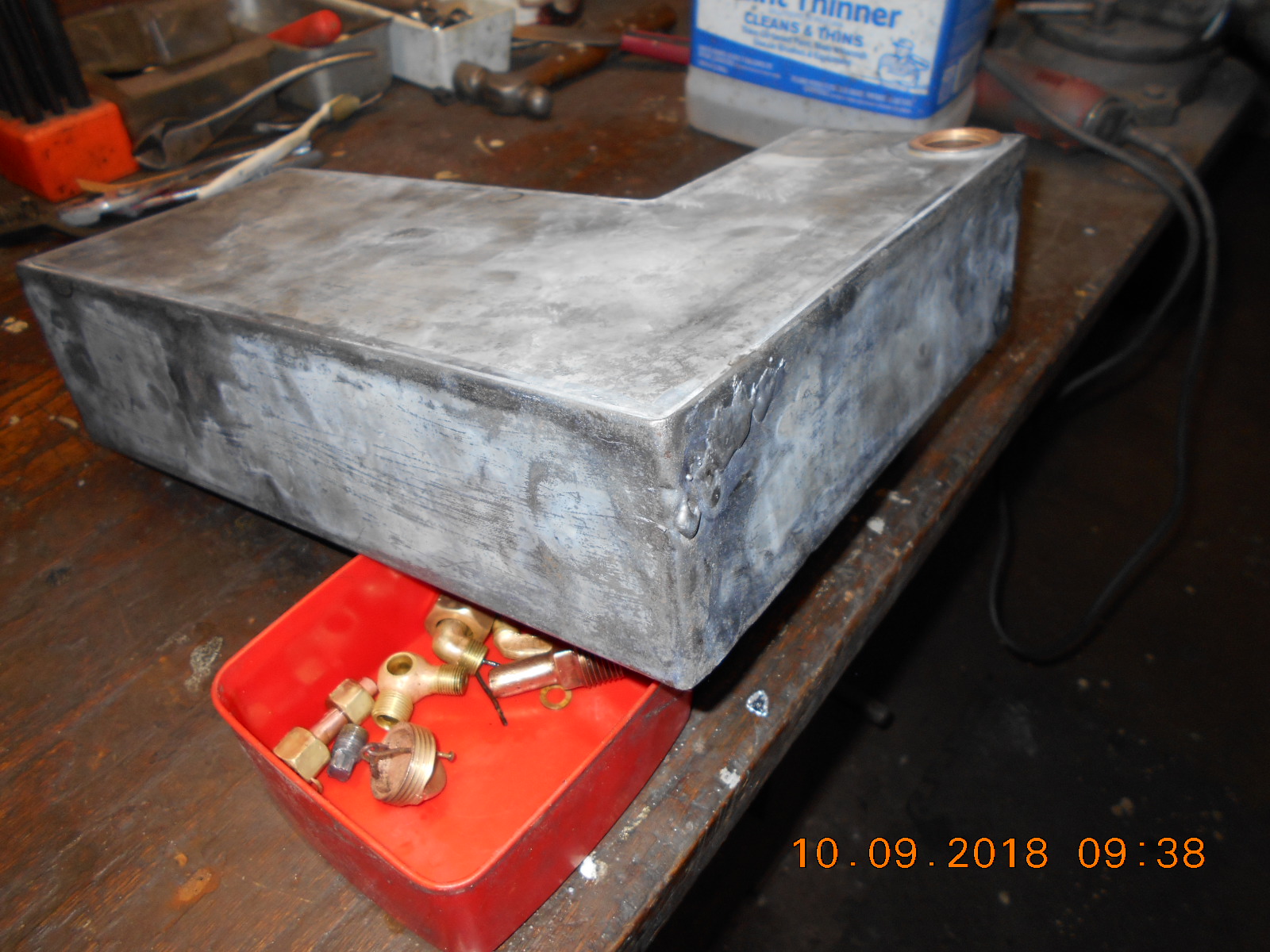

      Started working on the gas tank for the Wisconsion M RBM.
      It "feels" fairly solid overall, but after wire wheeling I could
      see some obvious pin holes. I soldered them up then proceeded
      to de-rust the insides with phosphoric acid. I only let it soak
      for 45 minutes or so, but had to "re-add" the acid half way
      thru that leaked out. 🙁
      From little I can see looking in the little "fill cap", the tank in no
      way close to being clean enough inside to add gas tank sealer.
      Now I’d have about twenty more pin holes to solder up if I want
      to let the acid soak over night. Not sure if I’d forever being chasing
      pin holes, or wind up with nothing left by the time the tank is
      clean enough inside for sealer.
      What would you do???
      – Make, or have made, a new tank?
      -Try to open up the old tank, and clean the insides mechanically?
      -Continue as I am?
      I enjoyed 10th grade metal shop 45 years ago, making little tin boxes, etc.,
      but then I had access to metal shears and brakes.
      Thoughts? Thanks!
