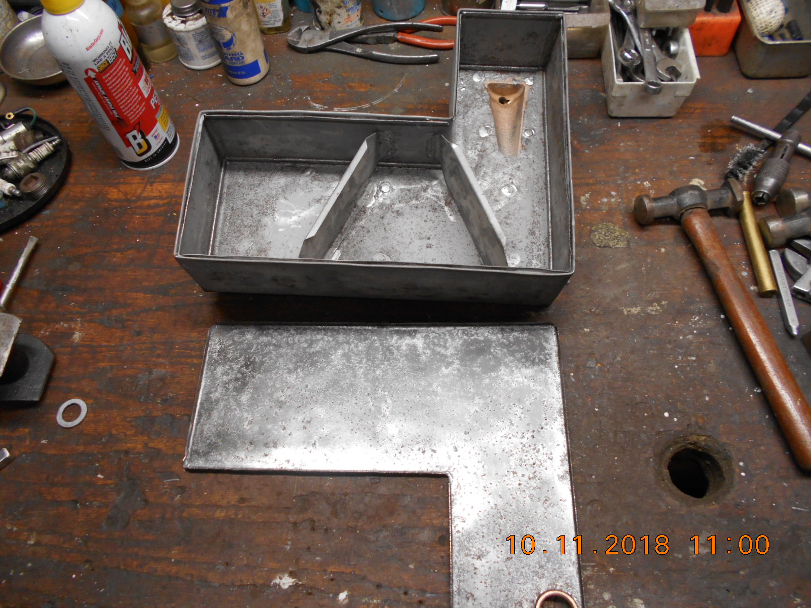

      No soda blaster, but I can definitely reduce pressure and hold
      the gun further away from the work. I think my supply air
      to the gun is set at about 90 psi now, any higher the compressor
      lags behind, but it will blow sand at a lot less pressure.

          Looks like you got it apart without distorting anything – good job!
          #84281
            Yes, good job getting it apart with no apparent warpage of the metal. Hopefully, you can get the rust cleaned up and salvage the thing. Like Chris suggested, would be good if you had access to a soda blaster or some fine glass bead.

              Nice job of taking it apart!
              I was just wondering, since the problem is mainly rust, would this be a good candidate for the electrolysis rust removal?
              #84315
                quote outbdnut2:
                Not sure if a person would end up with a worse case of "Swiss cheese" using electrolysis
                vs. sandblasting or not. I sandblasted the inside of the tank today then scrubbed
                it the best I could with little wire brushes and more phosphoric acid.
                The inside of the cover I didn’t sandblast, as I thought that would be the most
                likely to "warp", but rather used a drill with wire wheel and
                acid. Hopefully tomorrow I’ll finish up any body work on it, then solder the lid
                back on the tank. Guess I’ll just tape all the pin holes and seal it with Red Coat
                when it arrives. Hopefully the Red Coat doesn’t cause problems with the paint lifting
                off the pin holes.

                    Sure looks a lot better than when you started! With the Redkote sealer, I think you’ll have a good tank.

                      quote Buccaneer:
                      quote outbdnut2:
                      Not sure if a person would end up with a worse case of “Swiss cheese” using electrolysis
                      likely to “warp”, but rather used a drill with wire wheel and
                      off the pin holes.
                      tape the inside
                      couple coats of primer on the outside
                      then seal inside
                      #84324
                      lyks2tinkr
                        Solder the tank together. Slosh with MEK or Acetone to make sure it’s clean and then line the tank.
                        If you prime 1st then clean you stand a good chance of acetone getting on the primer and messing it up. I have experience in the above 🙂
