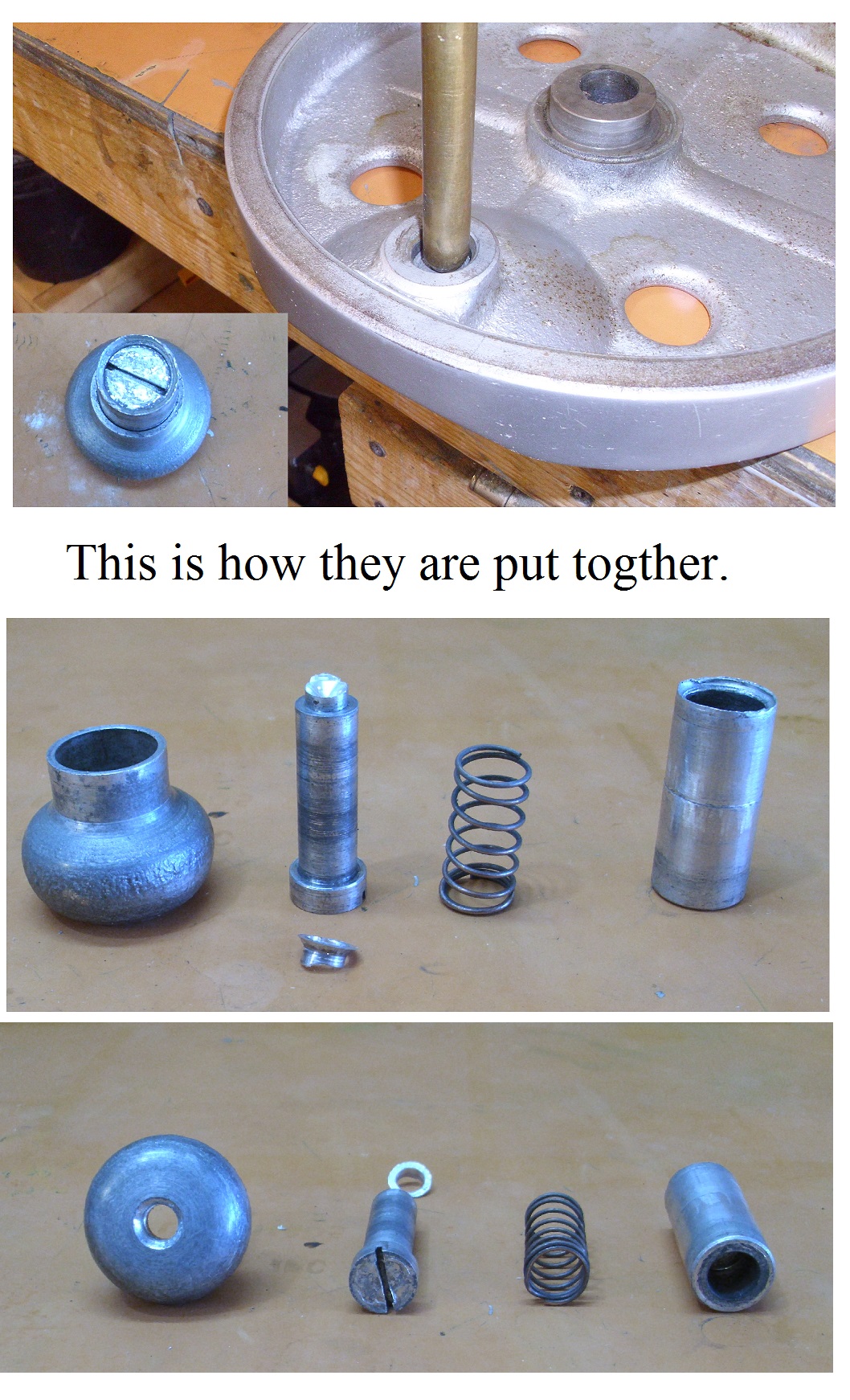

              The starter knob is driven out from the bottom, ensure the driver is smaller than then screw. Flip the flywheel upside down leaving clearance for it to be driven down. When installing push the knob in from the top and use a ball peen hammer to "flare" the flange out to hold the know in place.
              #63727
                Here is a picture showing what Richard
                has described as to getting them out.
                The bottom pictures show what is inside
                and how they were put together.

                    That is not how I expected the starter knob to be removed. Ian knocked it out tonight. Someone must have removed it once before as it came out with little effort.

                      Tubs picture shows what happens when you logically think that it would unscrew… like I did the first time…lol Then I believe it was Chris Scratch that advised me on the proper way to remove them.
                      #63760
                        I learned how to get them out from Richard. I think
                        everybody who wanted to take one out first tried to
                        unscrew it. That’s what I did. The slot would seem
                        to indicate that is how it was assembled. This part
                        may have been designed on April first. 🙄
