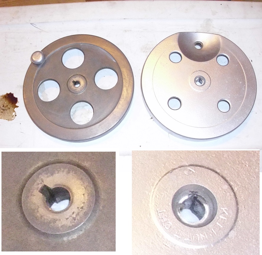

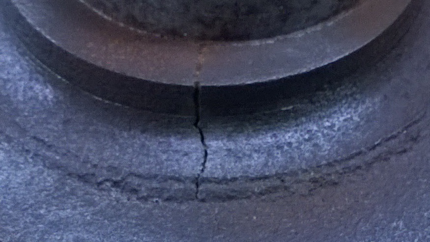

        As Wayne said someone has had the knob out before on this flywheel. After cleaning I noticed that there are cracks. Fortunately this is from the incomplete parts motor. The other one has not been touched. I’m trying to salvage everything from the parts motor before I touch the model "c"
        #63777
        chris-p
          Ah shoot, dreaded cracked flywheel.
          I think I tried to unscrew mine for the first time for about half hour before I gave up !

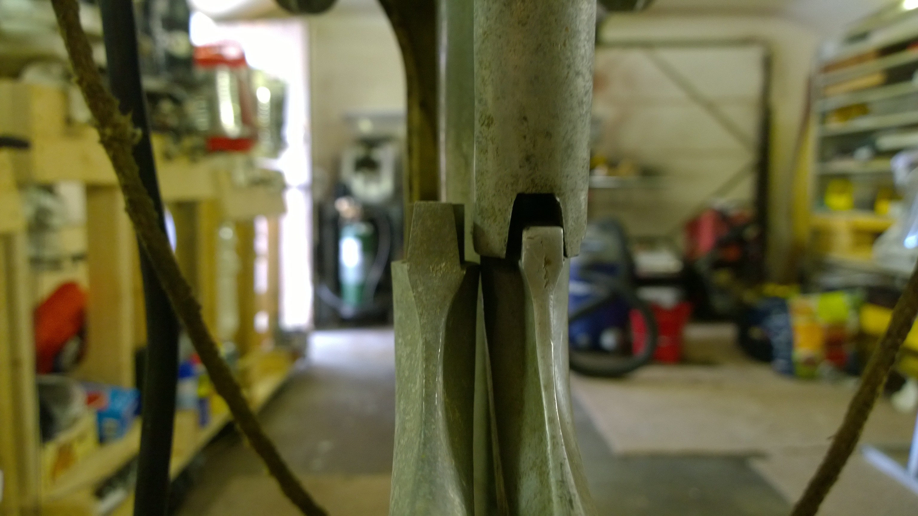

                I am wondering what year the rudder and steering bracket. The fitment of the taper is different.

                  I’m finding that the small hole flywheels
                  are the ones that are often cracked.
                  Their is a taper on the nut as well as the
                  crankshaft and even though it says
                  "Keep Nut Tight" it would seem if you
                  overdo it they can crack.

                    Didn’t know that there is different size taper fit. It’s interesting that they switched to that safety flywheel… I’m not sure how many knuckles that saved. 😉
