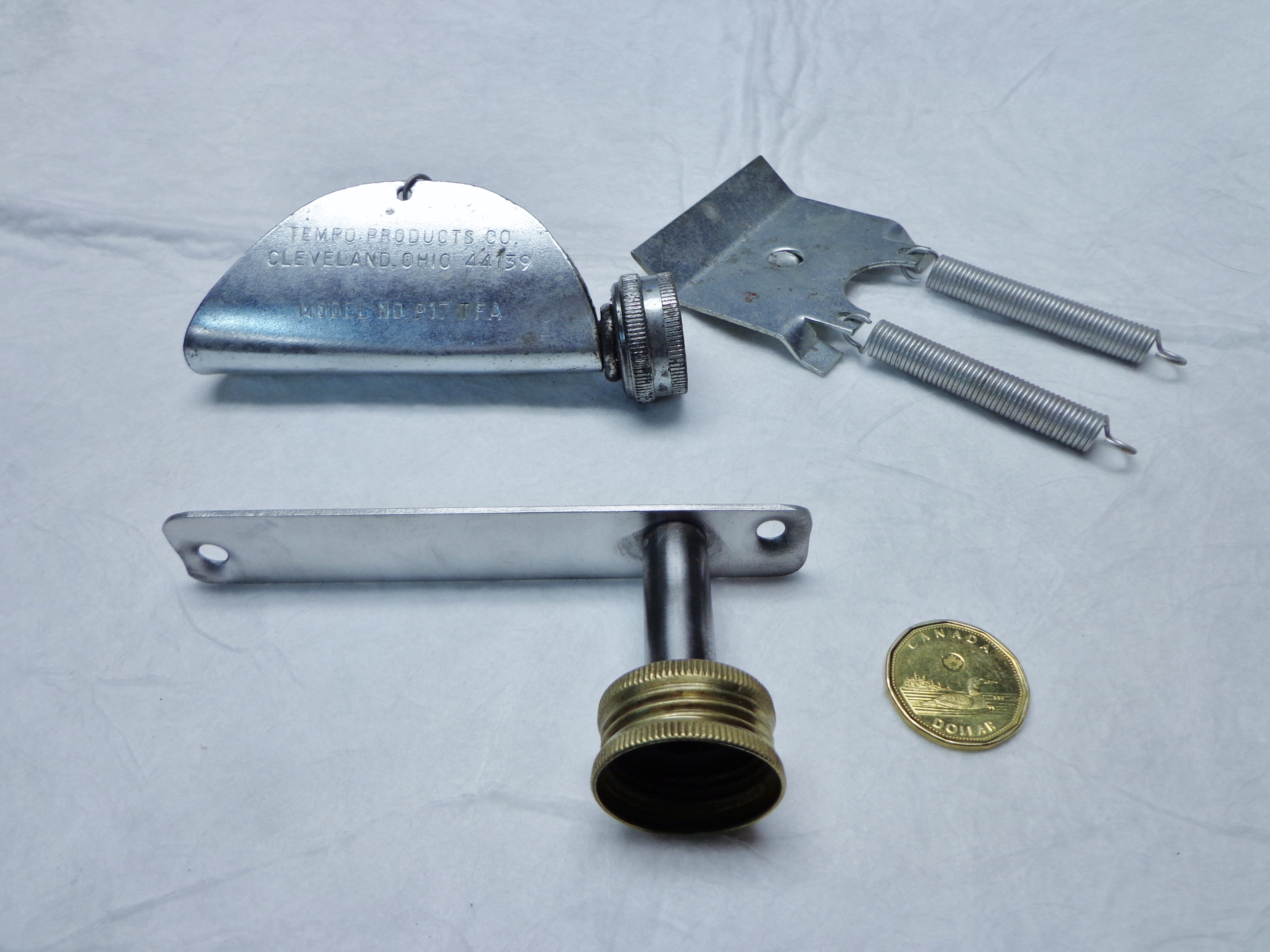

        These Tempo flushing units can also be used to run a motor while it’s sitting on a stand.

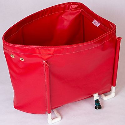

        #72958
        bob-d
          Thanks everyone for the feedback. I guess it can’t hurt to remove two screws for a bit more water capacity.
          Thought everyone would like to see the latest in motor flushing. $250 on EBay!!

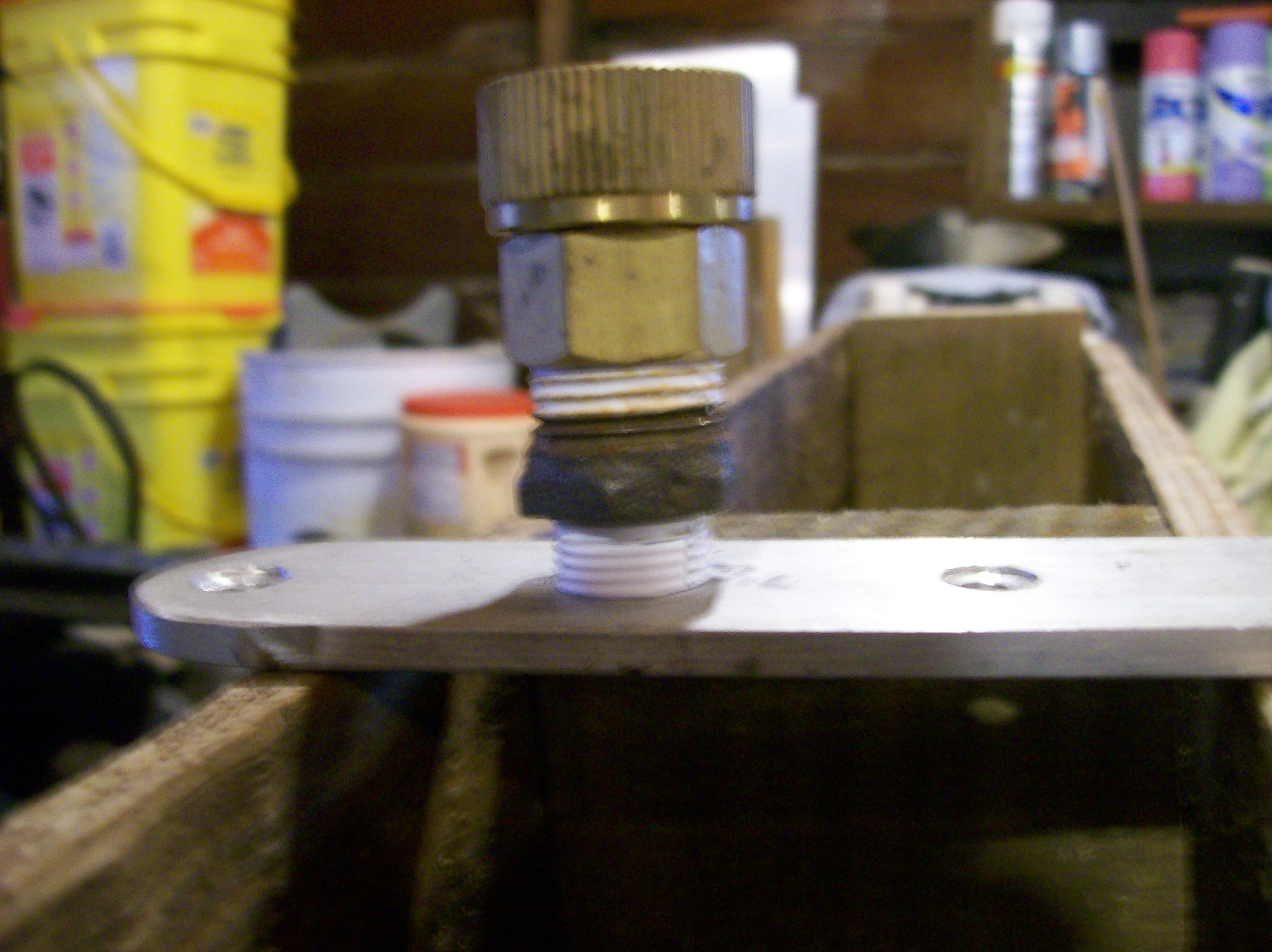

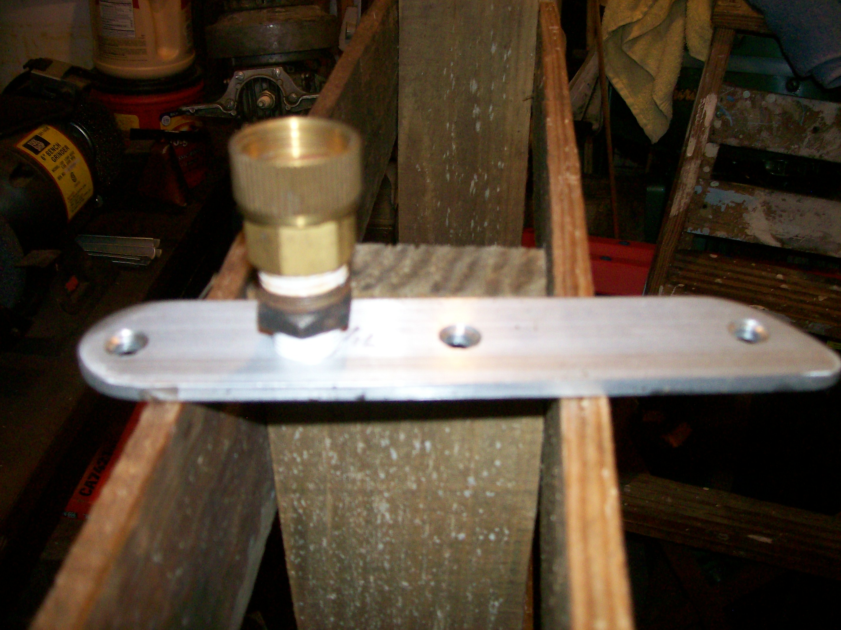

            #72963
            kerry
              If you look at Mumbles pic above, mine look like the bottom flusher, but I used scrap 3/16" aluminum and a fitting like this, with a reducer and short pipe nipple. https://www.grainger.com/category/garde … kiZ1yzinke
              #72965
              bob-d
                Thanks Kerry, I now have the general idea, and should be able to piece something together.

                      #73030
                      outbdnut2
                        I like these flushers and will make a couple of them, but – we must remember that running with a flusher attached will not let us know if the impeller is good since we are pressure feeding water in.
