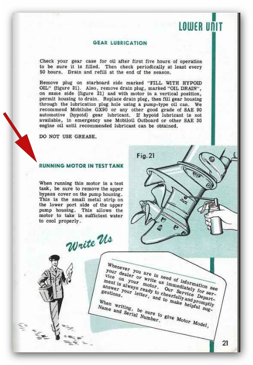

      Just looking at an owners manual for a 55 Evinrude 15HP, and noticed the factory recommendation to remove the upper bypass cover when running in a tank.
      Ive never done that, and my motors have never overheated.
      Am I late coming to the party on this one? Should it be done, or is just for this particular motor?

        I’ve never done it either, and have run many thousands of motors in a test tank, with a test prop. But I suppose those are the key words, adequate test tank and test prop. Anything else, probably can’t hurt to remove it.

          I’ve had it bite me a couple times with 5 1/2’s & 7 1/2 OMC motors….but I admit, in a plastic trash can with conventional prop.

            Maybe if you take off the cover, you don’t need to have it as deep in the water?? I’ve never had a problem with the cover on.

              Learn something new everyday.I ran my 5.5 and 7.5 already in a small tank with no problems. I usually check the water coming out to see if its hot. If its running hot the water should be hot also.

                I’m sure I have run many fewer engines in a tank (55 gallon plastic barrel in my case) than many on this forum, but I have run a bunch of them. I have never had to remove that cover. I did have a motor with a solid cover over the bypass. I never tried running that solid cover plate in the tank. I never had a problem with overheating with the ones I have run assuming the pump is working properly.

                  Never heard that before either. Need to make sure the water is above the level of the pump.

                    Never pulled the bypass cover but I have seen motors go into an overheat in a 55 gallon barrel. Its because the water gets so churned up with exhaust bubbles that the water is thinned out and effects the volume. This has happened if I was running them with a regular prop at 1/2-3/4 throttle in the little 55 gallon drum.
                    I switched to a 275 gallon tote with test props and its like night and day. You can run WOT with a pedestal fan for ventilation and calibrate small motors fairly close to where they should be on the boat but in the test tank. Strongly recommended if you have 12 square feet you can spare!

                      Finally, somebody on this forum has seen OMCs overheat in a barrel, when there is really no problem with the motor!!! Thank you! I have said this many times and have been met with only chipping crickets. ESPECIALLY the Big Twins and RDs. They will usually over heat in a barrel, even in neutral, just from their own exhaust gas bubbles. I wish I had thought to try taking off the bypass cover. Very intriguing idea. (Although in salt water, I would have risked snapping off the screws….)

                        The only bigger OMC (over 10hp) I have is 18hp, a little big for barrel cruising. I removed the bypass cover and used it for a template to make one out of aluminum, drilled and tapped for a garden hose adapter, and now I can at least see if it will run before lake testing. If I could find a way to quiet the exhaust, I’d make them for all of my OMC’s.
