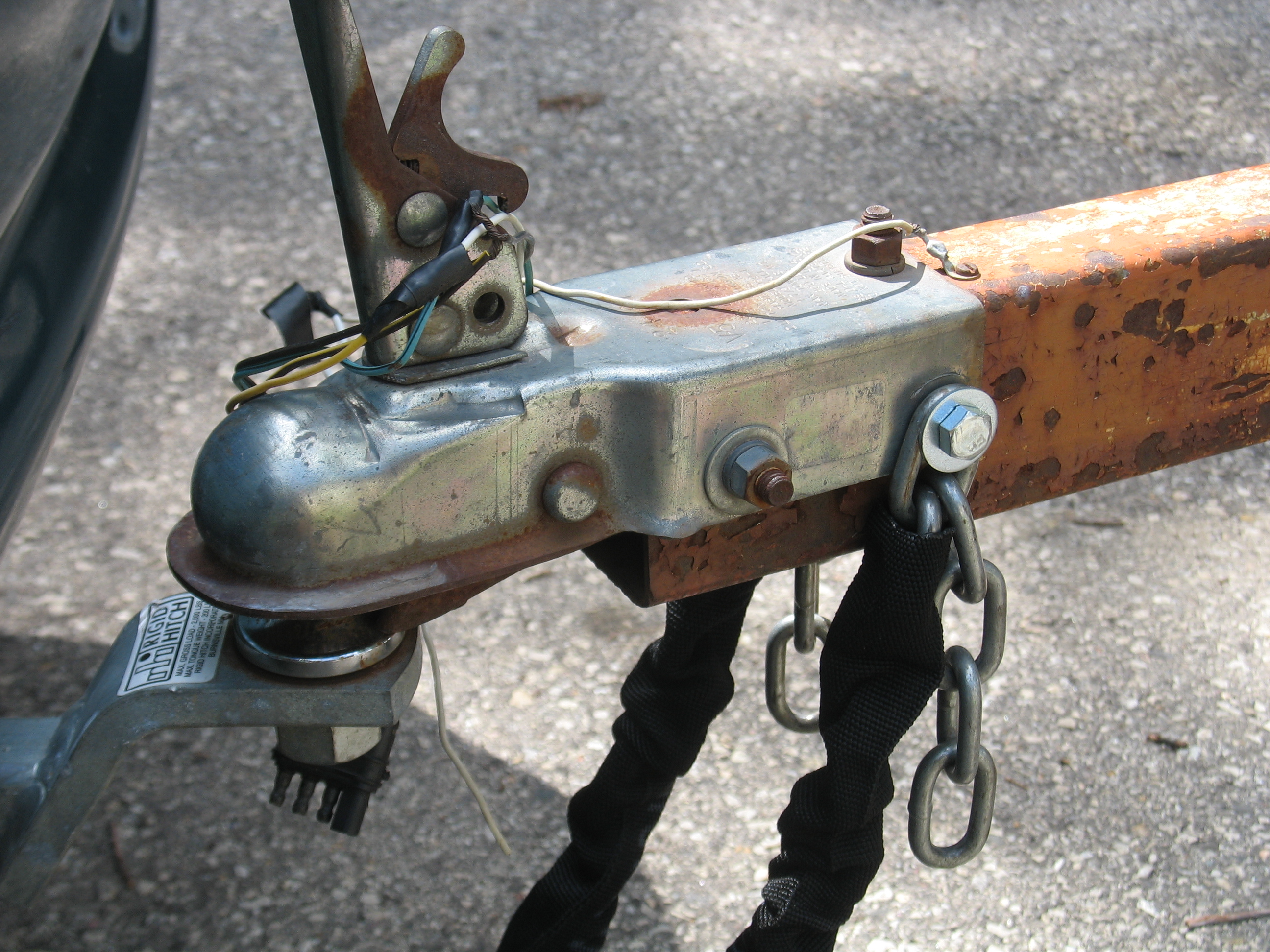

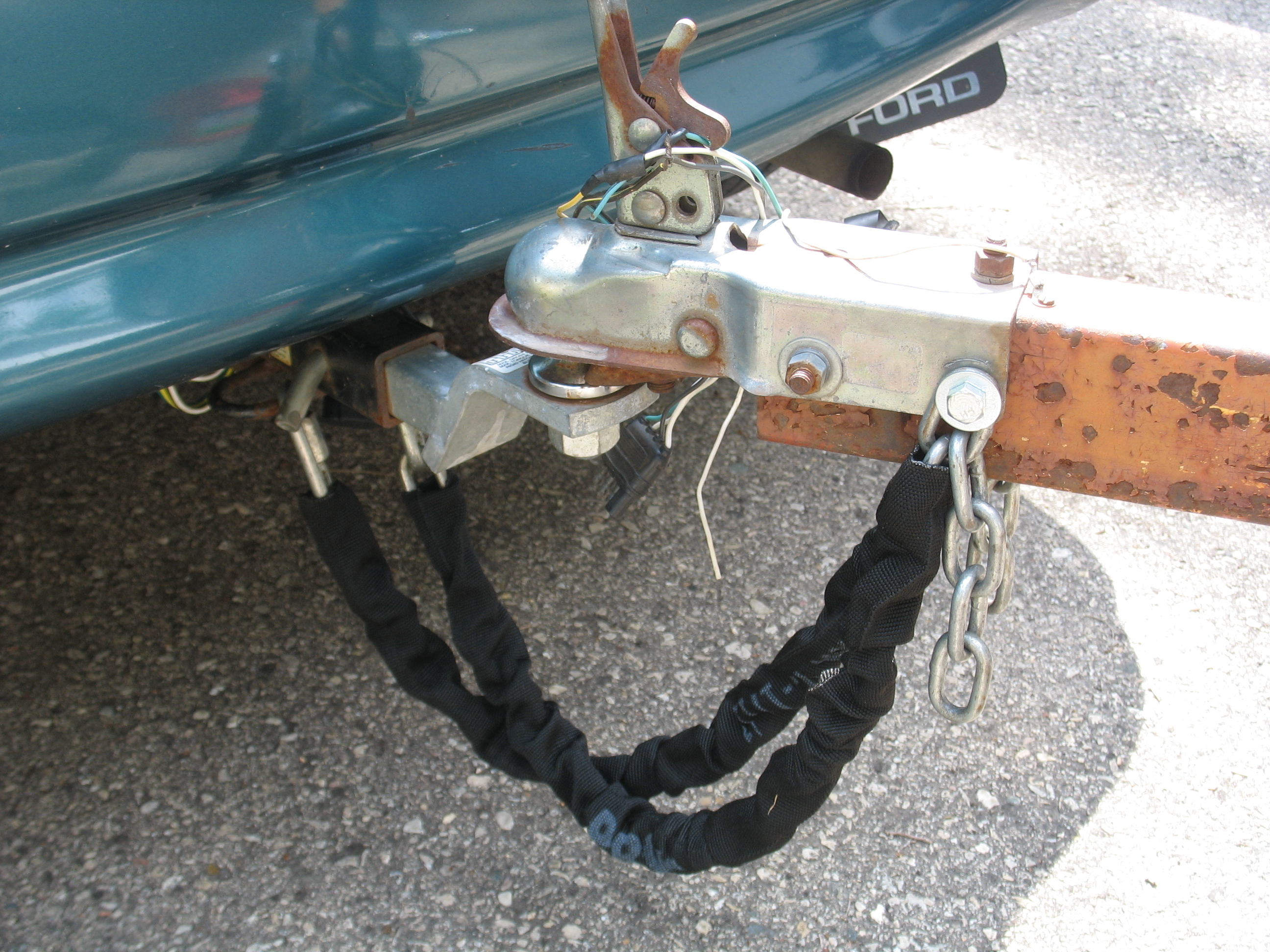

August 1, 2016 at 4:05 am #41388August 1, 2016 at 4:08 am #41389Don’t forget to close the latch and but a bolt or lock through it ! 😉 What is that tube covering the chain ? doesn’t look like the old inner tube ❓

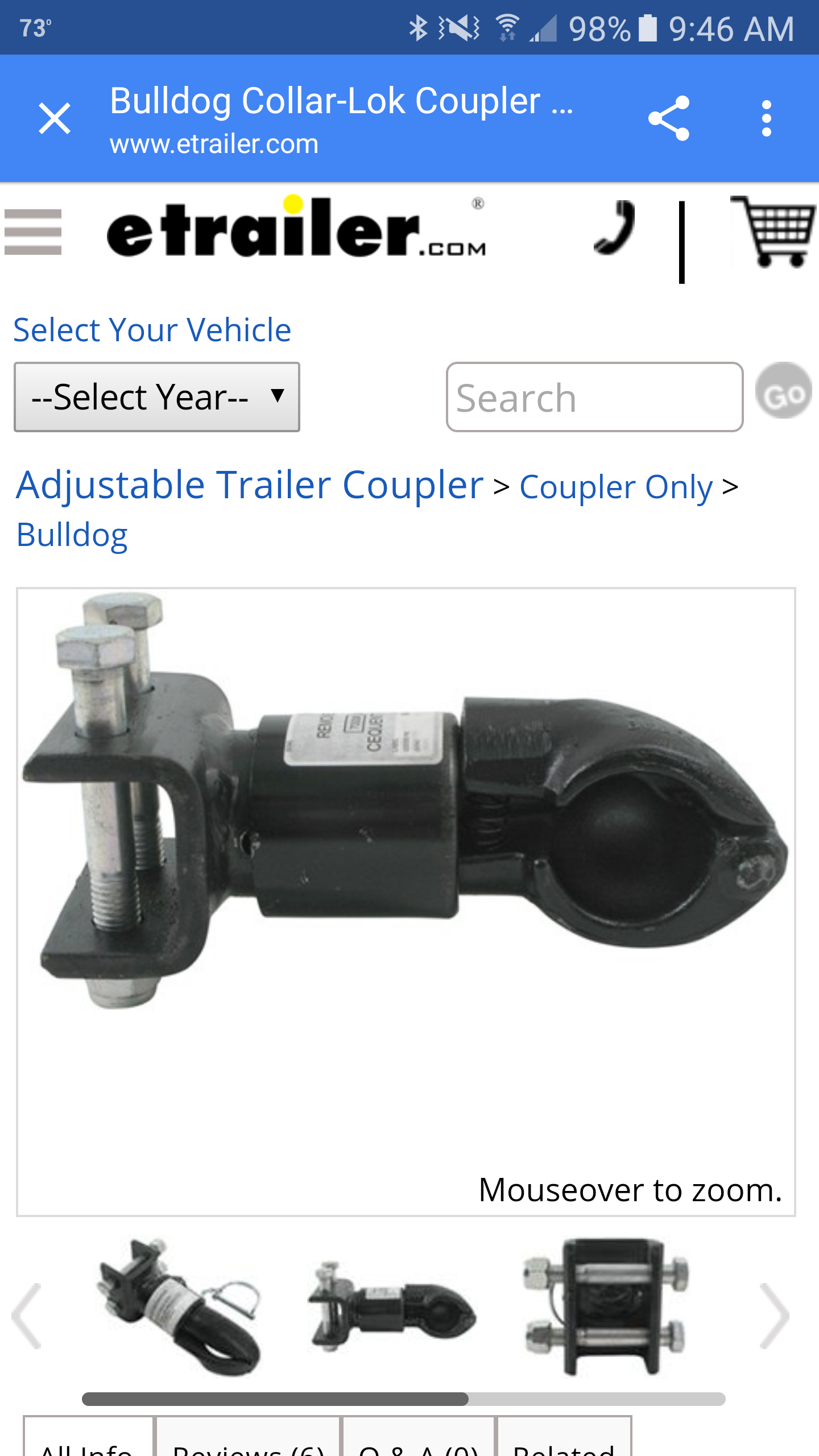

August 1, 2016 at 4:01 pm #41411OK, I understand now. I’ve seen those somewhere before. Is it because of having live / valuable animals aboard?
August 1, 2016 at 5:40 pm #41417I really don’t know the reason for that type of coupler on horse and livestock trailers but I bet you got it right, Frank. It is very strong. They may actually be forged as opposed to cast. The heavy duty ones have some very high weight ratings. It’s a good design, very durable and it seems easier to know it’s properly connected that the type commonly used on boat and utility trailers. My mom used to have horses so that’s where my familiarity with them comes from.
