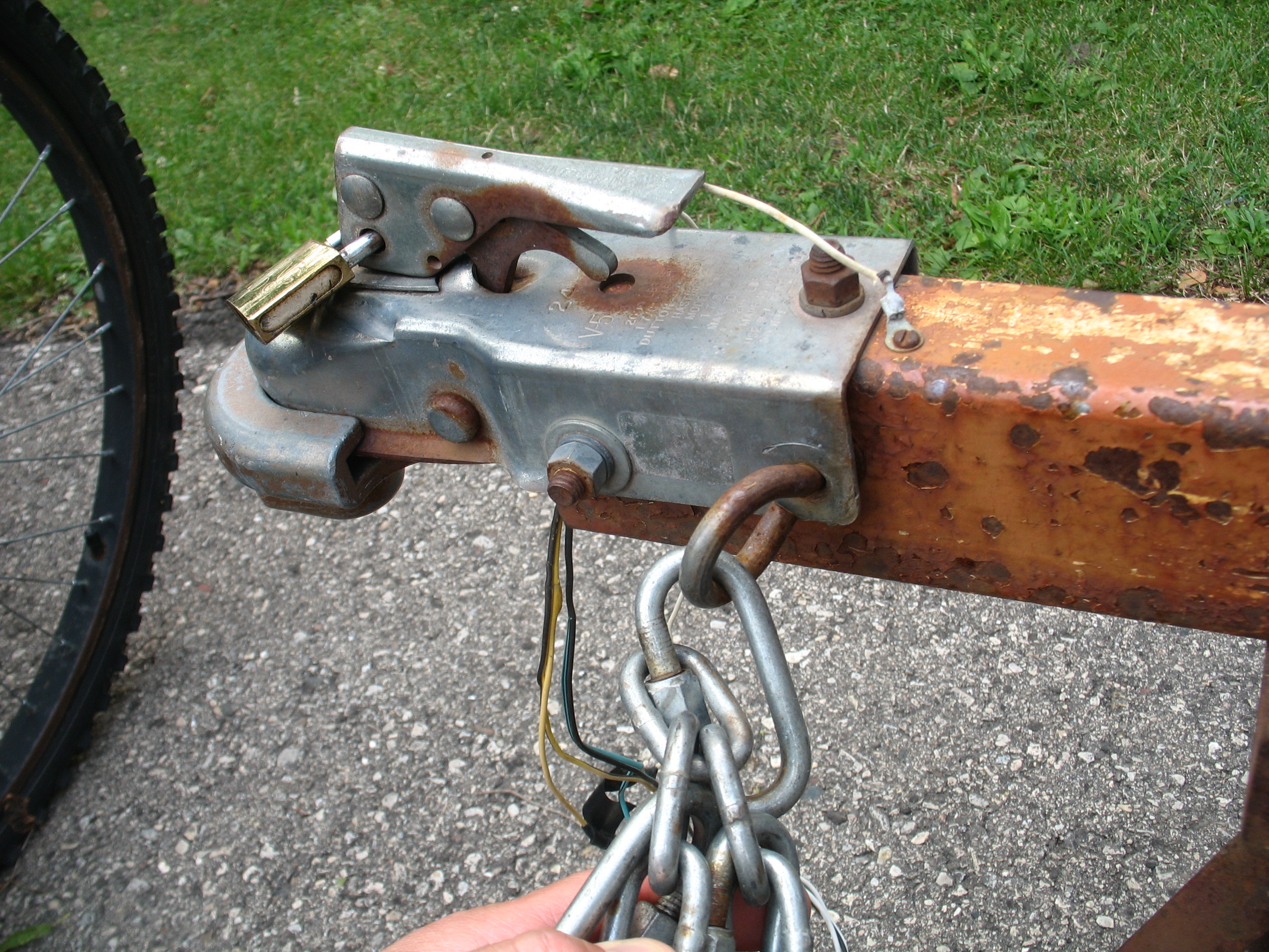

I have always intended to put in place solid, semi-permanent safety chains on my trailer tongues but have always been in a hurry to get out in the spring. Then, I only think about them when hooking up my boat to the car and then I forget again while boating. I have long been skeptical that my current "system" installed by a PO was adequate and safe. It’s simply a thru eye bolt that goes through the tongue (see pic).
What is a safe mounting method? Seems like there are lots of jury rigged systems out there that I believe would fail if tested seriously. How are your chains mounted to your trailer? Let’s see pictures!
Thanks for any input!
July 22, 2016 at 10:32 pm #40710that is not safe. drill a hole and bolt it at least 3/8in and replace the screw eye with a bolt. my opinion.

I once actually saw a mechanism come apart on a loaded boat trailer, being towed by an SUV, going over a rail road crossing. The front end of the trailer dropped, and the towbar struck the side of one of the rails! The abrupt stop shot the boat forward, over the front of the trailer, bent the winch bar that holds the winch that loads, and locks the boat, snapped the safety cable, and sent the boat into the back window and door, of the SUV! doing considerable damage to: 1) the SUV! 2) the trailer! and 3) the boat……. This accident would NOT have happened, if the safety chains were crossed because the towing frame of the boat trailer would have dropped into the cradle.July 22, 2016 at 10:54 pm #40714July 22, 2016 at 11:05 pm #40715quote opposedtwin:I have always intended to put in place solid, semi-permanent safety chains on my trailer tongues but have always been in a hurry to get out in the spring. Then, I only think about them when hooking up my boat to the car and then I forget again while boating. I have long been skeptical that my current “system” installed by a PO was adequate and safe. It’s simply a thru eye bolt that goes through the tongue (see pic).What is a safe mounting method? Seems like there are lots of jury rigged systems out there that I believe would fail if tested seriously. How are your chains mounted to your trailer? Let’s see pictures!
That style of eyebolt is not rated for angular loading, so it definitely isn’t right.
Currently I have a 1/2" bolt through the tongue, and a couple of links of chain on either side of the bolt, then I just run a (I think) 36" safety chain with safety hooks on the end through the hitch and put a lock on the inside of it so it can’t come through the hitch, I hook the chain’s hooks to the chain bolted onto the chain.It’s a little backwards, but I like it better as the chain can’t bind if you go too far one way, and I didn’t have to modify the safety chain to get it to fit onto the tongue.
